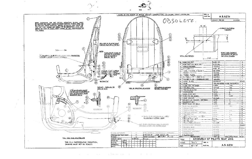

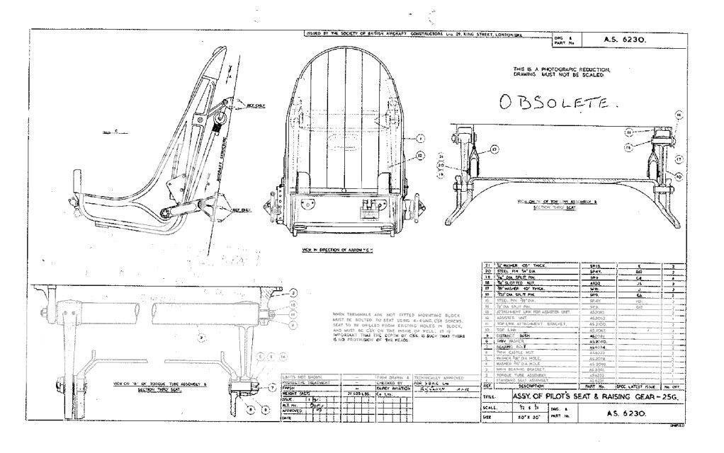

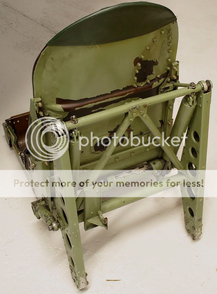

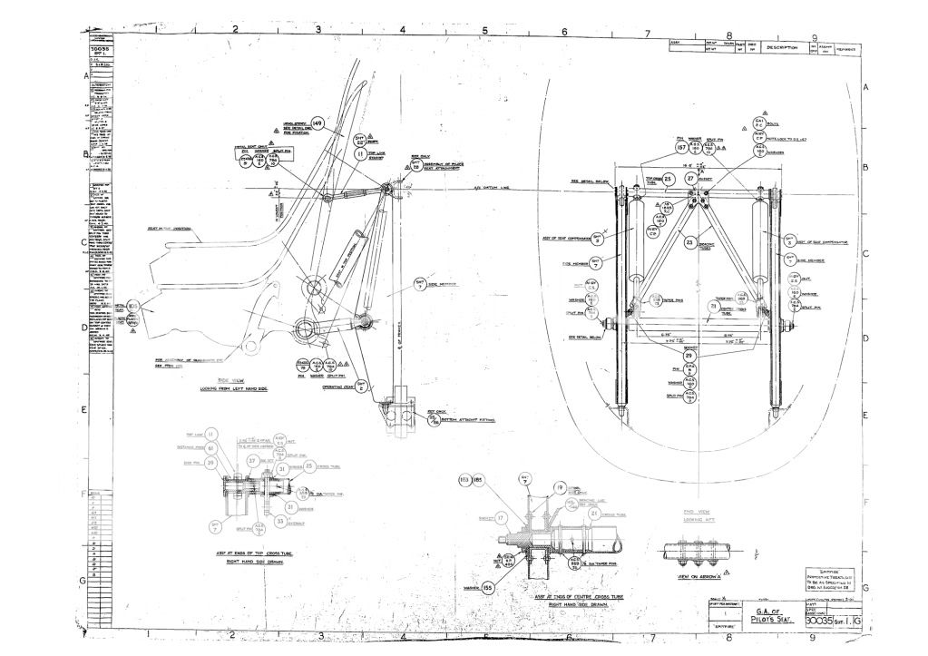

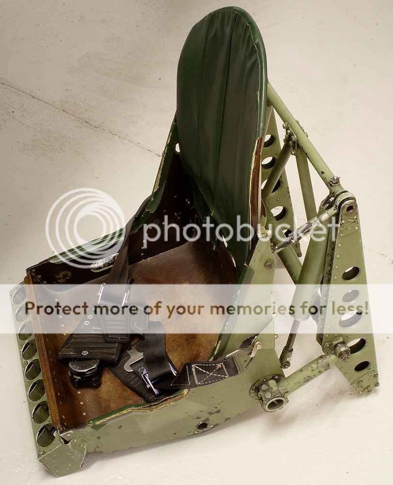

http://i536.photobucket.com/albums/ff321/taylortony/Aviation/X1XSEAT2.jpg
http://i536.photobucket.com/albums/ff321/taylortony/Aviation/X1XSEAT3.jpg
http://i536.photobucket.com/albums/ff321/taylortony/Aviation/X1XSEAT1.jpg
http://i536.photobucket.com/albums/ff321/taylortony/Aviation/X1XSEAT4.jpg
http://i536.photobucket.com/albums/ff321/taylortony/Aviation/seat.jpg
http://i536.photobucket.com/albums/ff321/taylortony/Aviation/seat2.jpg
http://i536.photobucket.com/albums/ff321/taylortony/Aviation/seat1.jpg
Hows that for a reply? :p
