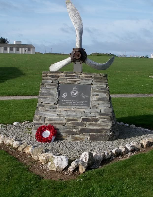

This all took a bit longer than anticipated due to ‘ships in the night’ syndrome, however, it was worth the wait. I had a meeting with the CO of St Mawgan and OC Portreath last night and the issue of these blades were discussed. It came across (generally) that the RAF wants to do more (here away) to preserve historic aviation and be involved at all levels. This includes the Shackleton on the gate (long term) and civilian accessability (denied at the moment) also the rebuild of my Canberra cockpit under a long term loan, to allow (under supervision!) the younger generation getting involved, ie ATC cadets etc.
An aviation trail for Cornwall involving (Air) museums and POIs. to bring Cornwalls history to the fore to visitors and locals alike. There was more but not for this thread.
Andy, your blades have deteriorated quite badly and quickly over the last few years and oxidising as we thought, however, OC Portreath will have it surveyed this morning and when I meet with him tomorrow discuss the way forwards. Interesting to note the CO of St Mawgan said take it down, bring it back to the workshops and restore it here, so it may end up on one of my trailers for transport(!)
It took a bit of time to sort out but I think this is the only way to go.
We discussed ACF50 and application but an engineering officer said they had a directive not to use it anymore (H&S) which means they will have gallons of the stuff laying around:diablo:

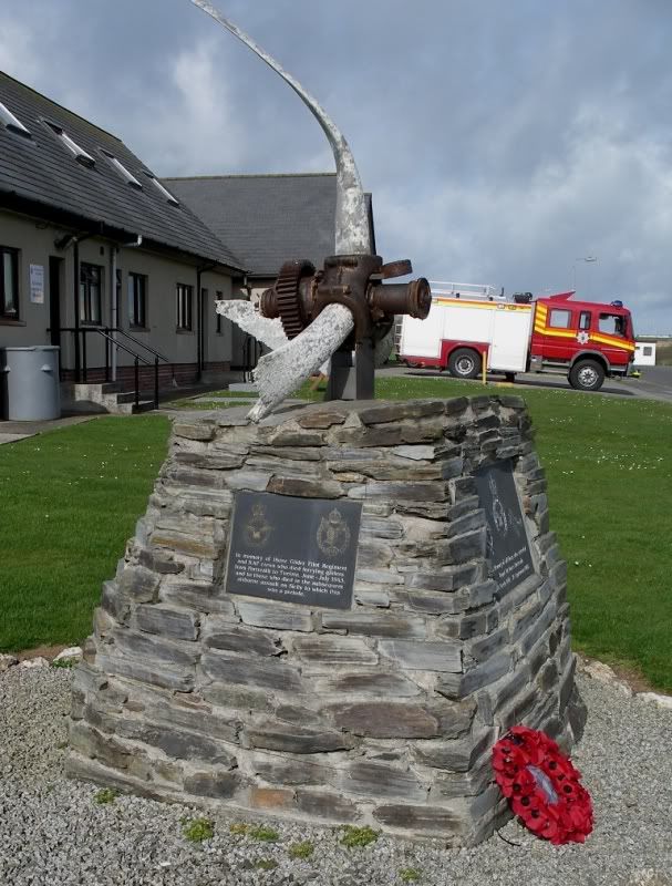

By: Arabella-Cox - 27th September 2010 at 16:54
Did you get the images taken last week andy
Pobjoy
Pobjoy!
Many thanks. I have just retrieved them from my spam box. Don’t know how they ended up there!
Again, many many thanks for your time and trouble. I will reply later.
Pagen01, many thanks also.
Its certainly deteriorated, but looks as if it is a retrievable situation.

By: pagen01 - 27th September 2010 at 16:48
Taken last year, that’s the original squash courts behind in the last shot.

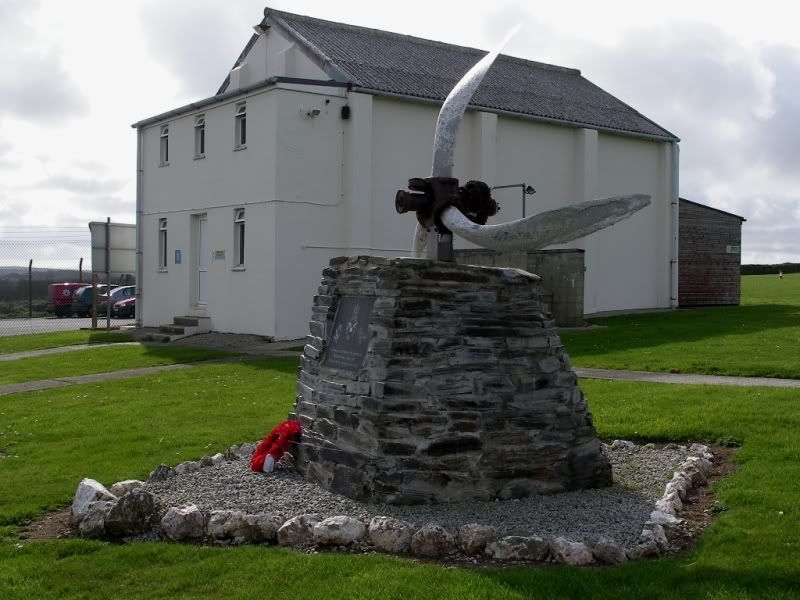

By: Arabella-Cox - 25th September 2010 at 21:28
Oh dear.
I think it safe to say that it has seriously degraded in the intervening years – perhaps unsurprisingly!
Thank you for posting those images. I will have a delve tomorrow in some files to see if I can find it in its original glory.
By: H.M.S Vulture - 25th September 2010 at 21:08
Taken a couple of years ago.

By: pobjoy pete - 23rd September 2010 at 16:32
Salt Corrosion Prop
The corrosion process really gets going when the oxygen gets to it.
Its basically try to revert to its original state. As this goes on “under the skin” it is sometime before it can “explode” into a powder state. Exfoliation and intergranular corrosion is quite common down here with the salt air acting as a catalyst.
Items that have been “rolled or extruded” are particularly affected and the effects quite dramatic.
Anything brought out of the sea should be flushed with fresh water (left in a river or lake ) before anything else is done.
Anyway it can certainly be helped to survive with some relativly simple treatment and an annual check up.
PC
By: Arabella-Cox - 23rd September 2010 at 15:32
I think “rescue” in terms of what our local team can do with it, pegen01 – RAF station permitting, of course!
It was in superb condition and had been recovered from deep mud, albeit in coastal/tidal waters from where it was lost on 15 October 1940 with Tommy Lund baling out. In a sense, it had been subject to salt corosion (or should I say exposure?) for decades, but there was no sign of that upon recovery or for many years since. I think the rot has set in, literally, since being placed there.
