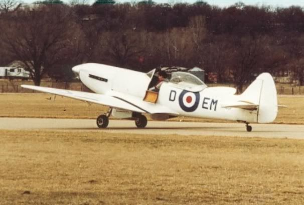

Off the top of my head, I couldn’t recall exactly, other than that the aircraft is sadly no more due to some kind of engine failure.
From further “digging”, I found it was, unfortunately for the means of your project, an all-wooden design based on the Jurca MJ10, built to 75% scale as a low-back MkXIV. The website doesn’t provide any engine details, nor any dual-control capability (not likely, but not impossible, I guess), but definitely a two-seater.
http://img.photobucket.com/albums/v731/spitfirebuilder91/Jurca%20Spitfires/N379SF.jpg
(pic via www.marcel-jurca.com)
