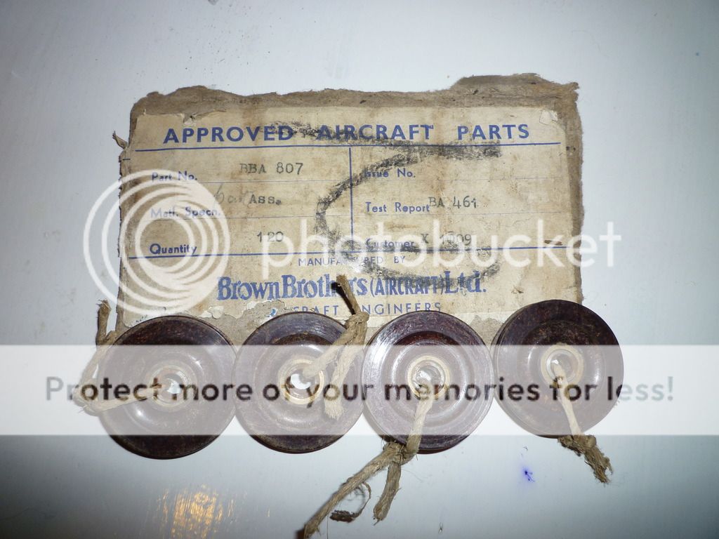

We are slowly putting together a stock of parts for the cockpit coupe and one of the things we have been unable to find are the correct bakerlite or paxolin wheels that we require for the coupe roof pulley blocks . We will also require a number of these for the cable runs in the fuselage. They are not listed in our copy of Browns standard parts.
We have measured the overall diameter of these pictured and they come out as 1.58” . They are all damaged and a little difficult to guage however.
The project would like a hundred but 42 would be good, or even one good example so that we can machine some new ones, Here is a picture of the rearmost pulley block containing the desired wheels. Has anyone got a dusty box of these kicking around the workshop? Best regards Kevin

Cheers for the help, Unfortunatly our only coupe drawing is an early GA. no pulley block detail. We spent some time on the wreckage at the weekend and although they are swollen we all agreed they would have been 1.5” total external and 1.25 where cable seats. the bore of the bearing escapes my memory but it is large ie something like 3/8”. Graham is drawing them up.
We are going to give it another week to try and find some and then if no luck we will have some made. Kev

This Brown Brothers catalogue lists the fibre pulley sizes on page 183, including AS111. The next size up is 2.4″.
That pretty much matches what we’ve got. I suspect that looking at the one you sent, that it’s a pretty close match, confirmation should come on Saturday. It wouldn’t surprise me though if Shorts used there own spec pulleys in places

I don’t have a WW2 era BBros catalogue but I do have a 1942 edition of AP1086 Book 12 which lists standard AGS parts.
Under pullies is listed the AGS666 series (in internet references, these are thrown up as pulleys “for Main and Engine Controls”. In AP1086, they are only listed as 5 cwt, 10/15 cwt. sizes etc, without dimensions but, crucially, they are manufactured out of Duralumin as are, I believe, all earlier standard types.
If yours are moulded plastic, my betting is on the AS111 spec. pulleys, unless Short’s produced a version of their own for some reason.

Has anyone got a Brown brothers catalogue from say 1939, it should show if a 1.58” or thereabouts existed at this time. Our volume is later. Kev

received the Pulley yesterday, for which many thanks :), we’ll offer it up to the originals on Saturday and I’ll let you know how we get on. Out of interest, if they are suitable, how many of these have you got?

Funny thing – I’ve just spent the best part of 6 months learning about Tufnol pulleys trying to figure out the sizes we need for the Horsa (AS104 as it happens).
Pulleys, like pretty much everything else came in stock sizes to a given AGS spec so the fact that you measure yours at 1.58″ I would put down to them distorting. More than likely they were 1.4″ pulleys like Elliot has. The original ref was AS111 which gives a overall diameter of 1.4″, groove diameter of 1.15″ and a bore size of 0.25″
Spec changed to be known as SBAC AS111 and RHP Aerospace in Stonehouse were still making them as CP1.15 until SKF took over. SKF sold all their old stock to Saywell International – give them a call and ask for a price if you’d like a laugh. They wanted £129 per pulley last time I asked and that was NOS with no certification. :stupid:
I believe the aerospace arm of SKF, Sarma, still makes pulleys to the original spec as AS111 as part PV29SP1 but I have no idea what they cost or a source but sometimes you can get lucky on eBay. I looked at some of the US spec pulleys as alternates but they all use different bore sizes and even those come in at around £20 each + shipping from the US.
Best bet – if you can’t source originals – I found a company that turns Tufnol using a CNC lathes and said they could easily make new ones from my CAD models for about £10 each. They won’t have roller bearings and you’d need to hammer in your own brass sleeve inserts instead but for a Static cockpit their more than suitable.
