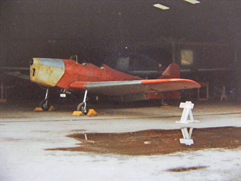

By: David Burke - 12th May 2015 at 21:18
She wasn’t totally rebuilt in Strathallen hands . The fuselage and wings were stripped of fabric and a few woodwork repairs done but the ply was not removed from the fuselage. Recovering was done in 1976 and she flew again in June of the same year
