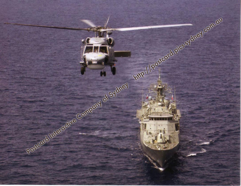

How can that be, since the existing hull panels to which one would have to attach aren’t sloped?
http://postcard.pics-sydney.com.au/images/navy/HMAS-ANZAC-FFH-Frigate.jpg
Looks like they slope in to me? 3 degrees is enough.
I think the upgraded ship looks awesome!

I don’t know how they are doing it, but if they are going to the effort of putting these in , I assume they would be sloped….
987
By: StevoJH - 21st April 2010 at 01:48
Would that matter much, if the smoothed-out superstructure remains vertical rather than angled (just making a larger reflecting surface, though with less scatter)?
3,544
By: Wanshan - 20th April 2010 at 19:11
I read somewhere that they were getting screens fitted to the sides of the superstructure to smooth out the structure and make them more stealthy. From what was said, the models havent had all the latest changes added to them yet.
