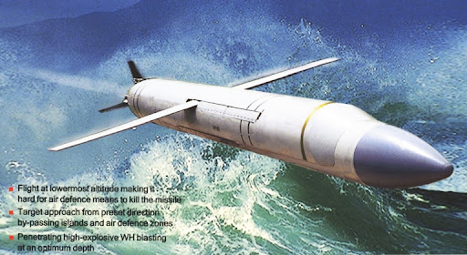

That’s why I envisioned the railgun as a CIWS against lethal supersonic AShMs such as Sunburns, BrahMoses and Sizzlers.
http://lh5.ggpht.com/_cTaLGgz4Ru8/SAWWzO7rRoI/AAAAAAAAFSM/4VVXe6m8FqQ/ssn27-klub-sizzler-3m54.jpg
SS-N-27 Sizzler
http://www.americanrationale.com/sitebuilder/images/Sunburn-Cruise-1S-778x173.jpg
SS-N-22 Sunburn
http://www.3d.sibiul.ro/galerie/ddas_Brahmos.jpg
PJ-10 BrahMos
