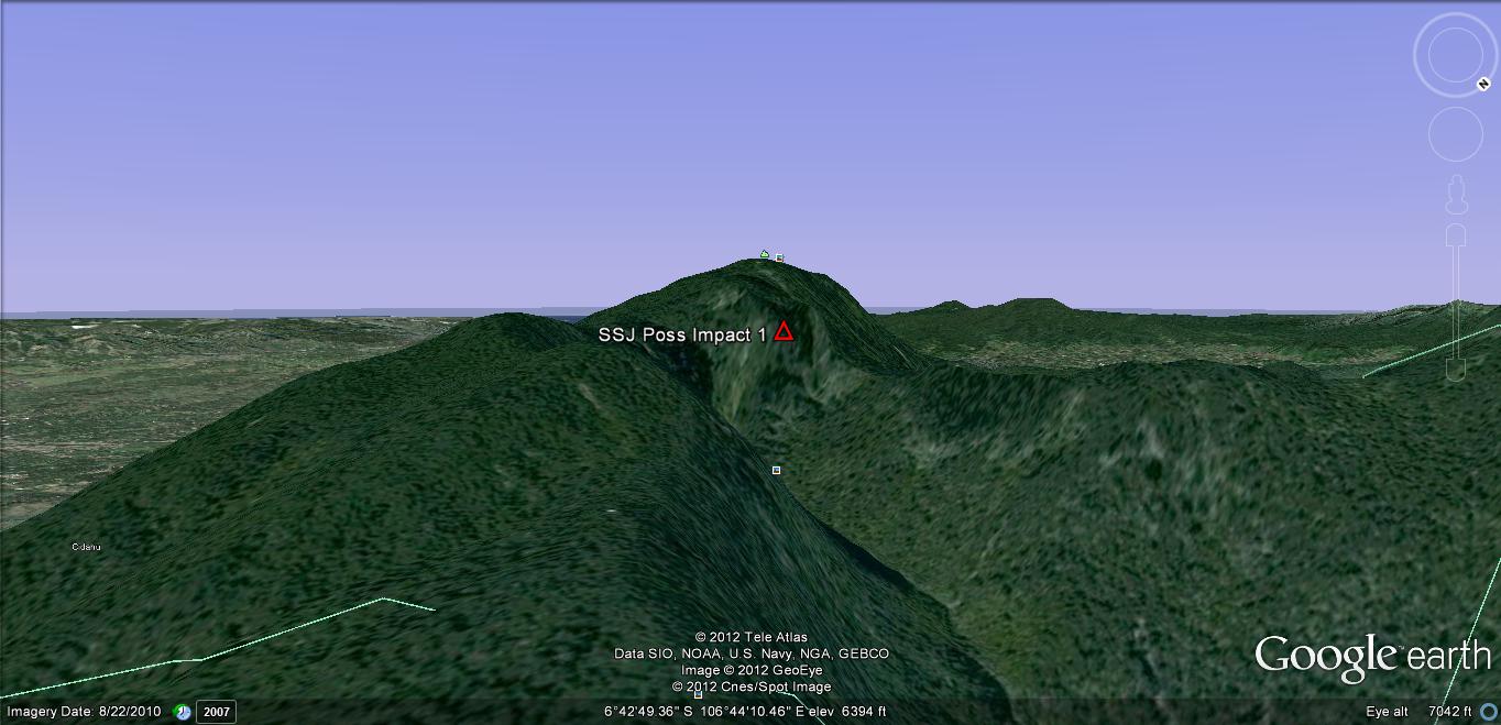

Highlights from SSJ 100 crash site: The worst place in the whole mountain!
Following on from SSJ Descent: Innocent but deadly, I theorized on how the plane could innocently made the descent, and how the ATC could also be blameless for authorizing the descent. That article does not explain how it ended up hitting the mountain. In this article I am showing where it crashed, but not how it ended up there. This accident is already very tragic, but criticism on the pace of the salvage efforts, like many other things in this accident, irks me. Let me add to the tragedy a little bit: the aircraft ended up at possible the worst place in the whole mountain!
Why do I say it is the worst place in the mountain?
It is located near the peak of the mountain.
The terrain wall it hit, is amongst the largest in terms of height from top to bottom, in the whole mountain, and it is one of the steepest.
It is in a narrow confined location.
From the previous article SSJ Descent: Innocent but deadly , I wrote about how the crew might not realize that Mt. Salak was there. However, the explanation in that article, makes it extremely difficult to reconcile with the crash site. The trajectory from that analysis, would yield an impact from the north east or from the east. On the photo of the crash site on the cliff wall, it should show a predominantly left-to-right trajectory, but the photo shows impact characteristics that relatively right-to-left, which means, the aircraft had to come from the north and at relatively high speed (300 knots ground speed is just within “high speed impact” category in my books). BUT… details of the crash site, description of the bodies found, description of “engines relatively intact”, etc, all point to a low to medium speed impact.
Therefore, there HAS to be a different theoretical trajectory for the aircraft that is different from my previous article. It looks like I found it just now… but it’ll take time for me to write it as I need to take time to make sure it looks plausible, and doesn’t break my own ethical boundary for “objective speculation.”

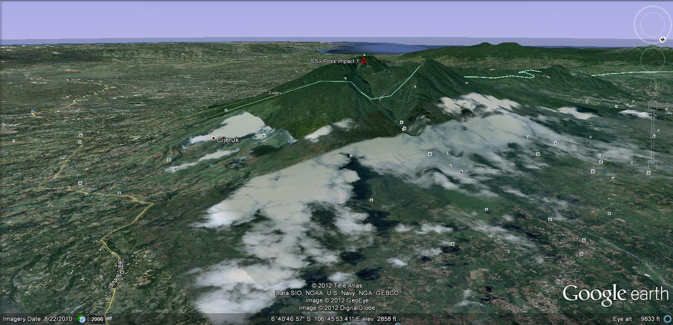

An incoming path from between north and north east, is a lot more likely. There is a lot of space for them to end up hitting the cliff, without too many probable incoming paths.
http://2.bp.blogspot.com/-vrJqC-Emu6c/T7NHFGXwhAI/AAAAAAAAAVE/-fN8nrDRtvI/s1600/97004-GE-Site3.jpg
http://3.bp.blogspot.com/-qqpw1kNDN9c/T7NHCdwKhFI/AAAAAAAAAU8/IrUtkqgSFXU/s1600/97004-GE-Site2.jpg
looking at what could have been near to the actual flight that happened, it is so damn to see that of all the available area, they went right into the ridge. And as I mentioned in earlier in the thread, the aircraft probably descended right onto the mountains.. 🙁
From Gerry’s excellent analysis and illustration we see that the SSJ-100 probably descended from 10,000ft into the ridge (?) or at the mouth of that ridge… and then at an air-speed of around 238kts, the aircraft probably did not last long before it crashed onto the mountain…

Very interesting and accurate analysis, made by Indonesian blogger and Mt. Salak area expert Gerry Soejatman, can be found here:
http://gerryairways.blogspot.it/2012/05/ssj-100-descent-innocent-but-deadly.html
http://gerryairways.blogspot.it/2012/05/ssj-100-crash-site-worst-place-in-whole.html
http://gerryairways.blogspot.it/2012/05/ssj-100-descent-innocent-but-deadly_17.html
I recommend you this reading!
