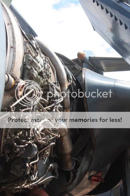

Last weekend The Buccaneer Aviation Group had the opportunity to boroscope all five Rolls-Royce Speys (two in XW544, two in XX894 and one spare). A Huge thanks to Chris Collins for performing this. Unfortunately this has revealed heat damage to both of XX894’s engines and they must either be replaced, or stripped and the damaged parts replaced.

One of the troublesome engines;
