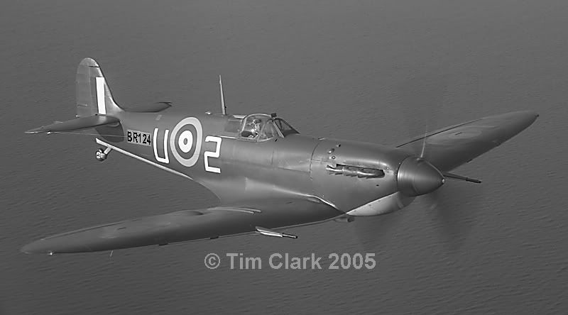

These past couple of weeks we’ve been treated to some lovely shots of the replica of U-2, the blue Spitfire.
I have had a look around and however cannot find anything about the real U-2. Only the photo Mark12 posted of it below decks on he USS Wasp.
I was wondering, what was the history of the original? Was it new when it arrived in Malta? Or already a battle veteran? What was the full serial? The photo has the last number obscured, showing BR12.
Also, who flew it from the carrier to Malta? Where was it based there? Luqa? And what subsequently happened to the plane? How much combat did it see, and with whom onboard?
Had any of the veterans at the airshow flown the real thing?
And what other unusual markings did it’s fellow Spitfires get? Did they all have U codes? And I assume they were all that colour?
Any history would be interesting.
Cheers
Dave

I think you need better anti-aliasing on your serial number…

Would that be this one? 🙂
http://img.photobucket.com/albums/v724/Merlin70/Malta%202005/BR124U2.jpg

U-2 can be ‘Dark Mediterranean Blue’
BR124
Mark
