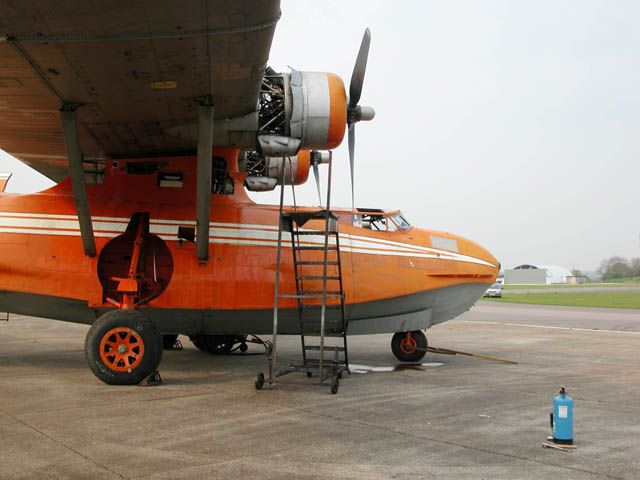

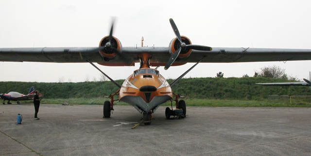

It’s now outside again. They were running the engines yesterday. As they hadn’t been started for a very long time, problems were anticipated.
The starboard engine fired up OK, but then hydraulic fluid started pouring out to create a big puddle on the apron. A quick bit of packing around the cooler sorted that one out, and the engine was run up successfully and the prop feathering checked after shut down.
The port engine proved to be more recalcitrant. It started OK as well, but was quickly shut down because no oil pressure was showing. An air lock was suspected, and more oil put in.
It was started a second time, with the same results. They started bleeding the system, then called it a day. Work resumes again this morning.
The Catalina is due to fly out on Saturday, and arrive in Israel on Monday, where it is going to a museum (the plan is to keep it in flying condition).

Topping up the hydraulic fluid

The puddle!

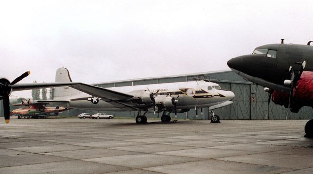

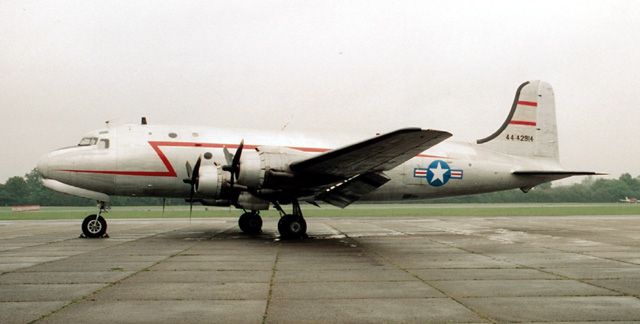

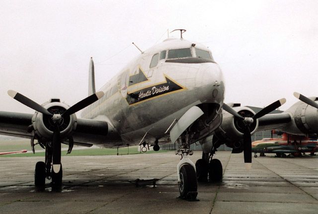

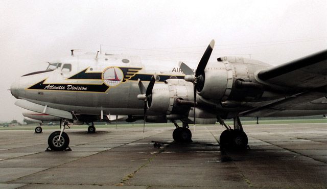

Some pics of the C54s just after they arrived. They haven’t moved since. The only difference today is that they have baffles in front of the engines.

The C54s and a Dak that was on maintenance at the time.
http://img54.photobucket.com/albums/v165/YakRider/MATS_C54_Side.jpg
A couple of the MATS C54…
http://img54.photobucket.com/albums/v165/YakRider/MATS_C54_Close_Side.jpg
http://img54.photobucket.com/albums/v165/YakRider/MATS_C54_Front.jpg
And the silver C54
http://img54.photobucket.com/albums/v165/YakRider/Silver_C54_Side.jpg

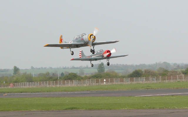

A formation take off
http://img54.photobucket.com/albums/v165/YakRider/Yak_Take_Off1.jpg
