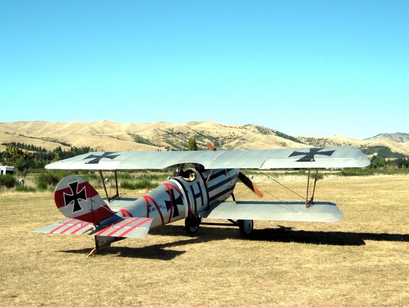

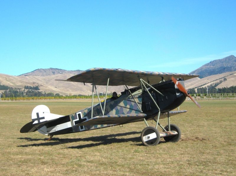

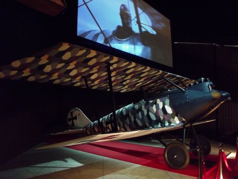

By: nuuumannn - 16th January 2013 at 03:16
As you and I know the IAC was heavily involved in these films such as Blue Max etc.
That I wasn’t aware of, but the Blue Max German aircraft were reproductions, not originals, although making the movie there might explain how the prop got there.
ex Blue Max D VII and Pfalz D IIIs
http://i1093.photobucket.com/albums/i423/nuuumannn/Omaka/BlueMaxDVII.jpg
http://i1093.photobucket.com/albums/i423/nuuumannn/Omaka/BlueMaxDIII.jpg
http://i1093.photobucket.com/albums/i423/nuuumannn/Omaka%20AHC/PfalzDIII.jpg
Note the screen above the aircraft showing George Peppard in the cockpit flying the very same aircraft; he did some of the flying sequences in the Pfalz.
