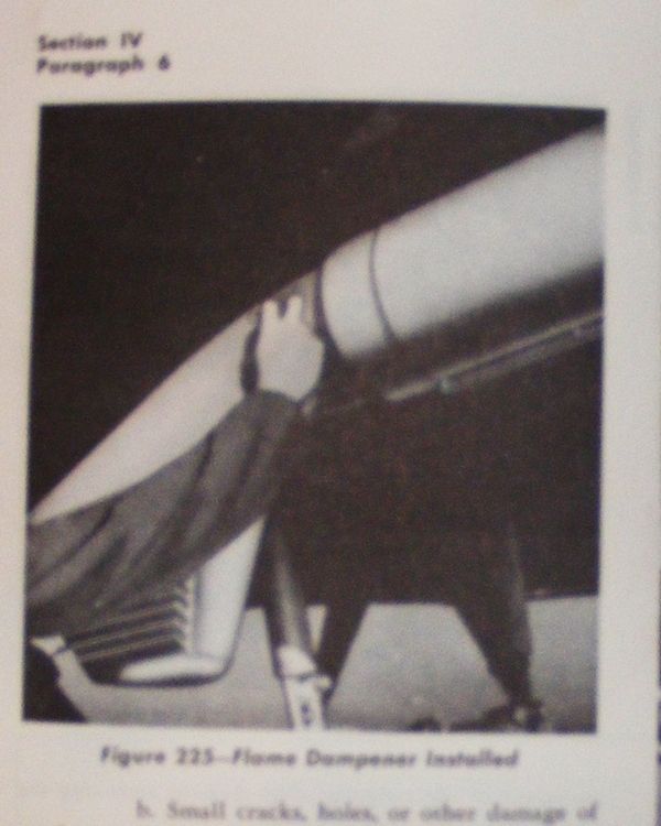

By: Flying_Pencil - 20th June 2015 at 05:07
Manual is not numbered but dated 1944 with 1948 revisions. Here is the small, simple illustration of dampener in it. Sorry for poor quality – it’s a pretty weighty book to control for scanning/photographing!
Edit – looked at video again. Agreed it does look like a different, longer style dampener.
That is a very interesting design of flame dampener!
However, not what we are looking for.
The 1000 page manual I saw referred to a extension that was not a dampener, nothing specific to dampener.

1,265
By: Mothminor - 19th June 2015 at 22:49
SO that suggest it is a Douglas part?
EDIT: Looked at manual, showed something different.
Have manual number?
http://i95.photobucket.com/albums/l134/mmx16/C-47_zpszdbdwpff.jpg
698
By: Flying_Pencil - 19th June 2015 at 22:27
The Flame Dampeners are mentioned in the Douglas C-47 Maintenance Manual – it states that “2 are shipped with the aircraft as loose items… fastened into place by screwing bolts into the nut plates built into the exhaust tail pipe.”
It mentions the use for night flying as you said but doesn’t say anything about effect on noise.

1,265
By: Mothminor - 19th June 2015 at 21:36
