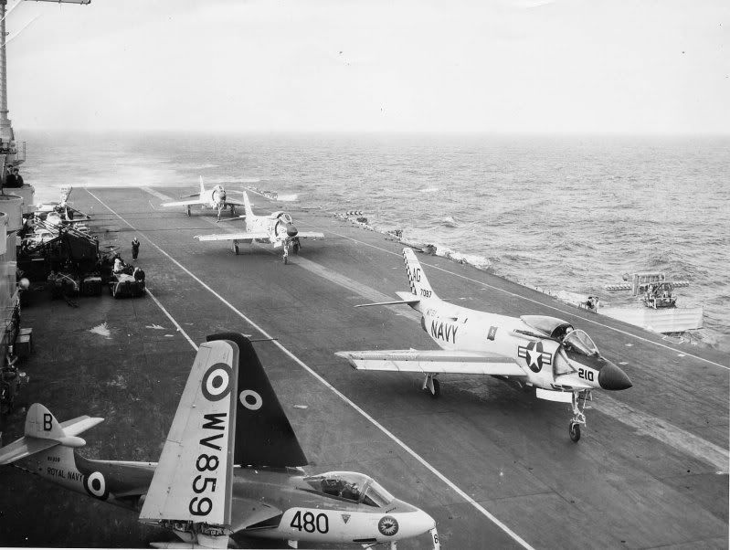

The following photo was taken on Ark Royal in the mid 1950s. Would someone please identify the US navy visiting a/c. Thank you.

NO!
As I said before, ONLY INDEPENDENCE used tail code AG!
NO USN carrier used tail code AG before Independence, so NO aircraft would carry it before January 1959, and all aircraft with it after that date would be from Independence.
Here are the tail codes used by Forrestal during that time period: http://navysite.de/cvn/cv59deploy.htm
January 15, 1957 – July 22, 1957; CVW-1; tail code T; VF-14 (F3H-2N)
This was Forrestal’s ONLY deployment with Demons.

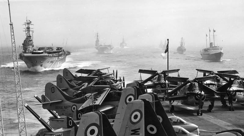

Thanks for the replys and excellent info guys. Here’s another view of Ark with some more Sea Hawks, Gannets. And just for you Mike (last poster) WYVERNS!:D:D;) PS and a Skyraider by the round down!
By: mike currill - 3rd January 2011 at 20:18
With the “Home Fleet” 1957. I think the Harp on the tail of the Gannets was 815 sqdn. There shore base was RNAS Eglinton now Derry/Londonderry Airport!
That’s the first photo I’ve seen of Gannets nesting. Personally I consider the Wyvern one of the worst looking aircraft I’ve ever seen, always looks to me as though someone had a collection of parts left over from different types and put them all together as one machine.

Sorry for the confusion Badger I didn’t doubt your knowledge of ship/squadron deployment. I thought you were trying to tell me the photo was later than 1957.
I have attached the full sized photo for you to down load and expand. It does look like VF51 however I bow to your greater knowledge on the subject.

Here is the entry for the F3H Demon: McDonnell F3H Demon
It was trying to trace the history of CVW-7, to see just when the tail code AG first was used that led me to the possibility of the code being changed during Saratoga’s 1957 deployment.
The first instance of a single-letter tail code being listed as having changed to a two-letter code was for a deployment which started July 1957, and the last was CVW-7… last deployment listed with “L” being the 1957 Saratoga deployment and the first listed with “AG” being the 1960 Independence deployment.
That is why I was thinking the photo had to be from 1960-62… but your insistence on it being 1957 led me to consider the possible change of tail code during Saratoga’s 1957 deployment… with the squadron number VF-61 confirming that.
The USN block numbers make a 5 and a 6 look very similar. Look at this photo of a VF-61 Demon on USS F. D. Roosevelt in April 1957:

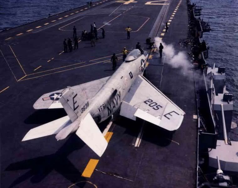

Ok, a few things:
The aircraft is a F3H-2M.
It’s VF-61 “Jolly Rogers”.
The aircraft are from USS Saratoga.
The photo was taken in September 1957 during Operation Strikeback.
Thank you for your info Distiller:)

Ok, a few things:

Fantastic pictures Muscle Manta, thanks for sharing here, one can’t get enough Gannets!
Thanks pagen, here’s another one of Gannets on the flight line in 1958 at HMS Gannet, RNAS Eglinton, Nr Ireland. This is now Derry airport.
