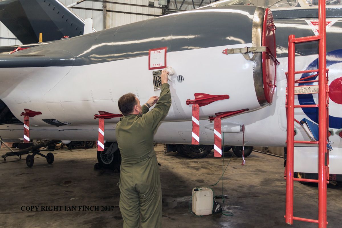

Seeing that the inside of the port door was wet left me disgruntled, as I had hoped to get the door in primer!
http://i819.photobucket.com/albums/zz117/Blue2MGB/Victor%20Stuff/IMAG1396_zps15a14026.jpg
But after a warm in the NAAFI we decided to crack on. Ian got busy on the starboard door
http://i819.photobucket.com/albums/zz117/Blue2MGB/Victor%20Stuff/IMAG1399_zps1c284cb8.jpg
While I set about getting the steel fixings on the port door spick and span. Not bad eh?!

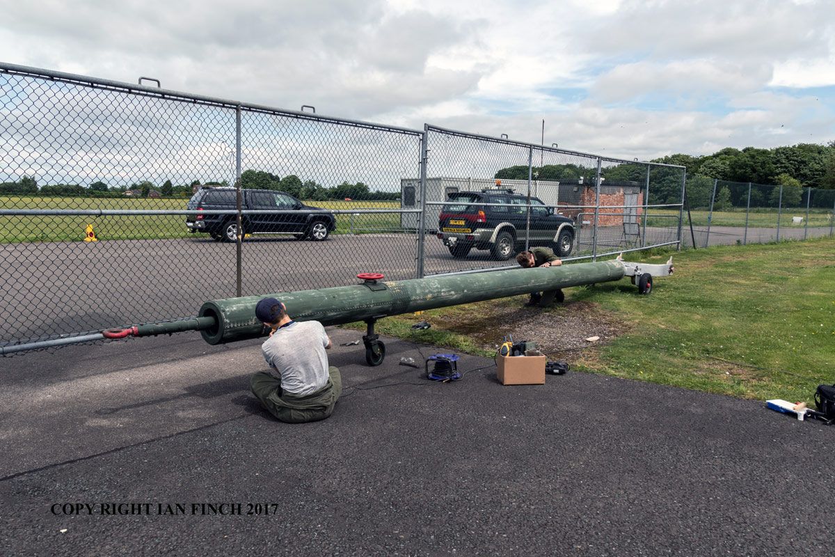

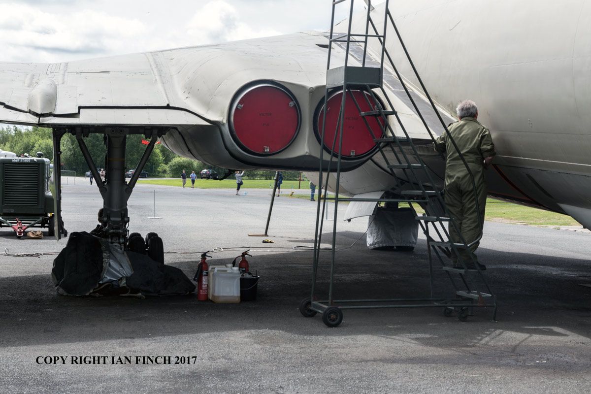

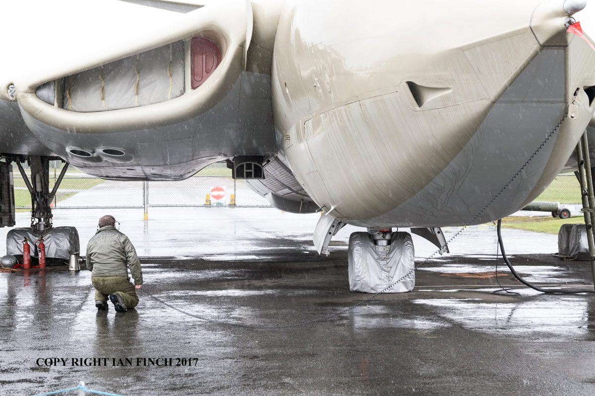

Some more items to report on a productive few weeks, after the last report I actually had a week off as i was a tad poorly and knew the next few weeks are very busy. So two weeks ago we were in and Andre was continuing to replace tyres. He had put our spare set on in mid week and it was time to remove the tyres off this hub and put fresher ones on. Which meant we were in the workshop for a change. Before I started my task I popped outside to chat with Blue and look at the progress on the meatbox. So below is a cross thread picture of Rich playing with the electric string to get the gun sight tray working.
http://i68.photobucket.com/albums/i23/ianfinch_photos/Yam%202017/040A6905a_zps4fyzbdwp.jpg~original
Also in shot was their new mascot a killer white rabbit!

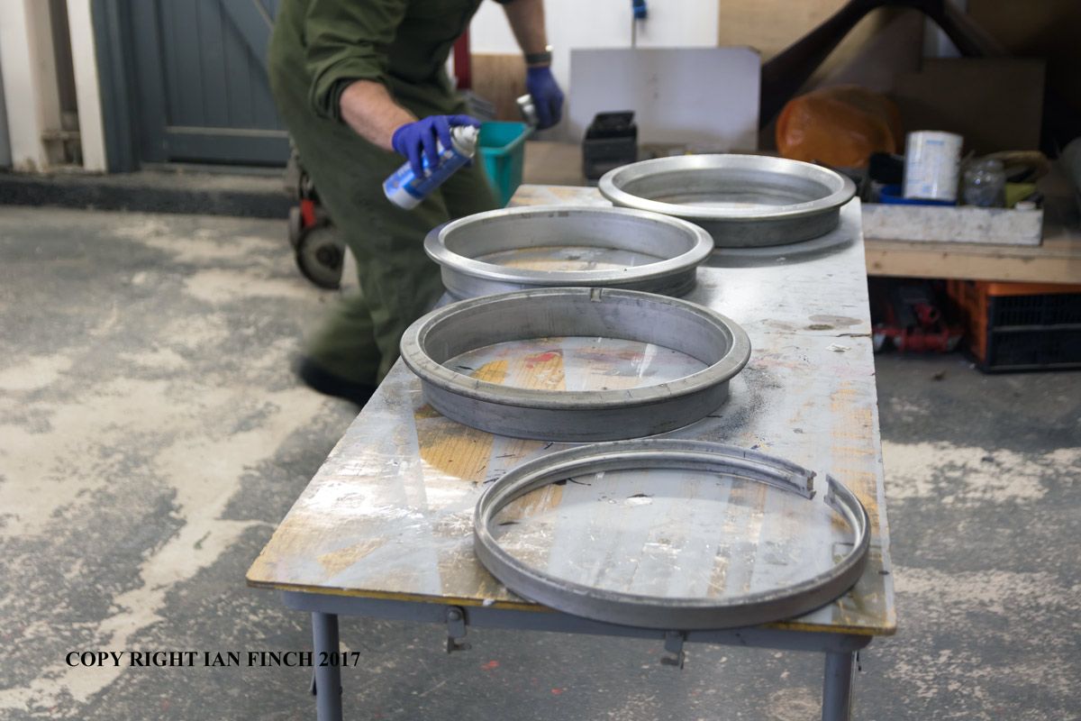

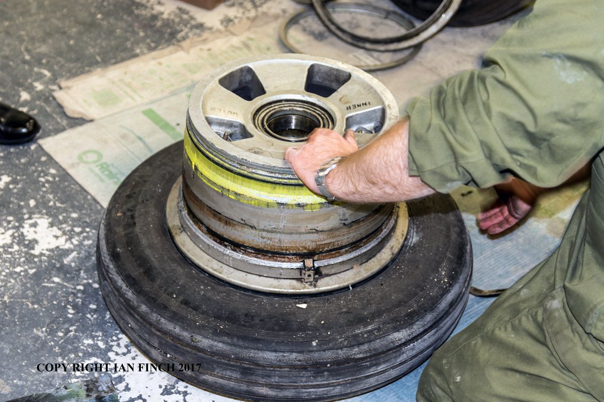

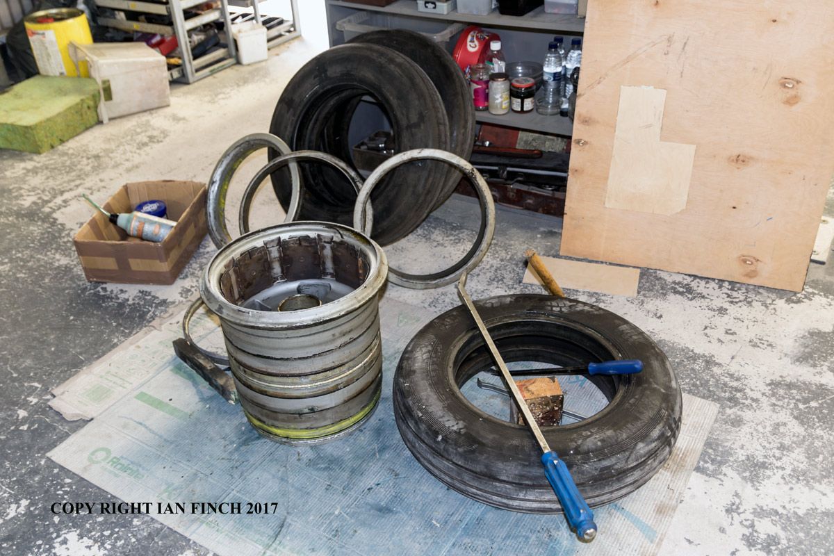

Back inside Andre and Dave began removing the tyres off the hub.
http://i68.photobucket.com/albums/i23/ianfinch_photos/Yam%202017/040A6912a_zpsow6odvel.jpg~original
After the usual reluctance to come off, success was finally won. We noted there was a bit of surface corrosion on the main hub. So John and Andre removed said rust and cleaned all the parts up.
http://i68.photobucket.com/albums/i23/ianfinch_photos/Yam%202017/040A6917a_zpspaxus0ii.jpg~original
http://i68.photobucket.com/albums/i23/ianfinch_photos/Yam%202017/040A6920a_zpswuyn41rl.jpg~original

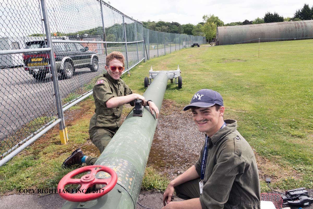

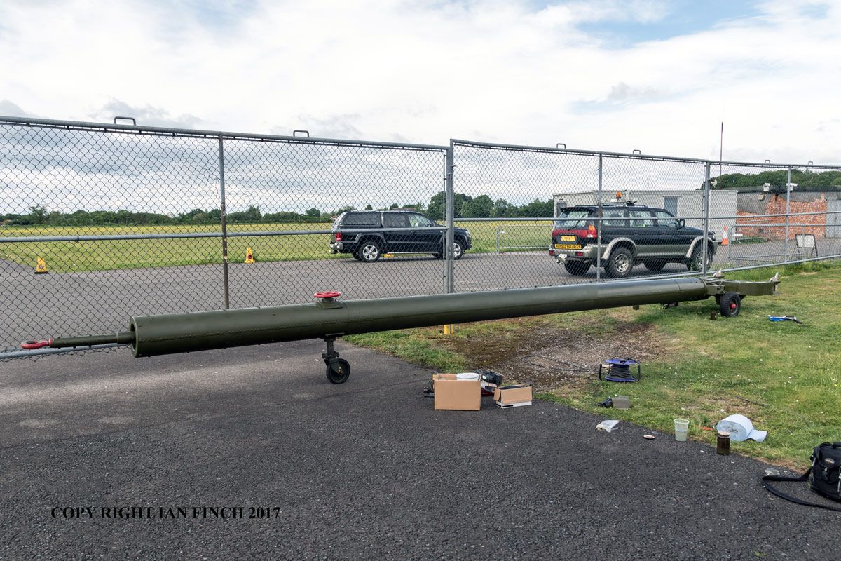

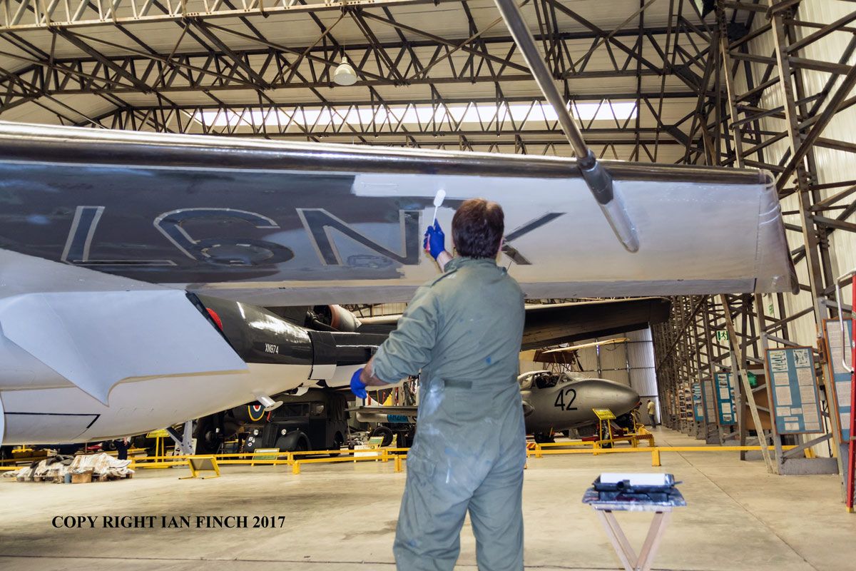

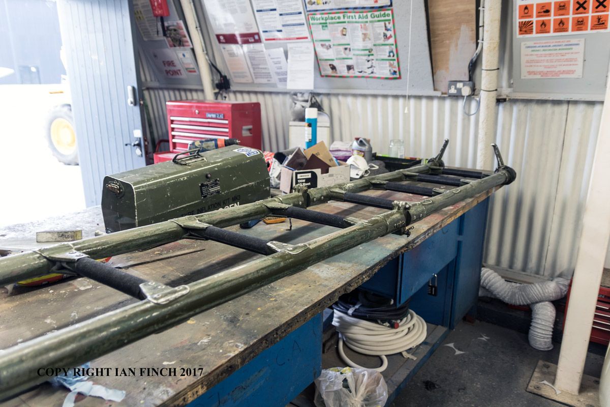

Meanwhile I had a project of my own. Our ground equipment takes a battering. So it was time to repaint and refurbish our crew ladders. First I removed the abrasive off the rungs. Here the top one is the only one left to do.
http://i68.photobucket.com/albums/i23/ianfinch_photos/Yam%202017/040A6921a_zpsz1zitvbk.jpg~original

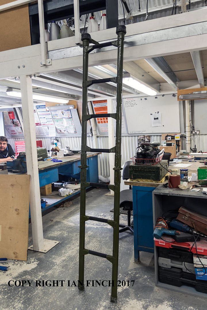

Then I sanded down the ladder and replaced the abrasives.
http://i68.photobucket.com/albums/i23/ianfinch_photos/Yam%202017/040A6924a_zpsvohrmyed.jpg~original

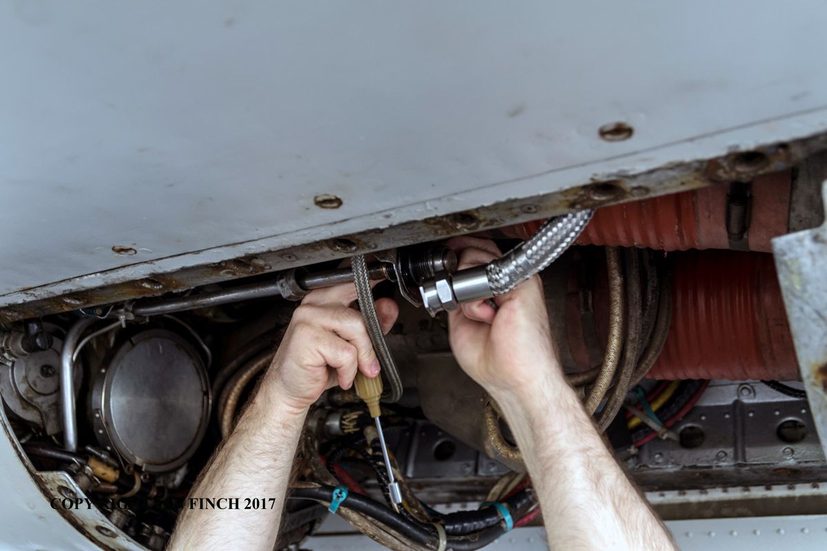

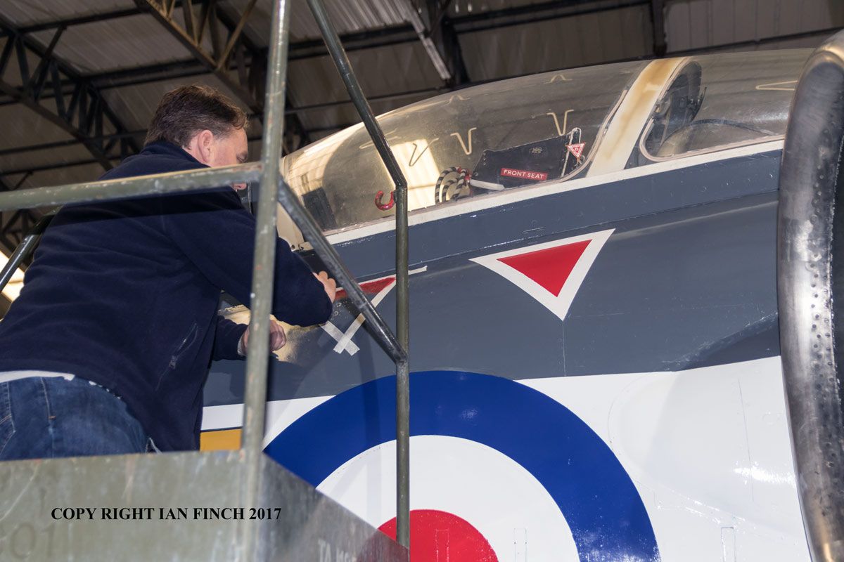

Andre and co also made progress and by the end of the day had all parts restored to good as new and ready to put the tyres on.
http://i68.photobucket.com/albums/i23/ianfinch_photos/Yam%202017/040A6928a_zpsc4hvtlz5.jpg~original
I also made progress with the ladder repainted.

Myself, Sam and Will tackled our tow bar. I had managed to put a under coat on the magnesium bits before Christmas but was stopped completing the bar by the weather till now. So we got stuck in on the sanding and Sam and Will decided to go tribal on it. :highly_amused:
http://i68.photobucket.com/albums/i23/ianfinch_photos/Yam%202017/040A6952a_zpsywfuhnym.jpg~original

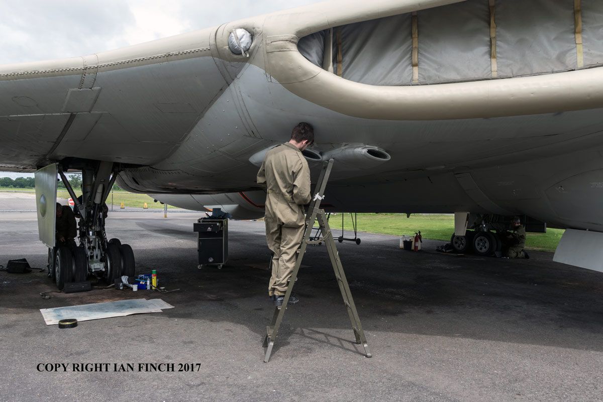

Pete and Freddie was in and they continued their rolling program of cleaning up the air frame when needed. Our trailing edge being magnesium needs constant attention. As seen here with Pete working on it.
http://i68.photobucket.com/albums/i23/ianfinch_photos/Yam%202017/040A6956a_zpsmhp3bbff.jpg~original

By mid afternoon the tow bar was rubbed down and I got to mixing the paint, why the other two completed the smaller bits.
http://i68.photobucket.com/albums/i23/ianfinch_photos/Yam%202017/040A6966a_zps2reky1fa.jpg~original
A few hours later the Olive drab was on and the bar is one step closer to finished.
http://i68.photobucket.com/albums/i23/ianfinch_photos/Yam%202017/040A6974a_zpstwx3pppr.jpg~original
With Andre and John successfully refitting the tyres and checking our brakes we had a productive day. Just in time really as this week coming is very busy. Starting tomorrow ( Wednesday ) I am back at the museum as is Andre to unveil the Buccaneer’s new paint scheme. We will also be running her in front of some guest including a former Navy Commodore. If you can make it in, it should prove good. Then another busy weekend, Saturday the live crews are doing some ground handling training held by a serving ground handling teacher. We decided we needed a refresher course and of course some are new to taxing. Finally Sunday is a Thunder day. So all aircraft subject to serviceability will be running.
With all the running we have done lately this is more good practice for August, so I hope some of you can get down to watch. If you do come over and say hi!

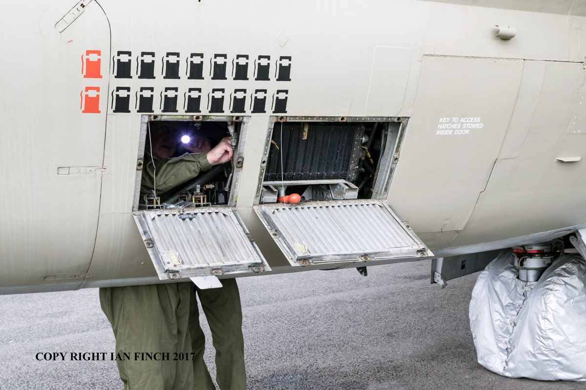

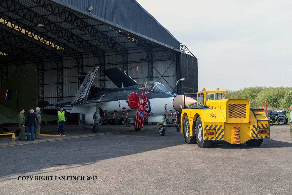

Whilst Sam and Dave tackled this I moved over to the Hangar to help Andre completing the Buccaneer.
The ejection signs
http://i68.photobucket.com/albums/i23/ianfinch_photos/Yam%202017/040A6322a_zps9n7qbuks.jpg~original

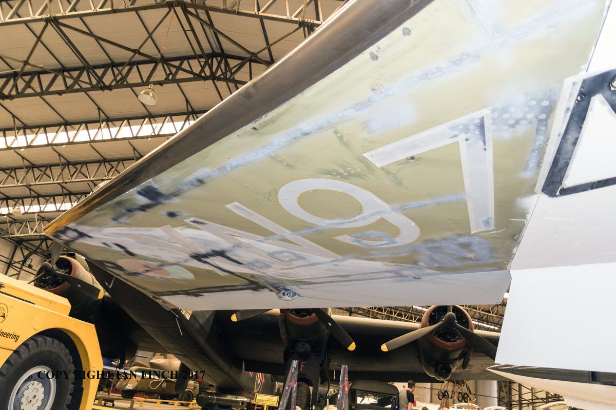

I then prepped & masked the underside wing and serial
http://i68.photobucket.com/albums/i23/ianfinch_photos/Yam%202017/040A6398a_zpsgnttrdq6.jpg~original
Whilst Andre started the other lower wing.
http://i68.photobucket.com/albums/i23/ianfinch_photos/Yam%202017/040A6400a_zpsuoca3bmt.jpg~original

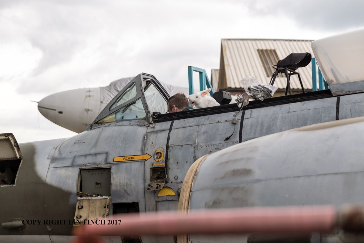

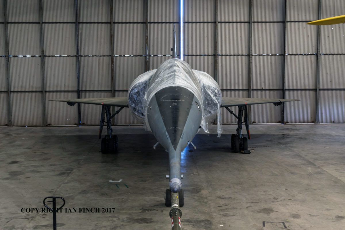

Earlier in the day I took the opportunity to shoot the Mirage IV from a different angle. at this stage it had only had the major assemblies done.
http://i68.photobucket.com/albums/i23/ianfinch_photos/Yam%202017/040A6354a_zpsvadfm1ch.jpg~original
The next week the weather was too damp to paint and our spare non return valve was on site. We spent a very frustrating day trying to fit it. in itself it is not a difficult task but aligning it was tricky and we spent the day getting wet and failing to seal the valve, which continued to leak.:mad:
http://i68.photobucket.com/albums/i23/ianfinch_photos/Yam%202017/040A6447a_zpsgikvgph6.jpg~original
slight wet start.
http://i68.photobucket.com/albums/i23/ianfinch_photos/Yam%202017/040A6569a_zpscywiyzob.jpg~original
In the end we called it a day, very frustrated. We did have one success. Dave and co found and fixed our comms connections and we can now hear everyone clearly.
Last week end was an engineers run day on the Sunday, we were determined not to beaten by the weep/leak we had. So Andre and myself came in on the Saturday. We fitted the pipe and NRV very carefully and was sure all was aligned properly. We started the Artouste and again failure! So we did a very careful fault find and determined the fault appeared to be the replacement NRV. We dismantled it again and did a thorough examination. On looking closer we detected a slight distortion on the taper of the valve and determined it was actually slightly splayed out. We had the old valve with us and this had by now been refurbished, so decided to put it back in.
Below Andre is putting the Valve back on the mounting.
http://i68.photobucket.com/albums/i23/ianfinch_photos/Yam%202017/040A6564a_zpsculfrygl.jpg~original
All tightened up and we tried again and at last a clean and secure connection! it is always amazing how something this simple can cause so much head scratching. By this time it was Dinner, once we had dinner we split up. Andre to wire lock all pipes in place and me to cut round the present Andre had brought in.

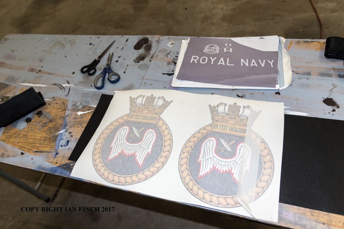

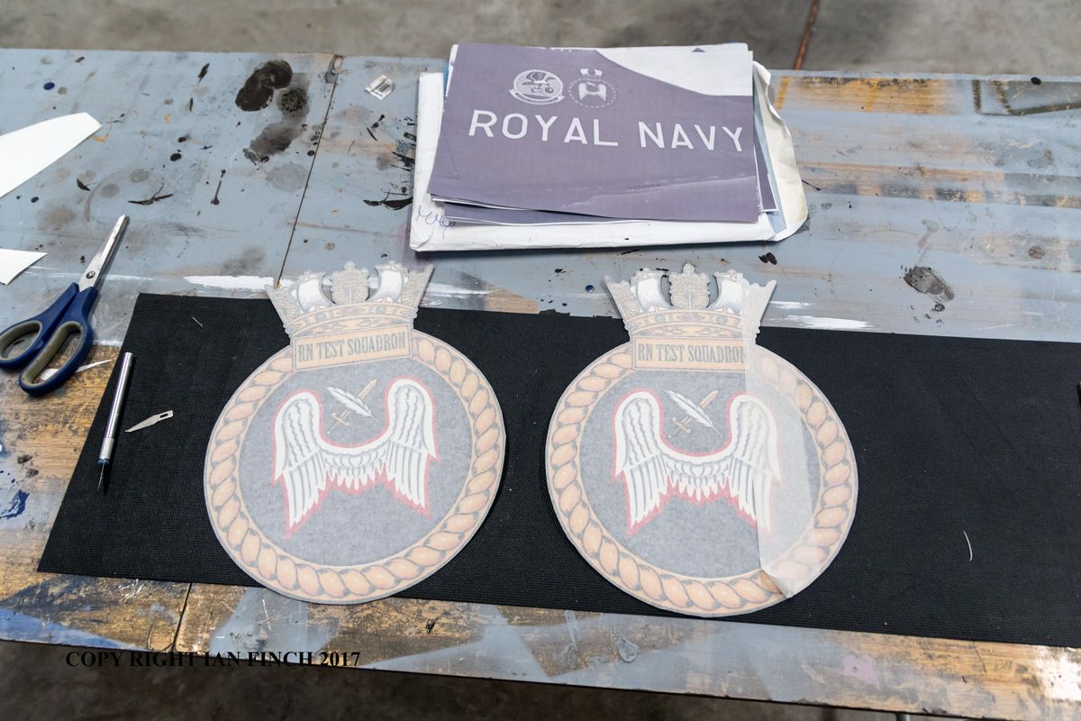

The Bucc was on a test Squadron at Boscombe and it was decided It required a Decal.
http://i68.photobucket.com/albums/i23/ianfinch_photos/Yam%202017/040A6577a_zpseepu6inv.jpg~original
My job was to carefully cut off the waste ready to fit, which after about 40 minutes I did.
http://i68.photobucket.com/albums/i23/ianfinch_photos/Yam%202017/040A6585a_zpsp71docfp.jpg~original
By this time Andre had completed the wire locking and we put the badges on.
http://i68.photobucket.com/albums/i23/ianfinch_photos/Yam%202017/040A6600a_zpsnslbhbhi.jpg~original
Once complete we added the only other 2 decals namely the Rolls Royce ones.
http://i68.photobucket.com/albums/i23/ianfinch_photos/Yam%202017/040A6611a_zps0ihm0fk5.jpg~original

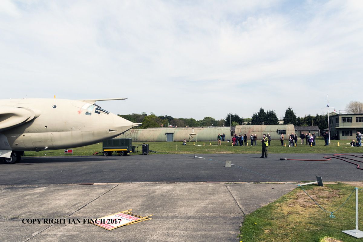

after the last few weeks it was good to leave with a win and we were ready for the next days runs.

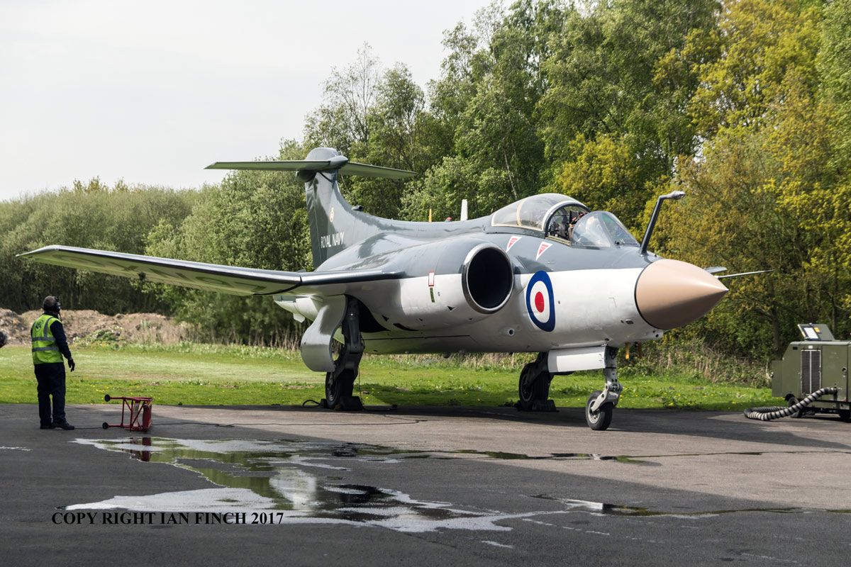

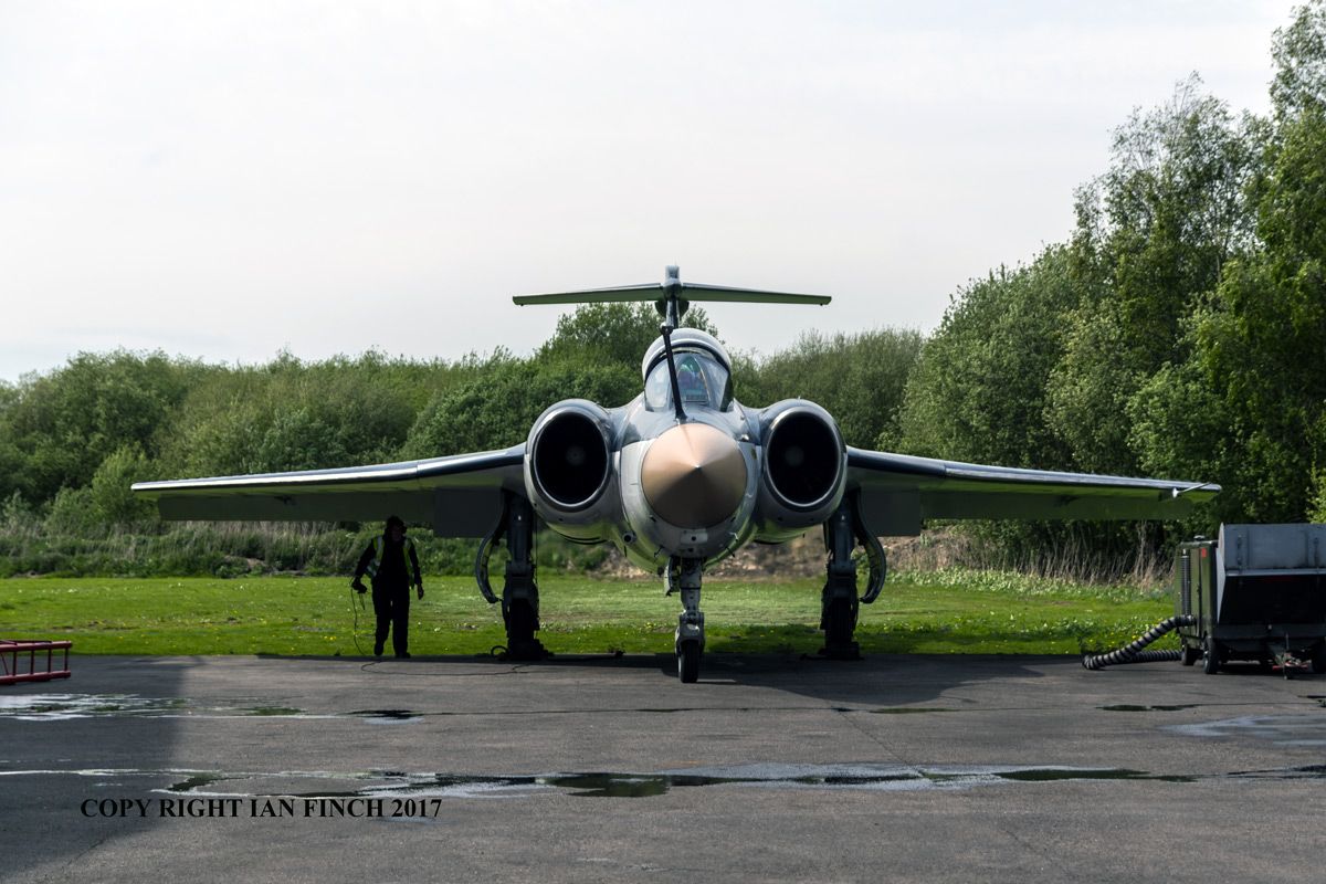

Sunday I was eager to get the first outing into the Sunshine of the Bucc since the major painting had been done.
http://i68.photobucket.com/albums/i23/ianfinch_photos/Yam%202017/040A6685a_zpsgacuig0p.jpg~original

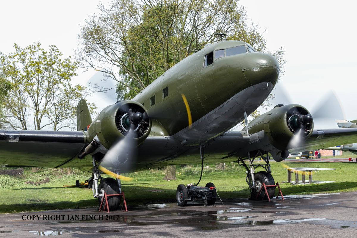

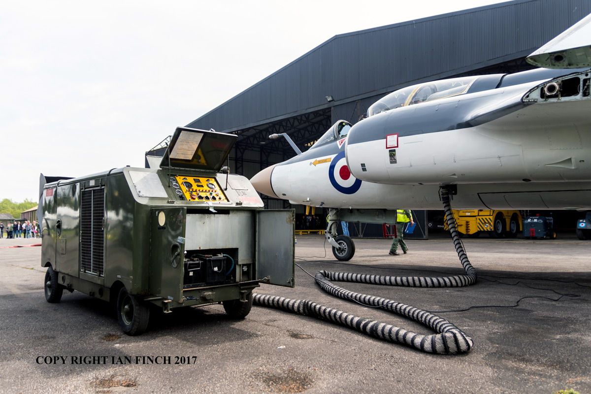

The rest of the day we were busy with the Dak and our Lady, I can report all aircraft ran well. The Dak had a minor hiccup at start but once running ran well. The same with us. We had a small surge in the Artouste, but the engine picked up and all 4 engines were started and exercised well. No major issues were reported. We have a small electrical problem with one system, which we have identified and the solution will be some work in the plenum chamber hopefully today.
A few pictures of the day.

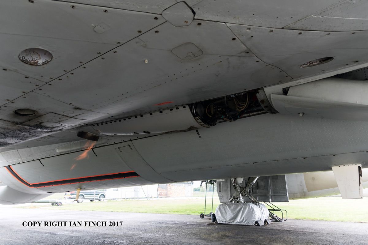

Earlier in the day the logistics vehicles arrived with the jacks and specialised wing attachment equipment. They also brought the smaller bits of the aircraft.
1. Nose minus refuelling probe.
http://i68.photobucket.com/albums/i23/ianfinch_photos/Yam%202017/040A6171a_zpslsuiozpk.jpg~original
2. The probe which is made of steel and quite heavy, so if you look carefully you will see how many holes there are for the amount of screws needed to fit to the nose!
http://i68.photobucket.com/albums/i23/ianfinch_photos/Yam%202017/040A6200a_zpshpihbhwe.jpg~original
