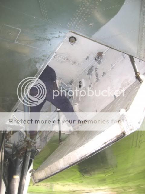

The second photo looks rather painful if something goes wrong…

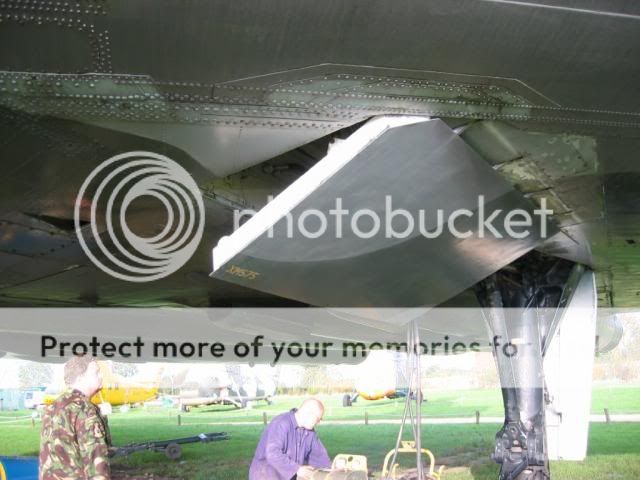

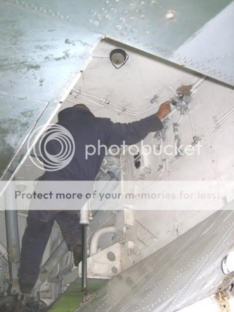

If you put the Hyd rig on to the aircraft you can close the main undercarriage doors with the selector valve up in the Undercarriage…
Just found my old photo’s out… You can see from the photo’s below how it’s done This is Vulcan XM575…

By: aeropark - 23rd July 2013 at 22:19
