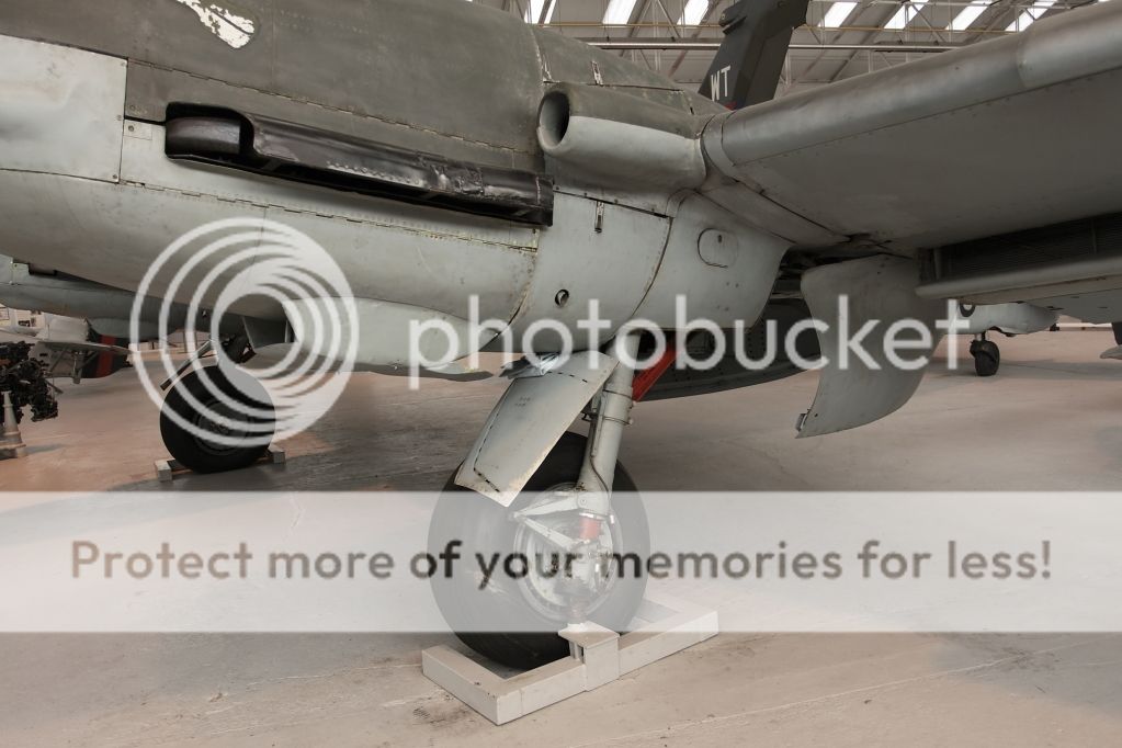

Normally I would say yes in some system or other, it depends on how you term restoration and how deep or complete it was carried out, as it prevents corrosion in the systems, it is also used with gas ( normally Nitrogen, again as it is inert so does not cause corrosion like air that contains water) in the legs to keep the struts extended the gas gives compression and the fluid dampens rebound, but then some may simply have a locking collar fitted externally.
As you can see by the red collar on the Me410 at Cosford, this is to give it some form of extension, so one doubts it is charged any more with gas, also it sits on a jack frame to raise the tyre just off the ground to preserve it, and also has a red strut on the gear leg, that is a ground lock to prevent it folding, I do not know how much the systems were restored when it moved to Cosford, but we ran it at St Athans
