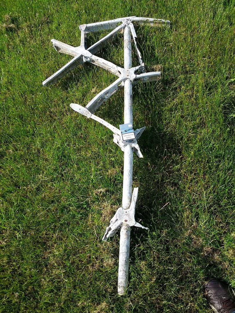

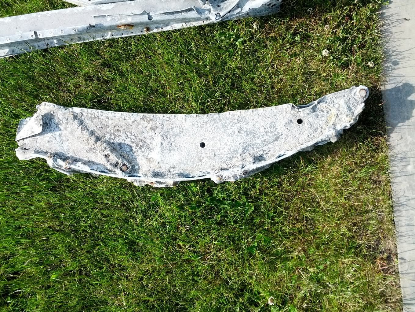

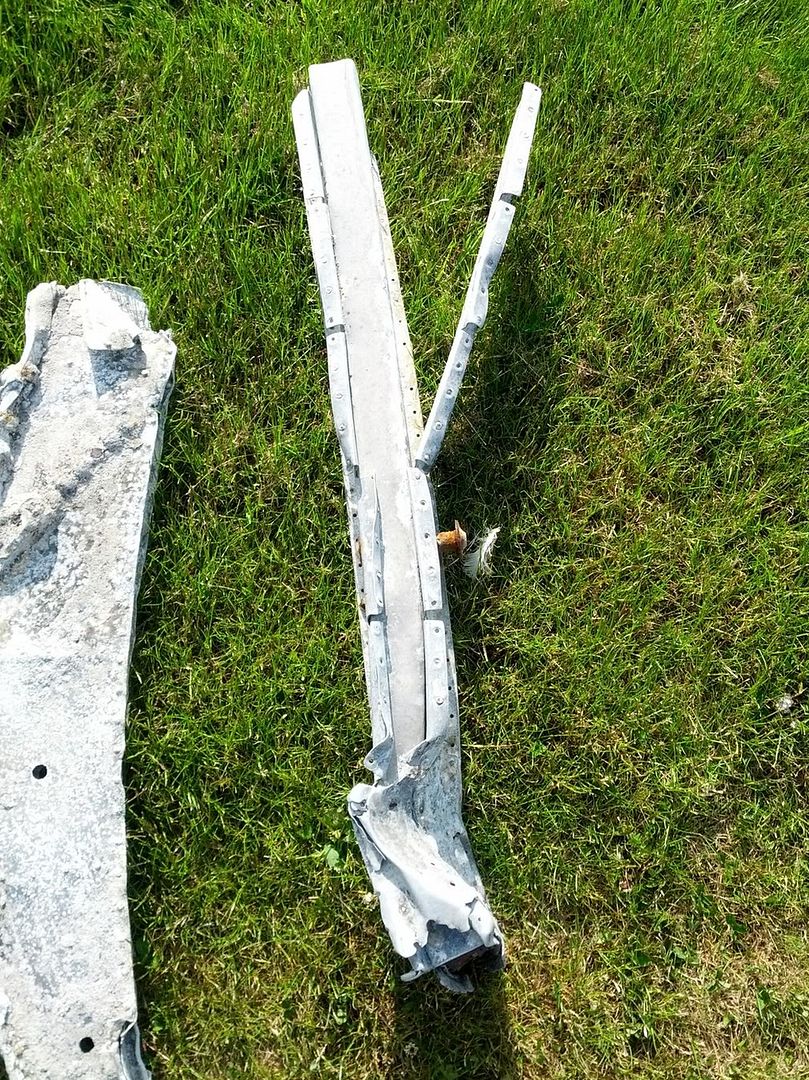

So, a mate of mine went for a walk on the beach today and stumbled across some wreckage. The geodetic design obviously points to Wellington. But is that the case or is it from something else? There was more there but he couldn’t carry it. Looked like it had been washed up very recently. The packet of cigarettes are just to give an idea of scale.
There was also an aircrew boot with a date stamp of 1940 on it which means it was potentially a fatal crash.
Obviously i’m not giving the location away as we now want to see if we can identify the aircraft, especially if it transpires lives were lost.
Thoughts gents?

part numbers on geodetic…Wellington
Looks like …..W or N or V 299……507 79 662 0r062 VP63 in circle…..40607 / 25…… to me. Off of the piece of geodetic in post15

Are these part numbers Wellington
Can’t see any Wellington numbers on those bits. One looks like it might have an ‘AW’ inspectors stamp (the ‘A’ is missing). Worth remembering that at least one Whitley was lost in Spey Bay. If you find any SP or AW prefixed parts they’ll be Whitley.

W460 = Warwick III
Would make sense with the geodetics
