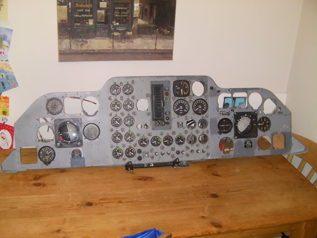

All,
Please see the picture below, I am struggling with the instrument arrangement of my panel, at the top of the flying instruments there is a square hole I would assume for the square compass but this is already fitted on this type to the left. So were any Wessex panels fitted with square ASI?
Any help would be useful, pictures especially!
Simon

I’ll see what I can come up with tomorrow and then email them through!!:)

By: sycamore - 28th December 2011 at 22:44
Pully,the gauges I refer to are the ones missing on the RH panel,you also need a clock,slip-ball ,etc…best find a pic of a Wx 5 as the Navy always were different!!
and as you can see the LH Attitude indicator is different as well..
You could try `Pprune,Rotorheads ,`Wessex `thread and a PM request to `BASTON` as he`s ex Wx5..

By: pully113 - 28th December 2011 at 22:40
Dr Strangelove, yes got the PM! Will reply shortly
Tony D, thanks for the info
Twin Otter, it was about 90% complete, just need the reference really
Tony T, my plan is to have it ready for Cockpitfest 2012, it will be a Tonka free zone for me this year!!

4,649
By: Rocketeer - 28th December 2011 at 21:53
I would think it is a HSI – Horizontal Situation Indicator….not seen ASIs in that location

By: pully113 - 28th December 2011 at 20:20
Sycamore,
Thanks for the update, so the grey panel at the top already has a compass on the left a square hole in the middle and then a space for an altimeter
Bottom left is going to be a RADALT so the middle square is an ASI?
Thanks
Si
380
By: sycamore - 28th December 2011 at 19:54
Pully`s panel is a WX5; missing on the top is Tqmtr,ASI,Compass,and Altimeter.Probably missing is another RMI,like the one far top left,radar altimeter,and probably a `zero reader` homing indicator.You are also missing the engine compressor RPM gauges ,and PTIT gauges. WX 2 and 5 panels are similar,but Navy have the Attitude roll index at the top ,Air force index at bottom.Also WX5 has fuel-tank air press gauges next to fuel gauges. Do not mix instruments from WX 1 and 3 with WX 2/5….(or a 4)
88
By: pully113 - 28th December 2011 at 19:30
Tony,
I think you are right will check some more
Twin Otter,
I did get a couple of shots at the last aeroboot, Bill O let me have a look inside but any more would be great!

9,042
By: TonyT - 28th December 2011 at 18:19
Second panel i would say is a HC 2 see
http://www.airliners.net/photo/0467692/L/

By: TwinOtter23 - 28th December 2011 at 17:50
I can try and access / photograph XV728, the HC.2 at Newark tomorrow morning – but I’m not sure how complete the panel is though!?! :confused:
