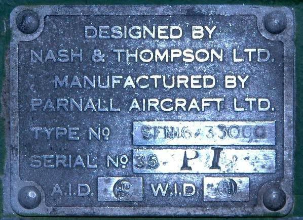

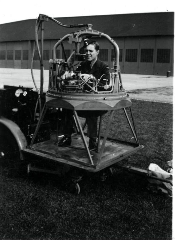

Here are a few photos of our FN16 turret.
We believe is was configured for training and was not fitted with a cupola.
