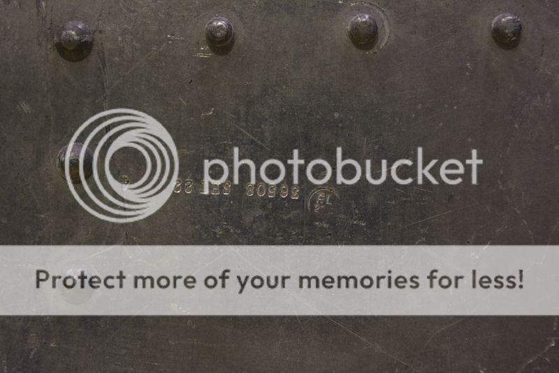

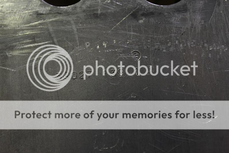

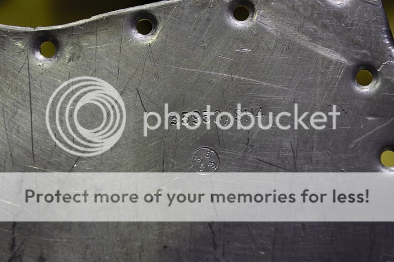

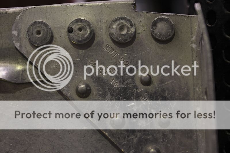

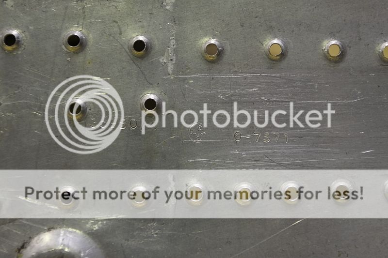

Sorry for the delay, various Spitfire ones for you.
http://i536.photobucket.com/albums/ff321/taylortony/stamps/stamp1.jpg
http://i536.photobucket.com/albums/ff321/taylortony/stamps/stamp6.jpg
http://i536.photobucket.com/albums/ff321/taylortony/stamps/stamp4.jpg
http://i536.photobucket.com/albums/ff321/taylortony/stamps/stamp3.jpg
http://i536.photobucket.com/albums/ff321/taylortony/stamps/stamp2.jpg
Hope they are ok
