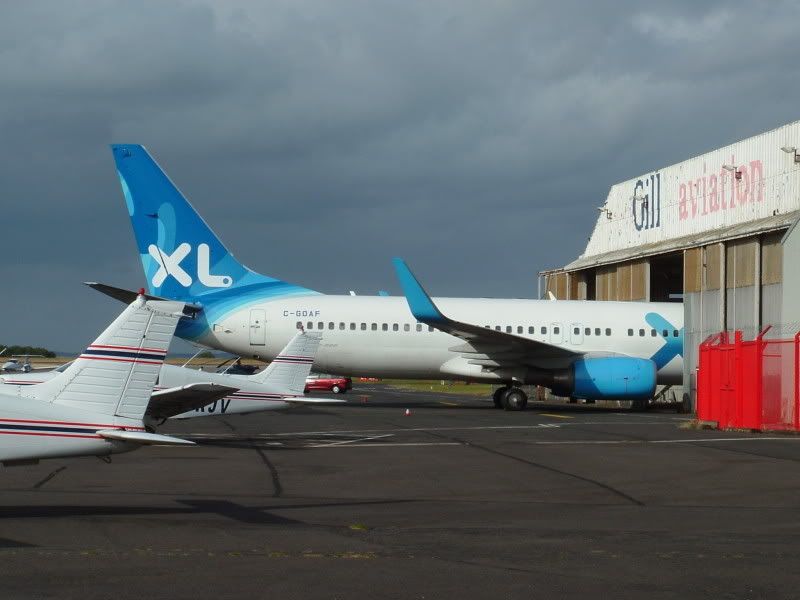

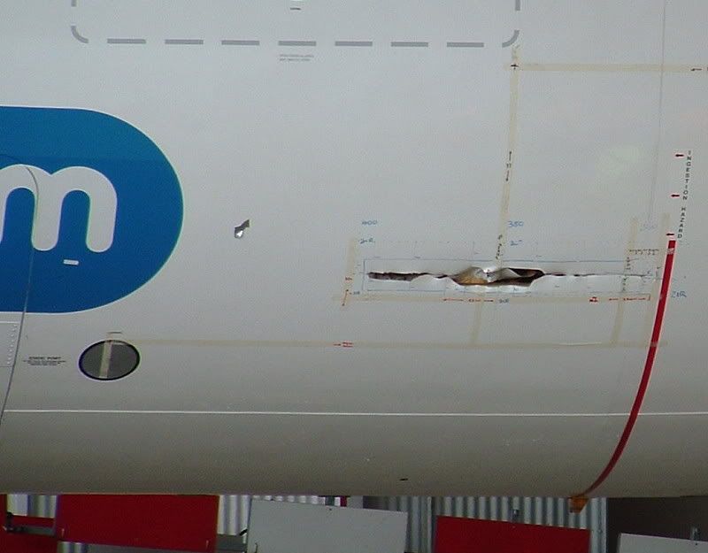

XL’s 737 C-GOAF was damaged at TFS or NCL, apparently it came back to NCL empty for repair but I don’t know how true that is, could it fly in this state?

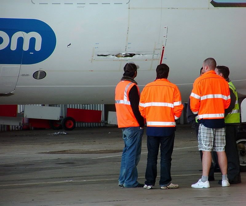

From an engineers POV, that 737 will not and cannot fly with that kind of damage. No one would sign a CRS even if the pilot would take it. As has been said, a competent sheety would be able to do a simple patch repair, jointing the stringers behind. Hopefully not much damage has been done to the frames within, but even so, a repair will be a reletively simple matter.

The first thing that sruck me about the repair to that ,is the access behind it. That damage runs from about halfway along the lower avionics bay to behind the crew oxygen bottle stowage in the forwad freight bay.
To get at it will require the stripping out of all of the avionics and their racks on the right hand side of the bay. Once the repair has been done and all the swarf has been removed there will be an awful lot of testing going on!
The area behind it is also very cramped so the repair will take some time because you won’t be able to get more than one man in the avionic bay at a time. The area in the fwd freight is a little more accessable.
As for the proximity of the static ports. The RVSM area (The grey dotted line oblong on the fuselage) is not affected. The static port aft of it might cause a problem but, as it is below the repair I doubt it. But I would of course consult the relevent SRM’s before starting any work on the aircraft!
Yes I think there will be some serious overtime involved!
Rgds Cking

A big repair, especially with the proximty of the static port 🙁
Lots of overtime 😀
Also depends if it cut through any stringers or longrons, if not then a patch will do the trick. looks a far enough from the static port not to have caused any damage. I guess if that had been damaged (no go item) it would have been grounded and not flown o NCL for repair.

The Gill hanger is now used as storage for the airports snow plows huge things they are and a striped down jet provost!

Should be an easy enough patch repair. Done all the time.

Nice shots there. Dont think iv ever seen that GILL hangar in use especially nothing commercial or as big as a 738.
Nice catch mate
