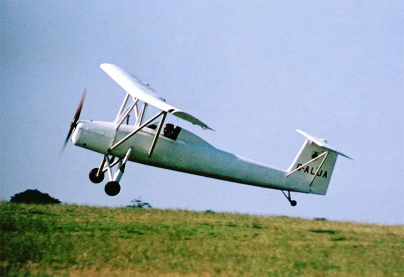

By: Consul - 2nd January 2007 at 00:06
As no-one has illustrated the type in civil scheme in this thread here’s a scan of a slide from my collection. I have a better static shot I took when G-ALUA was in a silver scheme which I’ll post when I can find it!
http://img.photobucket.com/albums/v243/Consul/GALUA1copy.jpg
