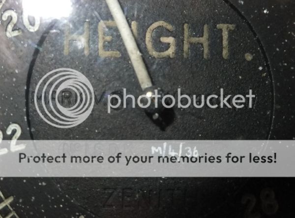

Hi I have just joined the forum.
I came across this Altimeter recently and would be grateful as to any information as to what aircraft it could have been fitted to.
http://i675.photobucket.com/albums/vv115/solihullmatt/Altimetercropped_zps083ae053.jpg
http://i675.photobucket.com/albums/vv115/solihullmatt/Altimeter-closeup_zpsafe975bf.jpg
The markings in the Centre of the dial are:-
Mark VB No.14821/W
No.I.S.D.K M/4/36
ZENITH
The M/4/36 is hand written in white, is that reference to April 1936?
stamped just the right of the top screw on the flange is S BP with a vertical line running between S and the B
The reverse has a Crown, the initials AM and a triangle.
I guess the AM refers to Air Ministry.
The Altimeter goes up to 28,000 feet.
I came across this together with a AM TYPE B REF No. 5C/372 SWITCHBOX IDENTIFICATION morse key, in with a odd collection of junk at an auction in Norfolk UK.
Thanks in advance

By: sopwith.7f1 - 28th May 2014 at 09:35
Hi Matt
These altimeters were used in various types from the end of WW1 onwards, the 1936 date is the overhaul/modification date rather than the date of manufacture.
For some reason those altimeters produced by Zenith’s seem to survive in greater numbers than those built by other manufacturers. My own thoughts on this would be that Zenith were given a contract to supply a large number of them, just prior to the end of WW1, most of which became surplus to requirements by the RAF due to the end of the war, & were then sold for peanuts by the Aircraft Disposal Company during the 1920’s.
I would also like to throw my hat in the ring with regards to obtaining it should you decide to part with it :eagerness:.
Bob T.

By: Coffin_Dodger - 28th May 2014 at 07:57
Thank you for the replies and information, I see reference to this being made by Smiths, but this one is made by Zenith, was it a Smiths design made under licence by Zenith?
And would it have been manufactured in Switzerland or did Zenith manufacture in England or out-source to Smiths, or alternatively it could have been made by Smiths and re-branded by Zenith?
Any Idea’s?

Coffin Dodger (!), welcome and great find. The Mark VB altimeter is listed in the 1930 ‘General Instrument Equipment for Aircraft’ and would feature in any of the silver biplanes of the 1930’s : Hawker Hinds and Demons to things like Vickers Vildebeestes and Vincents. Anything with two wings and a pilot with a moustache doing unauthorised loops.
