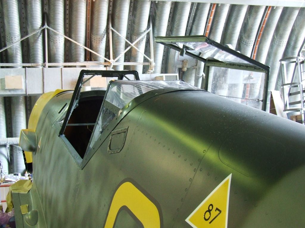

    Yesterday, she was rolled out and today is in Scotland at her first show. Been a wonderful project to work on. Sometimes stressful, sometimes fun, but very very interesting. A few months ago and I knew virtually nothing about 109s cept for films and airshows, but now know a little. This project would not have been finished without the invaluable assistance from so many people, but notable Steve Rickards for his expertise, Lynn Ritger, Ralph Moser, Zsolt Keri, Harald Wiegand and Ronnie Olsthoorn. Thank you gentlemen.
    What with the interest in this build on forums such as this and on social media, I hope that this won’t be the last one that we build. There can’t be many FSMs as detailed as this?
    Today, thought would have a day off, but no, starting work on a P-51D replica and a Spitfire VR system for America. No rest for the wicked!
    Again, thanks to everyone for their kind comments. As always so much appreciated.
    Best wishes,
    Martin
    http://i1076.photobucket.com/albums/w447/T6flyer/Outdoors_21.jpg
    http://i1076.photobucket.com/albums/w447/T6flyer/Outdoors_10.jpg
    http://i1076.photobucket.com/albums/w447/T6flyer/Outdoors_4.jpg
    http://i1076.photobucket.com/albums/w447/T6flyer/Outdoors_3.jpg
    http://i1076.photobucket.com/albums/w447/T6flyer/Outdoors_23.jpg

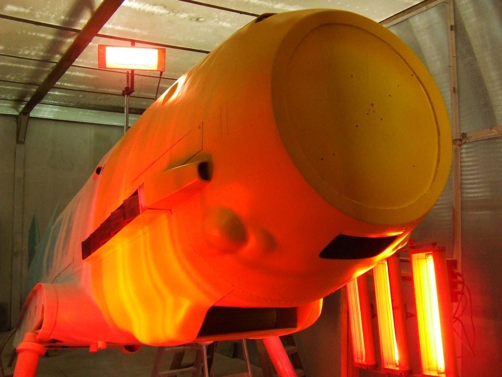

    Painting day today. Fuselage is all finished and is now being weathered. It’s the turn of the control surfaces today and we are especially pleased with the rudder, hopefully the first of many. The wings go in tomorrow and then after that, it’s just a case of sticking it all together and delivering to it’s new owner. What could be more simple!
    http://i1076.photobucket.com/albums/w447/T6flyer/Paint_3.jpg
    http://i1076.photobucket.com/albums/w447/T6flyer/Paint_4.jpg
    Talking of Red Nosed 109s, we have had an enquiry this very afternoon where someone mentioned Messerschmitts of that colour. If someone wants one, we can make it and they can have any colour they would like!
