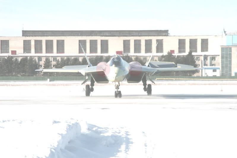

    in reply to: The PAK-FA saga Episode 12.0 #2427813
    Amiga500
    Remember reading somewhere here that the front landing gear is shorter than the rear two which means it is bent foward here. So the horizontal front position in this image is NOT horizontal front position in the air. So the engine is MORE out of plane in vertical axis in this image than it will be in the air. So drawing circles on ground position front image is meaningless. Just commenting on vertical offset between intakes and engines here and not questioning the effectiveness.
    I’m aligning from the upper surface, so from that POV, the short front landing gear is not an issue.
    Of course, as you say, the attitude in flight will be different, but I’m sure most on here can make the estimate change in azimuthal angle. 🙂
    in reply to: The PAK-FA saga Episode 12.0 #2427819
    Amiga500
    Guys, I think your ‘disks’ maybe a bit on the large side. Su-30MKI/AL-31FP:
    Probably. I was trying to match the approximate radius of the upper surface using paint…
    An effort that was always doomed to disaster! 😀

    in reply to: The PAK-FA saga Episode 12.0 #2428363
    Amiga500
    Can you put another disc over mine to show your opinion where compresso blades could be?
    IMO, they would be approximately where the large yellow panels on the upper surface end (their trailing edge)…

    in reply to: The PAK-FA saga Episode 12.0 #2428397
    Amiga500
    http://img.photobucket.com/albums/v297/wsoul/T50/t50.jpg
    You need to move those two discs inboard further. You are probably aligned with the turbine blades, the compressor blades will be a good distance upstream, and hence further intoward the plane centreline… and perhaps vertically down a bit too.
