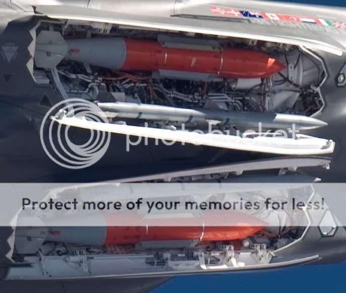

    in reply to: Hot Dog's Ketchup Filled F-35 News Thread #2298184
    LowObservable
    The cant of the 9x pylon serves two functions; to provide clearance for the mid-board pylon and to clear the flap.
    http://i619.photobucket.com/albums/tt271/SpudmanWP/cea308fe.jpg
    Unconvinced… the crank in the AAM pylon (which, by the way, is one of five out of 11 stations on the jet that are single-purpose, that is, there’s only one store they can carry) has nowt to do with the flap. But the incidence differences between the AIM-9X and bomb pylons are huge. It’s like the much-criticized toeing-out of the Shornet pylons, just in the vertical axis.
