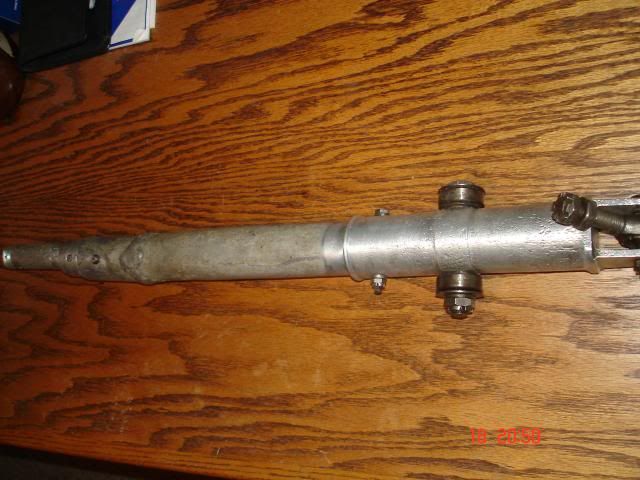

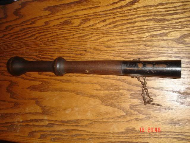

    in reply to: Your Favourite Control Column Stick/Yoke/Grip! #958812
    coldkiwi1
    Avro 504 and Kawasaki Ki 61 “tony”. Unfortunately someone tried to clean up the Tony column and removed most of the original paint in the process.
    Nothing like a bit of variety in a collection…….:)
    http://i982.photobucket.com/albums/ae306/coldkiwi1/DSC04346_zps2e472a42.jpg
    http://i982.photobucket.com/albums/ae306/coldkiwi1/DSC04347_zpse2f76950.jpg

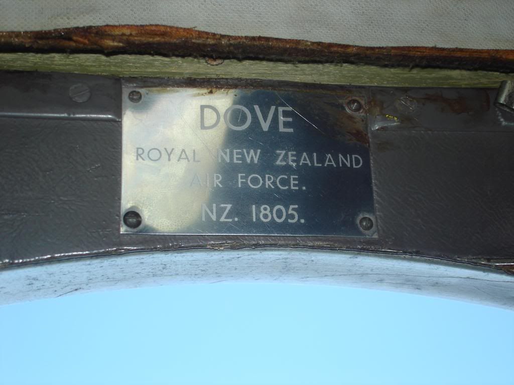

    in reply to: de Havilland Devon or Dove? #980090
    coldkiwi1
    Posted by Fariz:
    “As the plate does not have the c/n no. am I right in assuming that it’s not a manufacturers plate but was fixed after the aircraft was preserved? The Royal Malaysian Air Force Museum refers to it as the Dove”
    No – the plates were in the aircraft when they were retired from military service. I would suspect these plates have been in the aircraft since they were received new from de Havilland.
    in reply to: de Havilland Devon or Dove? #981415
    coldkiwi1
    Agree that all literature ( including official) refers to the RNZAF aircraft as Devons due to military fit. The plate fitted by the main entry door on at least two aircraft ( NZ1805 and NZ1806) does however refer to the aircraft as Dove:
    http://i982.photobucket.com/albums/ae306/coldkiwi1/DSC03446_zps49b04df5.jpg
