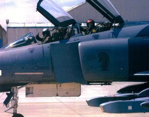

    I’m interested in finding out more about the Turkish F-4E upgrade that doesn’t involve the 2020 birds…if indeed there is one.
    As for the RF-4E upgrade, I believe they are also getting a new type of camouflage…photos of the new recce birds and/or their cockpits would be awesome if anyone can find anything.
    As for a great features from various upgrades, how about the one-piece wrap-around windscreen that was fitted to a handful of USAF F-4G’s and RF-4C’s towards the end of their service lives.
    Additionally, the Litening targeting pod from the Hellenic PI2000 upgrade is also a great new feature.
