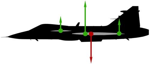

    I am always a little uncomfortable about getting involved in these “which is the better” configuration discussions. The reason is that it is very often a function of the specific design requirements of the aircraft you are designing. Consider this: When Gripen (and many other modern aircraft) was designed, one of the strong candidate configurations was a conventional layout (albeit with a funny location for the engine intake). Now, if teams of aeronautical engineers, some with PhD’s in aerodynamics, decided that it would take some serious study and wind tunnel tests to decide which configuration was better, then maybe the answer isn’t so simple?
    http://img.photobucket.com/albums/v486/robban75/griplift.jpg
    The analysis you make although valid, in one way disregards real aspects seen in modern aircraft.
    To make a Canard-tailplane analysis most aerodynamists will do it with canards and tailplanes of the same size, with wings of the same size and the same degree of stability.
    It happens that each aircraft has different parameters and more important different solutions, let us put two very basic examples.
    Gripen Versus MiG-29 and F-16 and the F-22 and T-50 versus the Eurofighter
    The MiG-29 and F-16 have LERXes which basicly add a lifting surface ahead of the wing and have the same function of the canard, so the LERX is basicly doing the same thing the Gripen`s canard is doing, reducing the supersonic aerodynamic center of shift movement thus reducing trim drag; in the case of the F-16, it has considerable forebody lift and has relaxed stability thus reducing even more trimming needs.
    In the case of the MiG-29 its tailplanes are quit far from the center of gravity and have higher swept than the wing reducing trimming needs further.
    Now what are the visible advantages of the Gripen?
    well the delta makes for a big wing area with respect the small size it has and up to a degree offsetting thrust needs.
    Now since this aircraft are not designed for supercruise the max speed up to a level is not as important, however let us go to its known performance.
    The MiG-29 is faster than the Gripen and both the MiG-29 and F-16 have higher STR than the Gripen, the Gripen is smaller and has a higher ITR, this makes the Gripen economical in fuel comsuption and difficult to spot visually but it can not keep sustained maneouvres with both the MiG-29 and F-16 and very likely it won`t out accelerate the MiG-29

    Kiwi, the Cp moves whether you want it or not. 🙂
    It’s a lift product of the entire wing, expressed as a vector and it “moves” according to current alpha and position of the AC and cambering.
    Flight is a dynamic process in terms of Cp/CG relative positions and it permanently changes the value.
    This is why, non-FCS steered planes have trimming buttons on the flystick to offset permanent Cp/CG relation change.

    in reply to: Canards and stealth. . . #2394408
    kiwinopal
    no?!
    if the center of gravity is in the rear part of the wings it has a bigger moment arm to close coupled canard(or any form of canard). that is a fact.
    if it was a stable platform it would have been the other way around
    those are more myths and a fairy tales, excessively tail heavy aircraft pay with drag, the F-22 has its moment arm the farthest from the fuselage independently of weight, it is unstable no doubt but its light tailplanes are the farthest tip of the aircraft`s length.
    excessive pitch up in a canard configuration makes for more trim, with or without canards you need a balance
    in reply to: Canards and stealth. . . #2394413
    kiwinopal
    What does “fulcrum” in this context exactly mean?
    Irrelevant.
    What matters is current distance between Cp of the wing and Cp of the canard/elevator.
    In most cases canard wins and even more during maneuver, when Cp shifts rearward, towards the elevator.
    It’s only when the Cp is in the AC of the wing, that the momentum arm is the smallest (needs largest trimming force) for canard configuration, but the wing has the best drag/lift characteristic, at that point and so very efficiently mitigates total drag, which is very useful during sustained maneuvering.
    Correct me, if I’m wrong, but I’m not sure whether you know, why planes have LERX.
    You’re mixing some things here, hence my conclusion, but I could be wrong…
    i am not wrong you are wrong, the center of gravity is where an aircraft is balanced longitudinally, that is the reason it is called center of gravity.
    the canard configuration suffers less at supersonic speeds relativelly just because of additional lif ahead of the center of gravity, so any movement of the aerodynamic center will be balaced by the canard or LERX.
    But a tail heavy aircraft also has to be balanced in the same way a nose heavy aircraft by trimming.
    Think about that, that is the reason the Viggen is stable.
    in an unstable design with or without canards you can not make the aircraft excessively tail heavy or you will pay with drag trim
    in reply to: Canards and stealth. . . #2394437
    kiwinopal
    It is unstable and its tailplanes are the farthest things form the center of gravity unlike a canard on a Rafale, Eurofighter, J-10 or Gripen which need to be closer to the wing and closer to the center of gravity.
    here we talk about distance not about weight.
