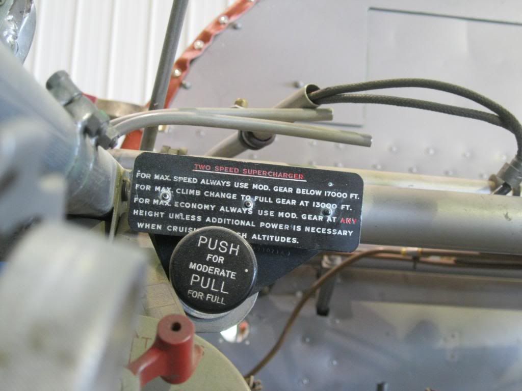

What gauge of material are you using for the labels? And is it black anodized alloy?

The lighting gels work great. This restoration is going much easier than I thought.

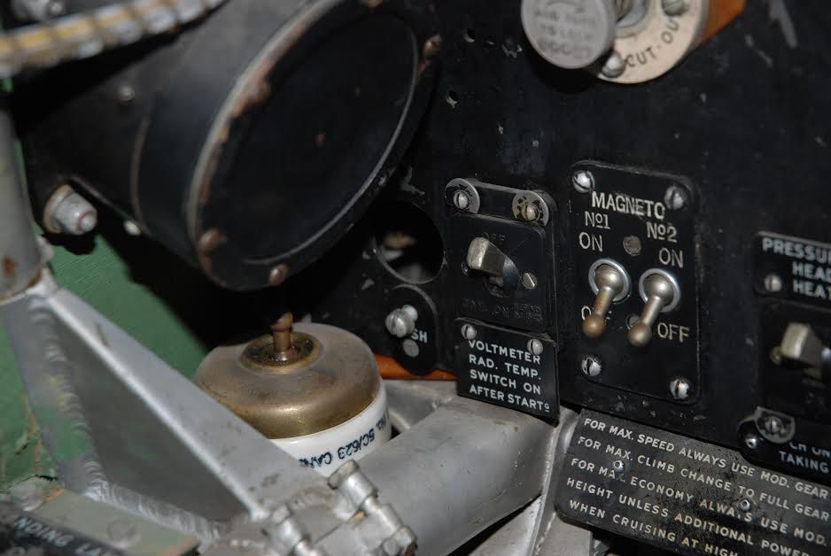

That would be great. Let me see if I can get more pictures taken from RCAF 5447.
Great pictures, Tony. I’ve learned something more about the C joint from them. I did not realise that more than former #1 attaches to this piece. Thanks for sharing.
Ron
Thank you Tony. I very much appreciate the time you’ve taken to source the name. Yes, a photo would be great too.
