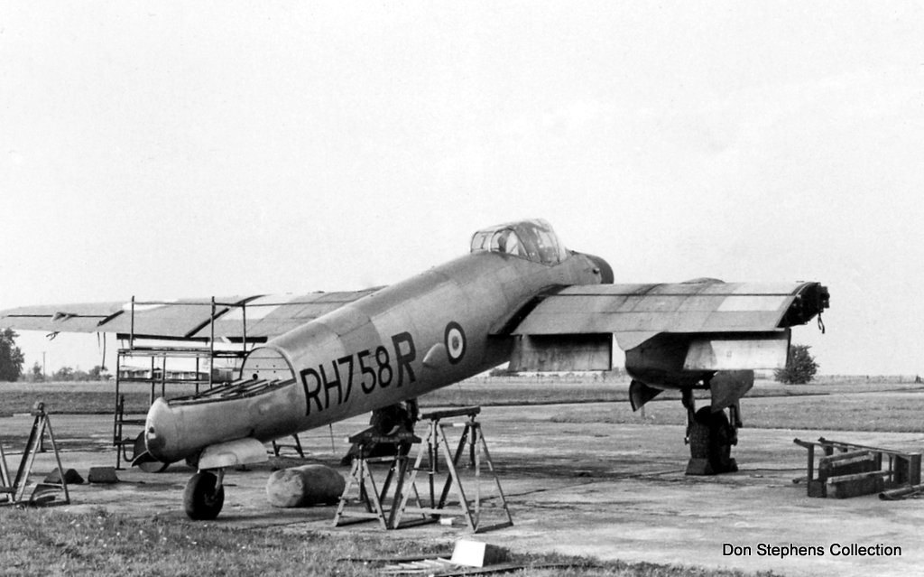

    https://i.postimg.cc/Dw83hxbG/DSC-A0120.jpg
    RH758/R is dated RAF Colerne September 1956 (the others being 1957), presumably at the time of their Battle of Britain Air Display.  Year might be an error?

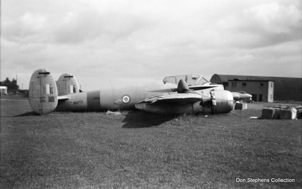

    https://i.postimg.cc/bJf7Q8V0/IMGDJSNegs-0043.jpg
    RH771, RAF Colerne, at the time of their Battle of Britain Display 14th September 1957 (scanned from negative).  The Gloster Meteor F.4 beyond is 7151M/60 (VT229).

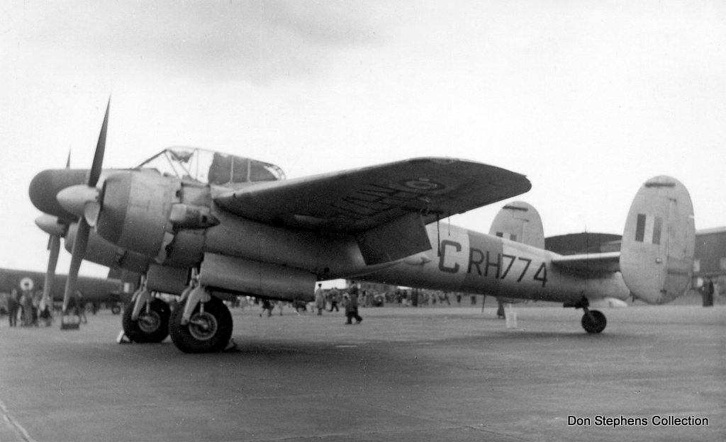

    https://i.postimg.cc/qBxTxhTN/DSC-A0119.jpg
    RH774/C, no place or date provided with this print.  This one being near complete would appear to be in an air display static aircraft line-up.  Filed with the other Brigand shots, likely also 14.09.57 Colerne, but not confirmed.

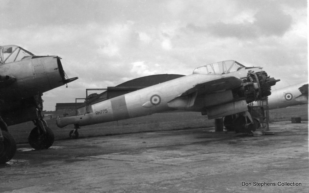

    https://i.postimg.cc/VL7P2x51/DSC-H0122.jpg
    RH775, one of line of aircraft being stripped, at RAF Colerne at the time of their Battle of Britain display, 14th September 1957.

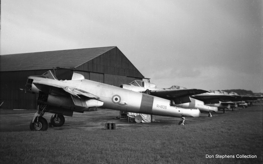

    https://i.postimg.cc/mr9xzhj2/IMGDJSNegs-0038.jpg
    RH806 at the head of a line of at least 6, possibly 7 aircraft (RH775 is the second along) at the time of the RAF Colerne Battle of Britain display, 14th September 1957.  Scanned from a negative.

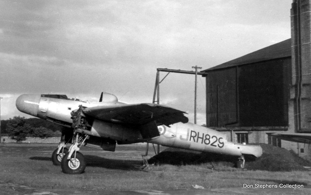

    https://i.postimg.cc/jdqrgxxZ/DSC-H0115.jpg
    RH829/J, RAF Colerne, at the time of their Battle of Britain Display 14th September 1957 (scanned from a negative).
    If only one of these had lasted another few years in the back of a Colerne hangar, it would have been wheeled across to join the aircraft being collected together at Colerne, eventually to move to the Royal Air Force Museum at Hendon and this discussion thread lamenting the lack of a complete survivor would be unnecessary. If only ….

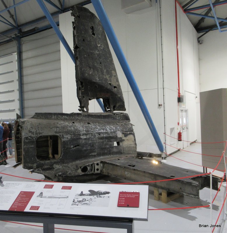

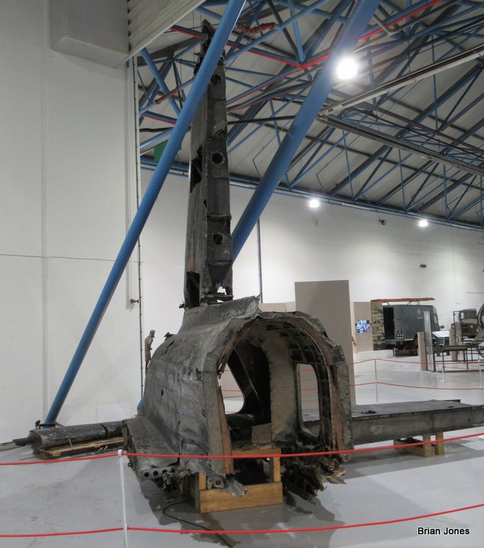

    Visited the RAFM Hendon for the first time in around 30 years in late May 2024 and was must surprised to find the tail of a Stirling displayed in the same hall as the Lancaster and recovered ‘as is’ Halifax.  To put context to the comments just made above, two images:
    https://i.postimg.cc/XqWQPC87/IMG-8734.jpg
    https://i.postimg.cc/fLm85KYr/IMG-8737.jpg

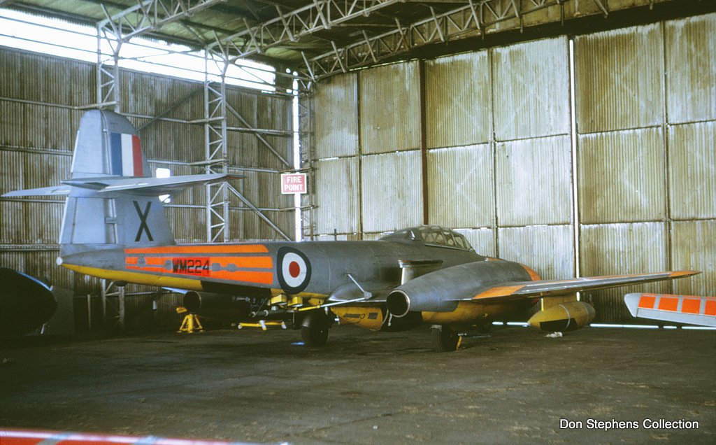

    The 2022, 26th edition of Ken Ellis’s ‘Wrecks & Relics’ provides an outline ‘time-line’ history for WM224 and confirmation that it was the one carrying marks ‘WM311’ at North Weald.
    Built by Armstrong Whitworth Aviation at Coventry as a Gloster Meteor NF.11 in 1952.  Operated by 228 OCU and 29 Sqdn.
    Converted to a Meteor TT.20 and served with 3/4 CAACU, 3 CAACU and 5 CAACU. (CAACU – Civilian Anti-Aircraft Co-operation Unit)
    To the CSDE at RAF Swanton Morley (Central Servicing Development Establishment) and allocated maintenance serial 8177M on 15.10.71
    Subsequently to Mr D Walker, a tractor-collector at Watering Farm, East Dereham by road on 16.11.75. (W&R 5 1976).
    To North Weald Bassett by 3/77 for use as an attraction outside the ‘King’s Head’ public house (W&R  6 1978).  Which neatly adds detail to ‘Sabrejet’s’ recollections.  By W&R 7 (1980) recorded as having moved to North Weald Aerodrome, less wings.  In W&R 8 (1982) reported to be with the Air Restoration Wing who were establishing a museum collection at North Weald and by W&R 9 (1984) the collection was open to public at weekends and the Meteor to be under restoration.  Later while at North Weald, identity ‘WM311’ was applied.
    To East Midlands Aeropark Museum on 12.01.03 and currently on public display.
    https://i.postimg.cc/Dhx3ppFx/Wv-4-9-71-1.jpg
    WM224 at RAF Woodvale with No.5 CAACU on 4th September 1971 as a Meteor TT.20.
    https://i.postimg.cc/BJ3YPzpX/IMG-6297.jpg
    A recent photo of mine showing WM224 on display at the East Midlands Aeropark in early September 2023 where it is part way through a re-paint.  If you want to visit, then all details are on their website.

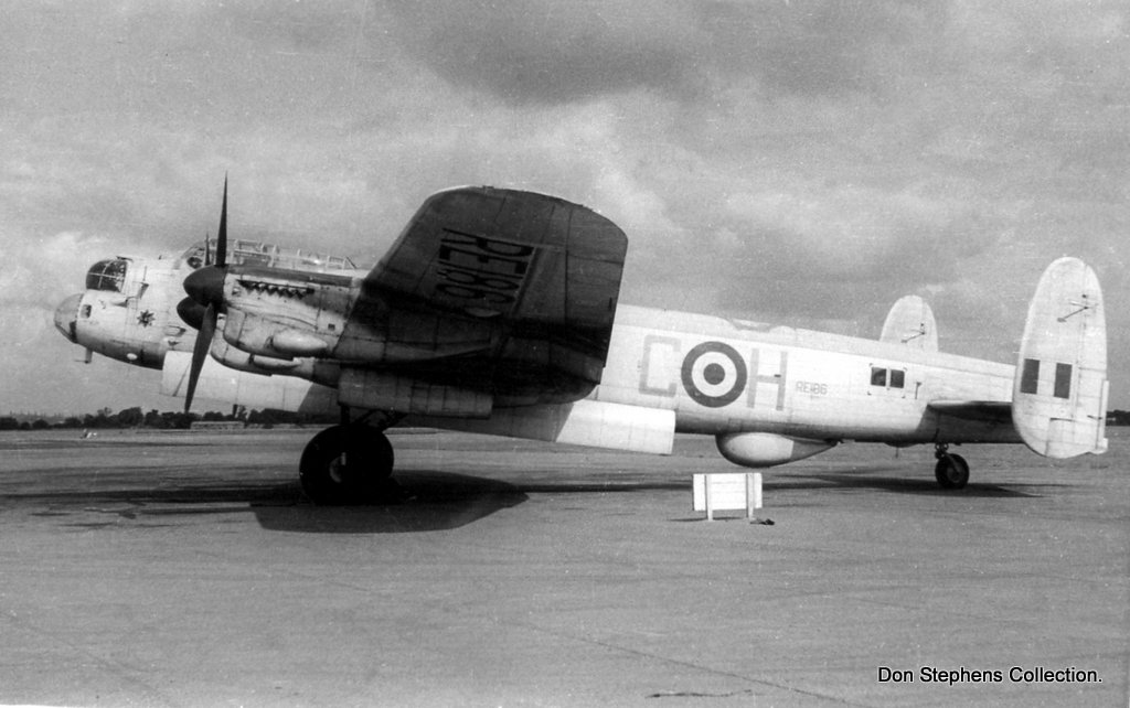

    To keep this thread rolling, a couple more maritime Lancasters to illustrate further:
    https://i.postimg.cc/p2wxBLSp/DSC-D0071.jpg
    RE186/H:C, Lancaster, School of Maritime Reconnaissance. At Blackbushe during SBAC Farnborough week, 10th September 1955

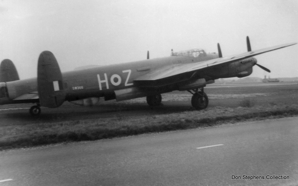

    https://i.postimg.cc/NQPQ5478/DSC-H0156.jpg
    SW366/H:Z Lancaster.  Also at Blackbushe during SBAC week, year not known, but mid 50’s.

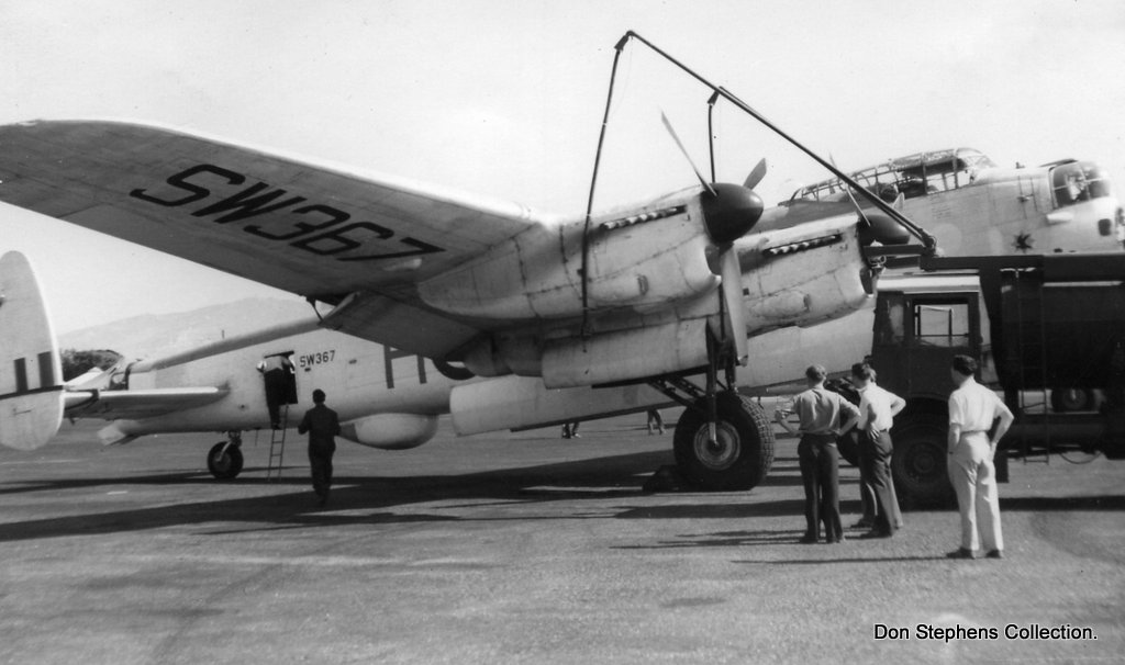

    https://i.postimg.cc/rqp8VbWF/DSC-A0034.jpg
    SW367 Lancaster (full code likely H:X), date and location not known, but judging by that hill beyond is certainly not Blackbushe!
    I take it that the fitting below the former rear turret position that is just discernable on the lower shot, is what the previous postee is asking about.
