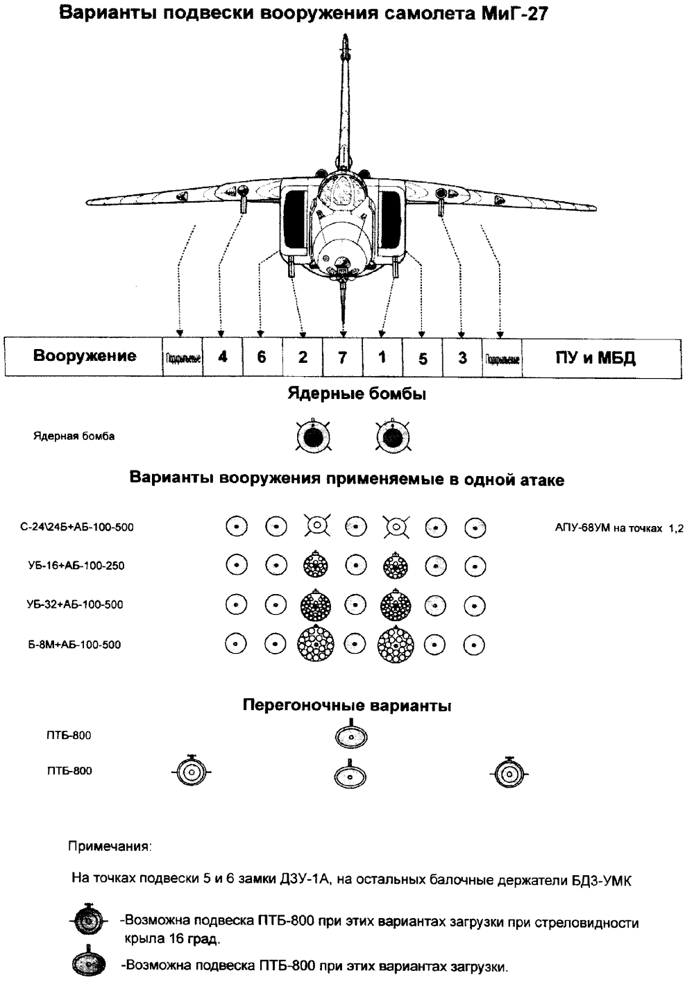

    in reply to: MiG-23/27 Questions #2539955
    martinez
    Well, those diagrams do not have enough resolution for us to read the numbers and letters, so no, those diagrams really do not help!
    Ohhh, is this not enough resolution??? What are the numbers and letters which cause you the headache?
    http://www.gamaholding.sk/test/mig27-2.gif
    http://www.gamaholding.sk/test/mig27-3.gif
    in reply to: MiG-23/27 Questions #2539984
    martinez
    So Indian MiG-27’s do not carry laser-guided weapons unless using an externally-mounted targeting pod?
    You seem to be having a hard time understanding this. The Indian Mig-27 can launch laser guided missiles only as Harry has said.
    How many of the various sized Russian bombs can the Flogger (both MiG-23M series & MIG-23B/MiG-27 series) carry?
    I’m referring to 50, 100, 250, 500, 1000, and 1500-kg sized weapons.
    Have a look at the first page of this topic, there you`ll see those weapon storage diagrams, what else you what to know??
