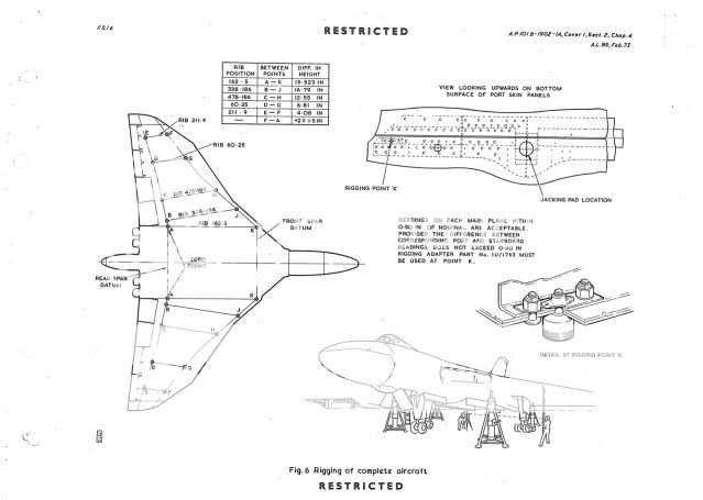

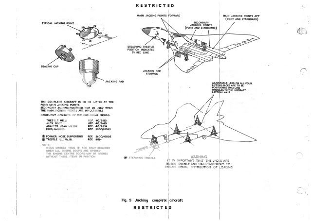

    Hi Spock and all, in case you haven’t found them yet, here are the pages from the AP showing the jacking points.
    AP-101B-1902-1A, just over half way through.
    http://i478.photobucket.com/albums/rr146/admin_vortex/AP%20for%20319/vulcan_jack.jpg
    http://i478.photobucket.com/albums/rr146/admin_vortex/AP%20for%20319/jacks_2.jpg
