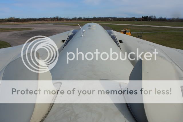

    The scoops in action, just in front of the fin
    http://i478.photobucket.com/albums/rr146/admin_vortex/Thunder%20day%202009/IMG_4988.jpg

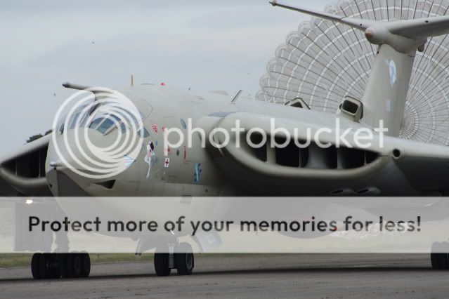

    From a different angle with the seals visible (the starboard one had gone)
    http://i478.photobucket.com/albums/rr146/admin_vortex/Thunder%20and%20fire%20warnings/IMG_6513.jpg

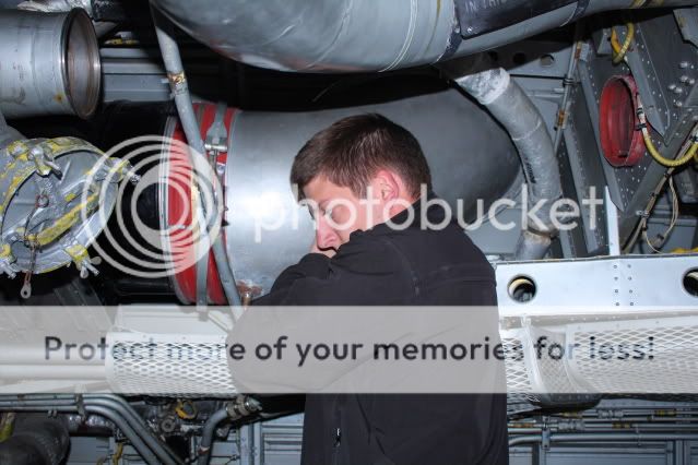

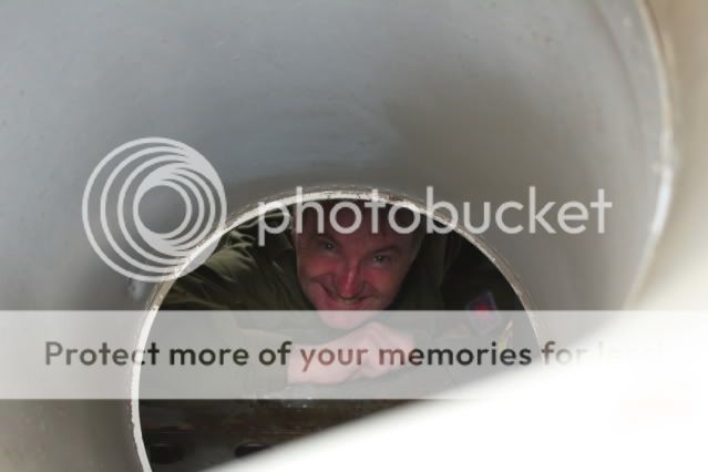

    “Victor sim” having a go at getting “the last” bolt out (it took all three of us in the end). The RAT is the big black cylinder to the left.
    http://i478.photobucket.com/albums/rr146/admin_vortex/Rats%20rats/IMG_6562.jpg

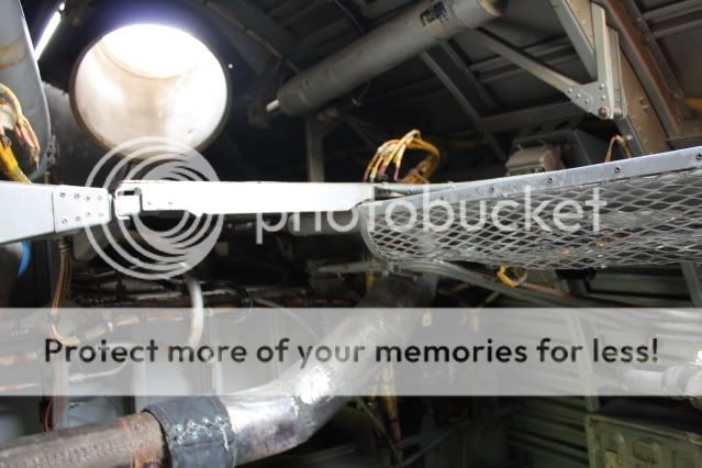

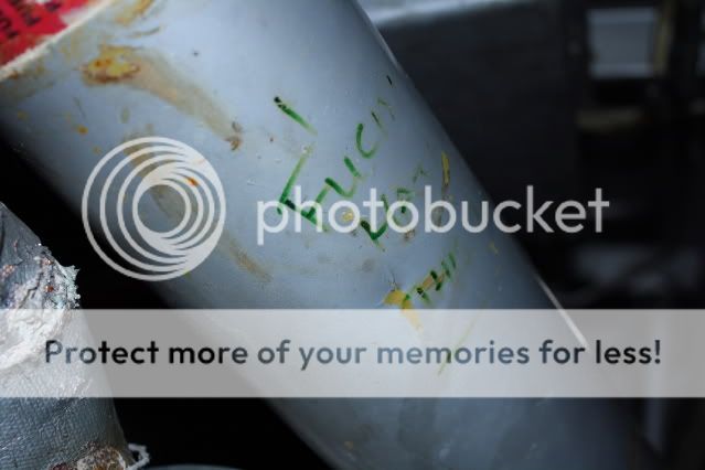

    RAF graffiti, we know how they felt
    http://i478.photobucket.com/albums/rr146/admin_vortex/XV250/IMG_6564.jpg
    Five hours later and the RAT was out, only another six steps to get to the seals
    http://i478.photobucket.com/albums/rr146/admin_vortex/Rats%20rats/IMG_6566.jpg

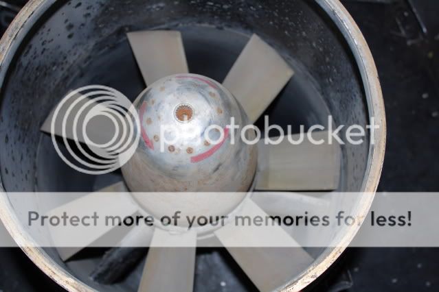

    The RAT, which will get its own clean up whilst out
    http://i478.photobucket.com/albums/rr146/admin_vortex/Rats%20rats/IMG_6576.jpg

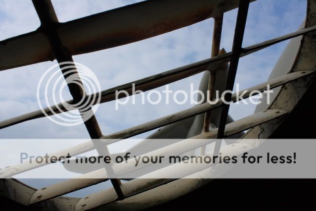

    Lindy’s new sun roof
    http://i478.photobucket.com/albums/rr146/admin_vortex/XV250/IMG_6568.jpg
