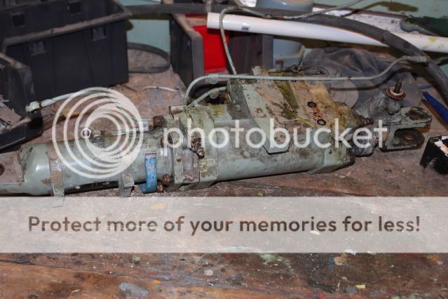

    A belated last post from last Saturday.
    Last weekend was my last at NEAM. I wish Dave and “Acid bath” good luck with the rest of her restoration.
    I finally put the no. 2 PFCU back together (almost, hopefully Ian will finish it off). Those yellow marks are leaking hydraulic fluid. There’s a good layer of paint on there.

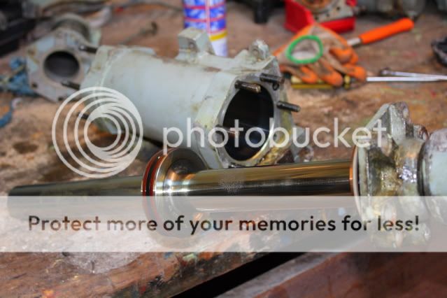

    Ian managed to open the no. 3 ram so we can lock it off. It’s pristine in there, seals and all.
    http://i478.photobucket.com/albums/rr146/admin_vortex/XL319/IMG_4597.jpg

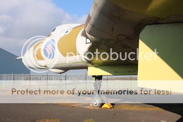

    The sun going down on 319.
    http://i478.photobucket.com/albums/rr146/admin_vortex/XL319/IMG_4603.jpg
    http://i478.photobucket.com/albums/rr146/admin_vortex/XL319/IMG_4605.jpg

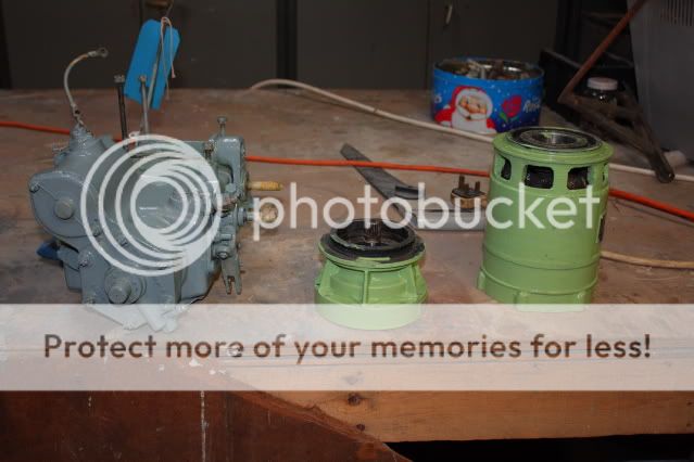

    Meanwhile I carried on with the number 2 PFCU in the workshop and it’s now all treated and painted ready for assembly.
    http://i478.photobucket.com/albums/rr146/admin_vortex/XL319/IMG_4576.jpg
    The motor case will be heading back your way soon Blue_2. I must admit to going for a “coat it as thickly as I can so we don’t have to worry about corrosion” approach rather than an award winning cosmetic job, but no one will ever see it again.

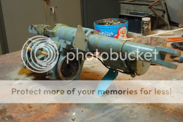

    Ian took the number 3 PFCU home for stripping. Here we’re starting to take the ram apart in preparation for locking the elevons level. Some of those nuts are a bit short, did it need a special spanner (1/4″ W from what I can tell, just very short)?
    http://i478.photobucket.com/albums/rr146/admin_vortex/XL319/IMG_4578.jpg

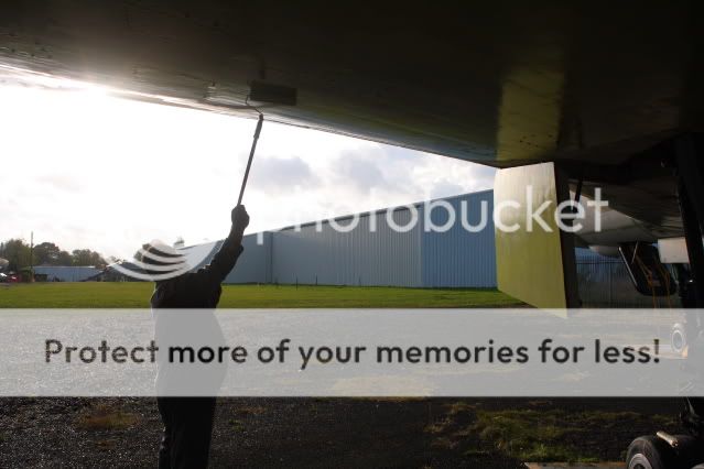

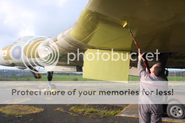

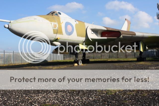

    The four regulars plus new member Adam plodded on with the repaint and we’ve now made it up to the first undercarriage door!
    http://i478.photobucket.com/albums/rr146/admin_vortex/XL319/IMG_4425.jpg
    http://i478.photobucket.com/albums/rr146/admin_vortex/XL319/IMG_4426.jpg

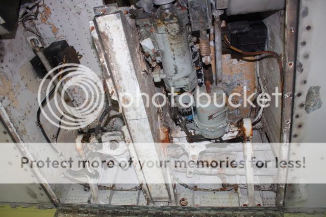

    After drilling off all the screw heads last week we managed to remove the number three PFCU for corrosion treatment and locking (reversibly) level.
    http://i478.photobucket.com/albums/rr146/admin_vortex/XL319/IMG_4417.jpg
    Two out, eight more to go. The bays will also get a bit of a clean.

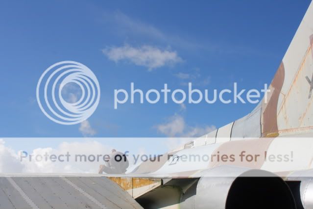

    Dave and John also found time to get up on top and try to stem the flood into the cockpit.
    http://i478.photobucket.com/albums/rr146/admin_vortex/XL319/IMG_4416.jpg
