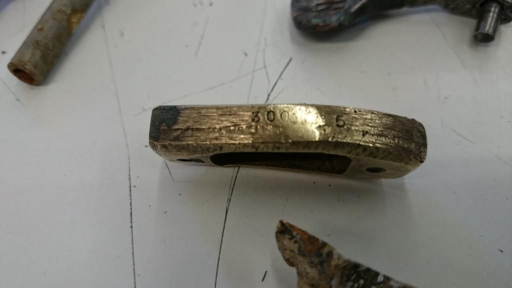

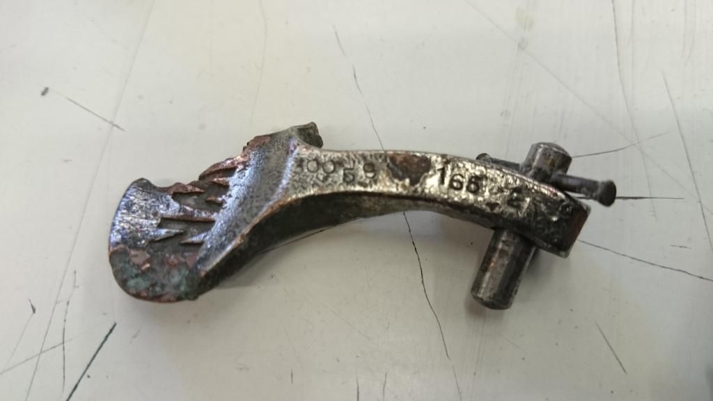

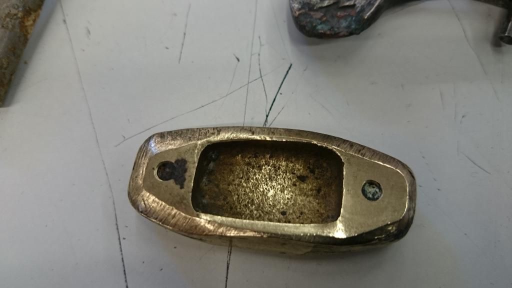

    Versuch, Concave part is part number: 30034 253 3. I thought 30034 referred to Inst panel area?

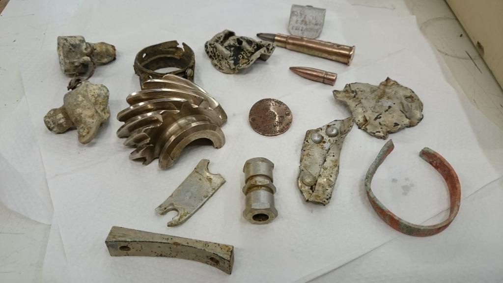

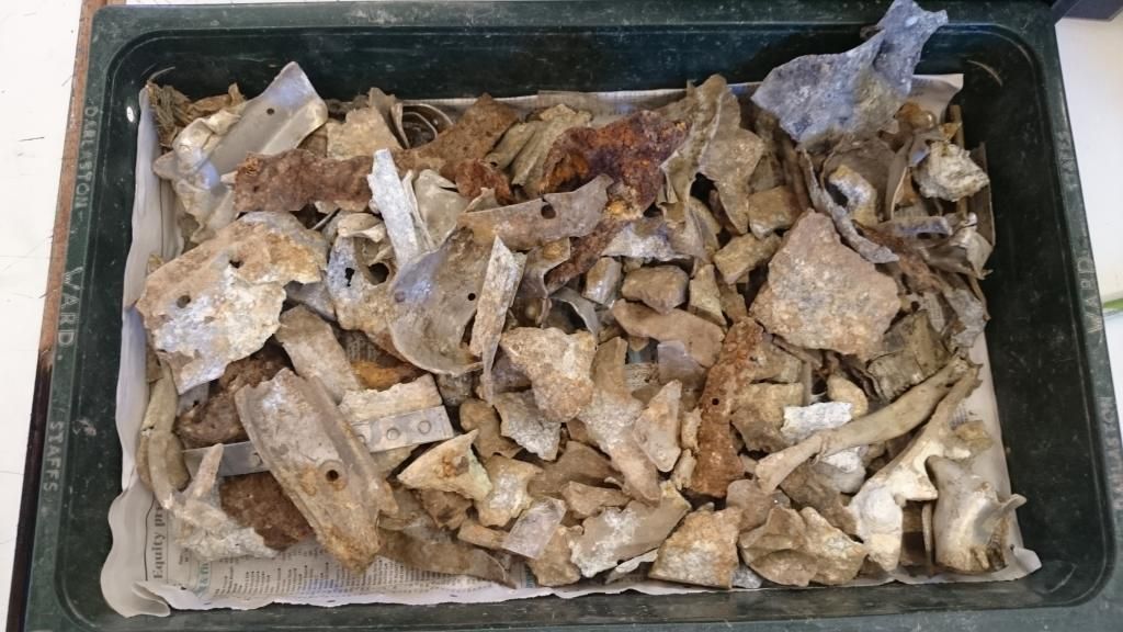

    Here’s the new pile of pieces we sifted through today. Only had time to clean up a few.  photo DSC_0062_zps0o2twxnw.jpg

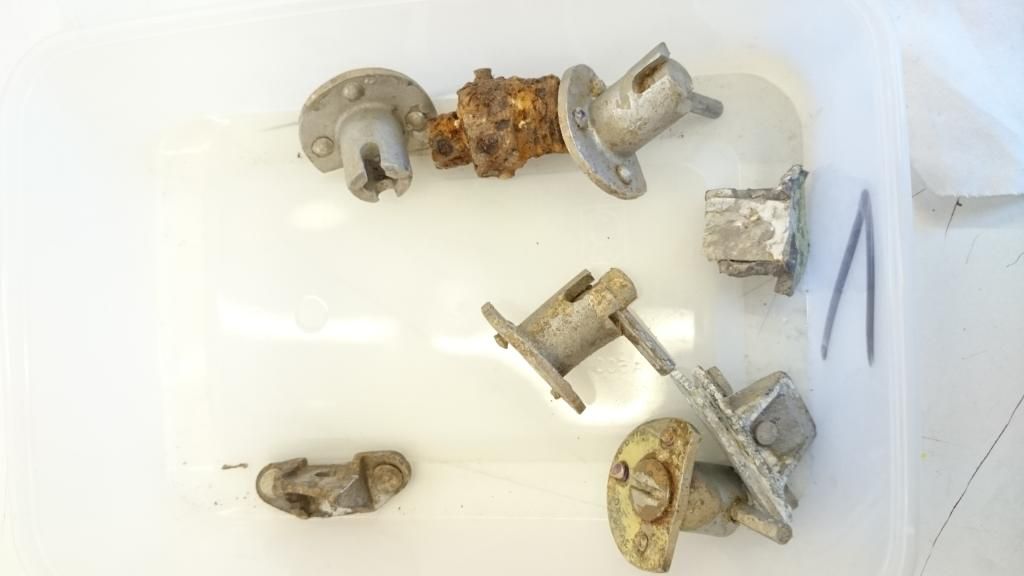

    Obviously the pegs are gone, two questions; do you think it is possible to carefully bend the slider back to straight? And is it possible to attach new pegs by drilling out the old? If all of this is possible, does anyone have an original they can take some vernier calipers to and give me accurate length and thickness? Many thanks
    in reply to: Mk1 Spitfire Build – Help Needed #852024
    AviationArtist
    So am I right in saying that this is one of the four canopy sliders? Only been through a small section of the parts we’ve been given, hopefully the other three will be among the boxes and boxes of parts we are still to look through.

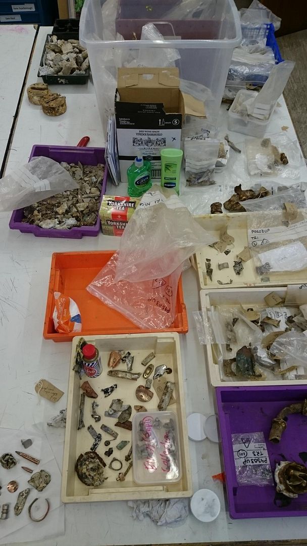

    in reply to: Mk1 Spitfire Build – Help Needed #853754
    AviationArtist
    This is what it all looks like before any cleaning. It is amazing what it comes out like after a vinegar bath and then some Brasso.

    We have literally boxes and boxes of parts, this is a tiny percentage. Following the presentation I held back and few pieces to look through whilst the rest are stored in a room quite a way away. Can’t wait to go through them all.
