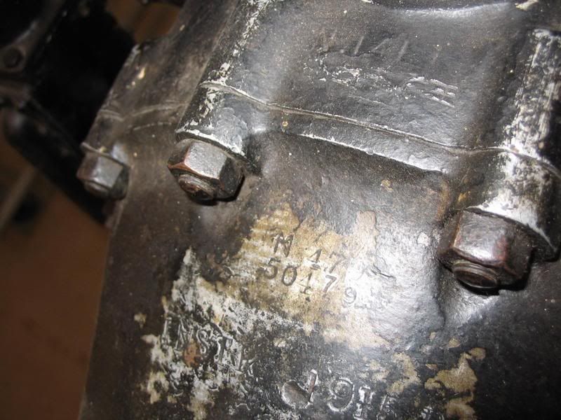

    racer2_uk
    Hi Roger, the list is looking good, the Cosford Srs. V is definately 50479 with a rebuild number added later.
    http://i70.photobucket.com/albums/i101/racer2_uk/NapierLion50479Cosfordnumbers1.jpg
    Andy
