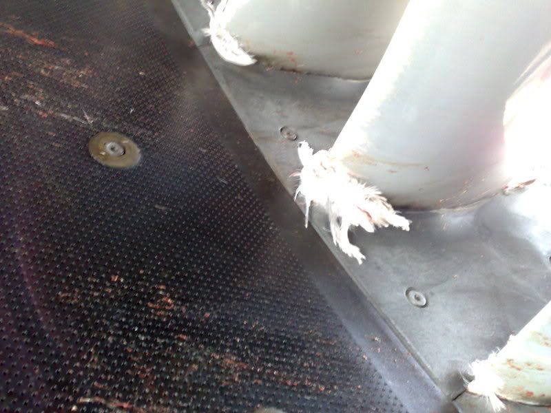

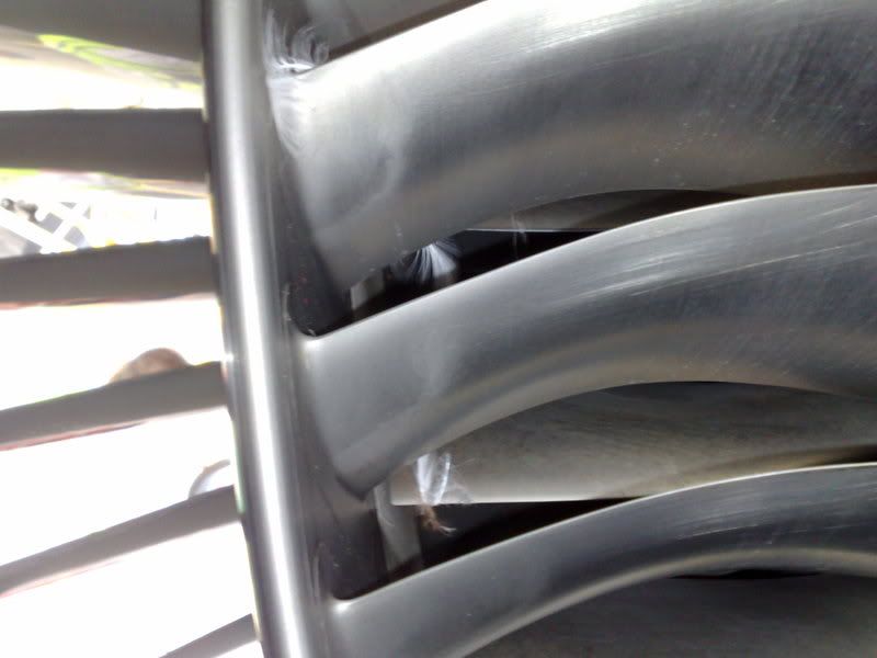

    in reply to: US1549 Downed (Merged) #584866
    Cking
    Cost.
    The mesh would have to be anti iced so that would add to the complexity and therefore the weight. Also, since MOST birds don’t fly very high and airliners tend to spend only a small amount of time in the birds flying zone the mesh would be “Dead weight” most of the time.
    Bird ingestions are actually quite rare and damage to an engine by them is even rarer. On “Big fan” engines like the CFM-56 and V2500, the fan tends to centrifuge the bird bits out and down the cold stream duct. Like this:
    http://i101.photobucket.com/albums/m63/Cking507/14092008422.jpg
    http://i101.photobucket.com/albums/m63/Cking507/14092008427.jpg
    And the maintenance manuals on some big fans say that if there is no evidence of bird down the core no further inspections are necessary.
    But if you find this
    http://i101.photobucket.com/albums/m63/Cking507/14092008426.jpg
    Now you have to start boroscoping the compressors for damage. The above example was OK, no damage found.
    Rgds Cking
