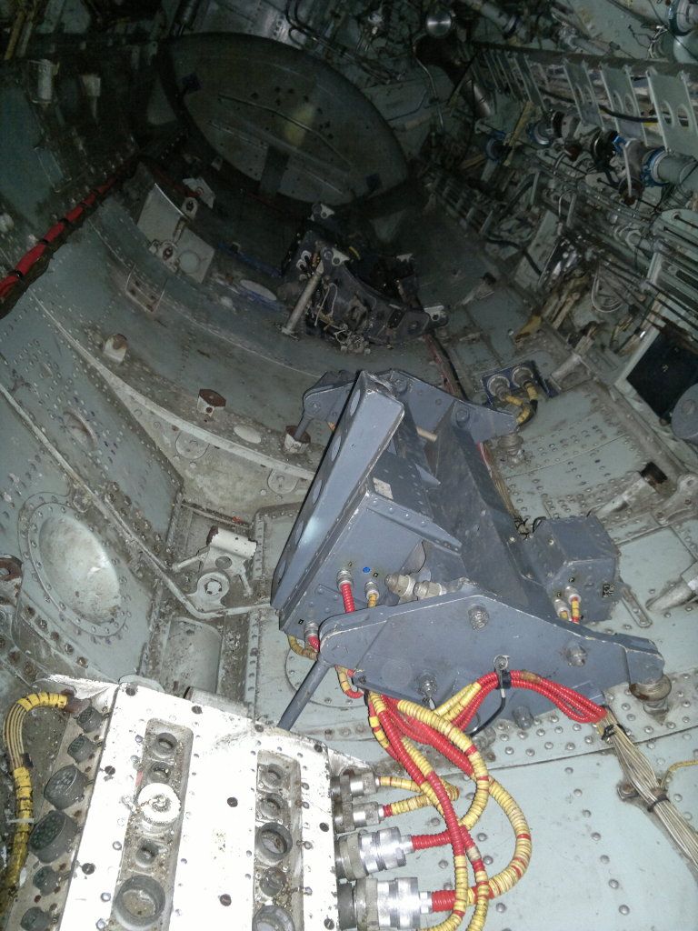

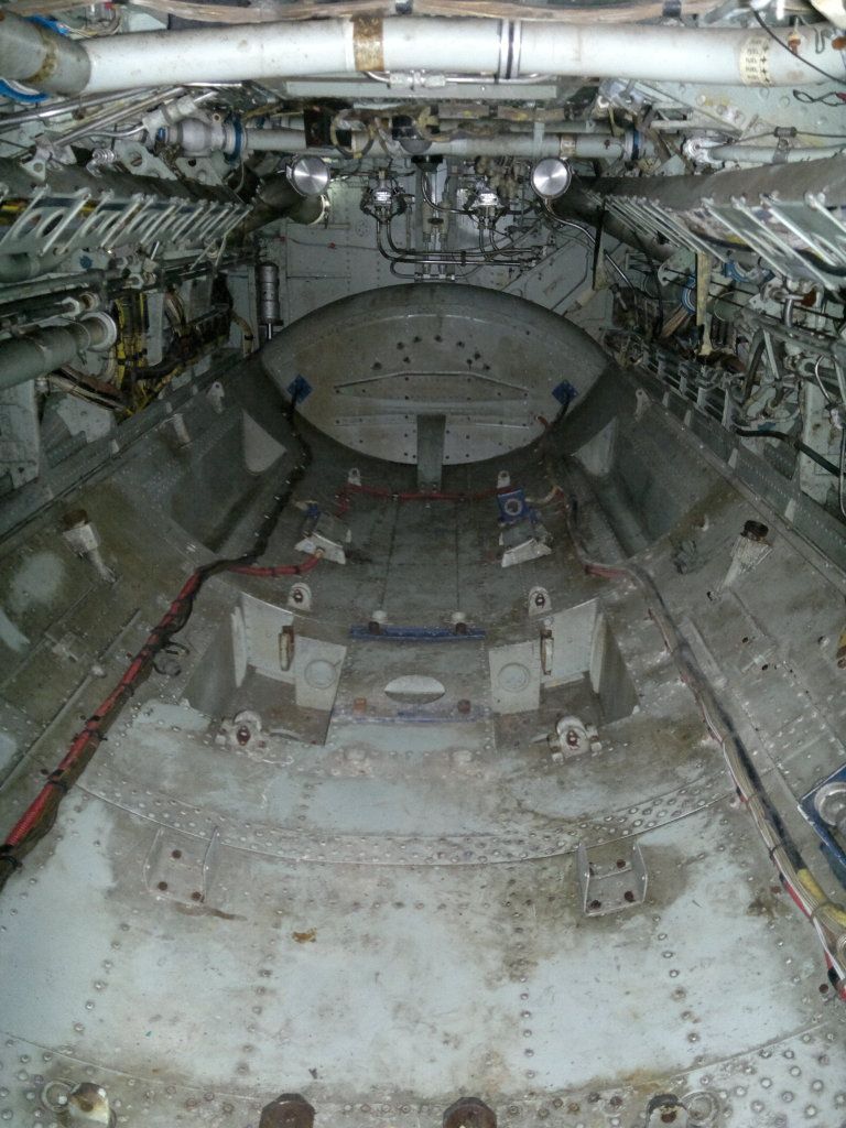

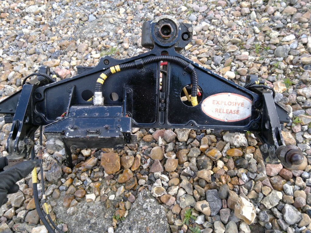

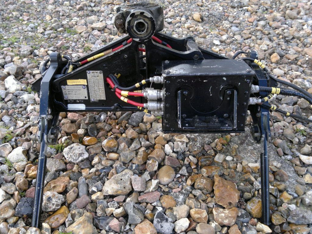

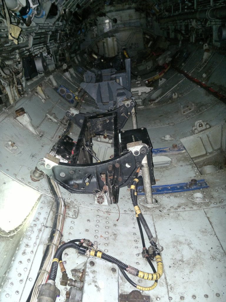

    in reply to: S.1 Buccaneer XN923 Port Gyron Junior #1071095
    D747
    Further restoration work has been carried out on XN923, following the engine change much cosmetic and mechanical work is planned.
    Last week 923 had cleaning comence of her bomb bay prior to the fitting of a full set of stbd 950 and 1000 lb bomb carriers. This was not made easy with everything having to be passed through the bay access panel due to the bomb bay hydraulics being non fuctioning at the moment as it is stuck in emergency mode, a problem being chased at the moment but with the carriers in its now looking good.
