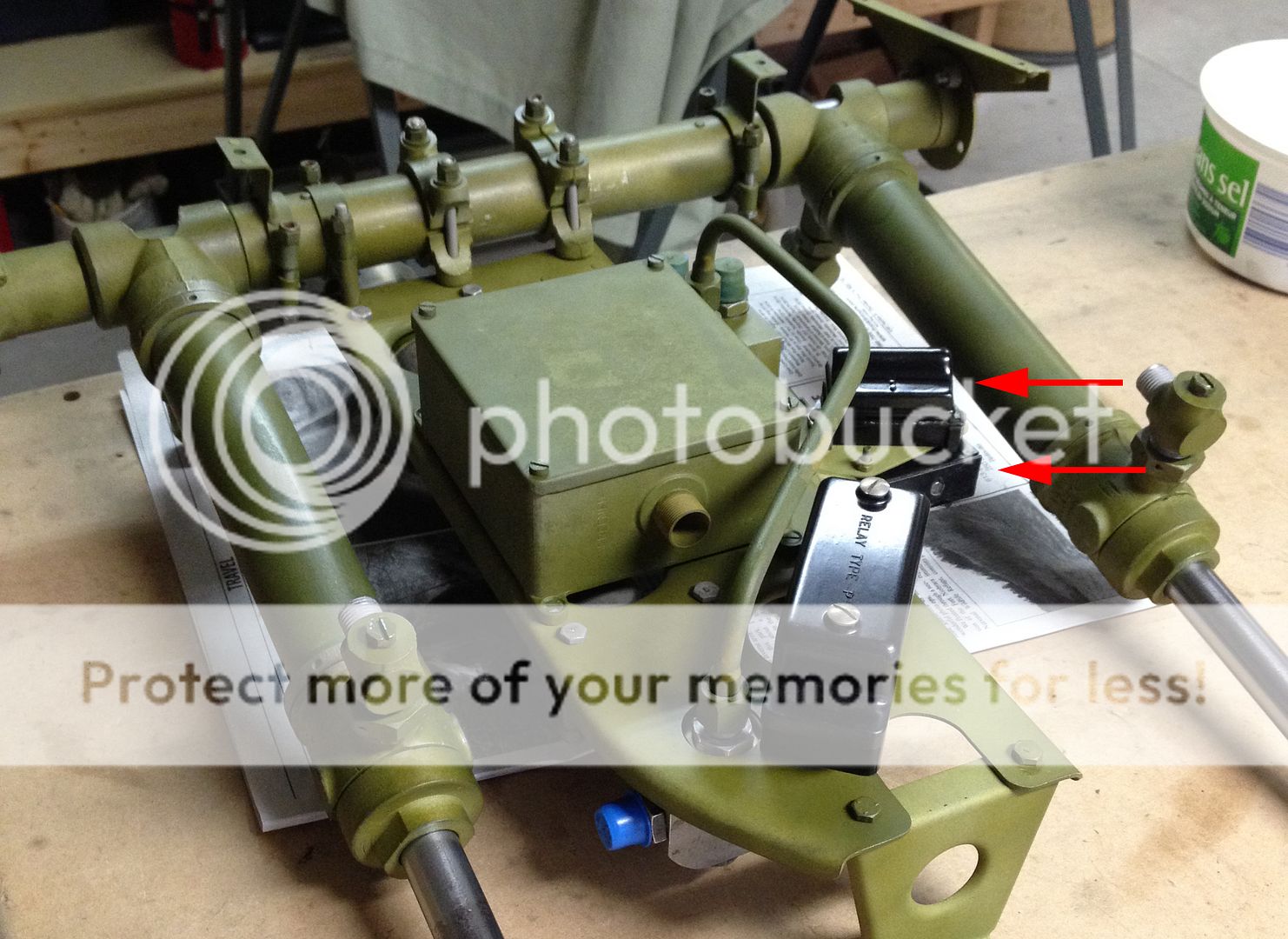

  • in reply to: Wreckage Of Lancaster ED908 (60-Z) #769945
    turretboy
    There’s also a mirco switch in the FN50 Mid Upper, it’s a part of the gun firing interrupter mechanism.
    I checked post #1260 & don’t recognize any of those parts.
    Regards,
    Mike
    in reply to: Wreckage Of Lancaster ED908 (60-Z) #770037
    turretboy
    There’s no ammunition feed system in the FN5. I can’t see why it would have a micro switch.
    in reply to: Wreckage Of Lancaster ED908 (60-Z) #770042
    turretboy
    The FN121 rear turret has a micro switch that activates the electric motor of the servo (ammunition) feed when the trigger(s) are squeezed. A fuse box is also mounted adjacent to it.
    The servo feed of the earlier FN120 turret was powered by a hydraulic motor. I’m not sure how it was activated.

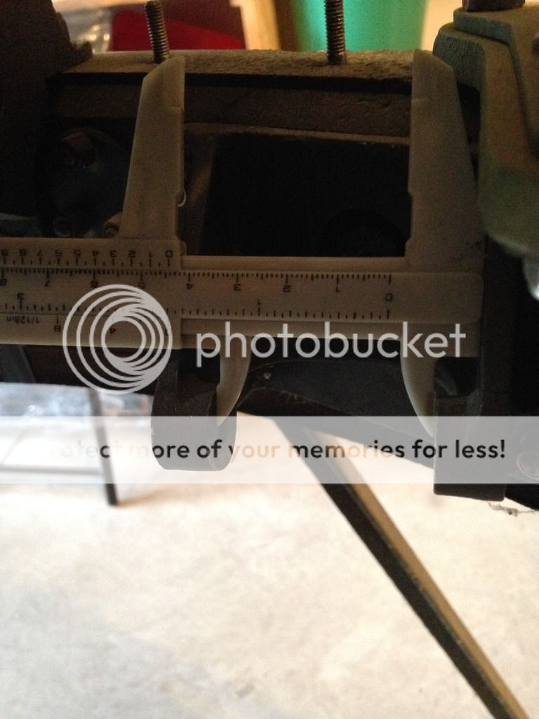

    in reply to: More Treasures(?) From The Garage… #780779
    turretboy
    Regarding the ram, here’s a few details as requested. The part number is the best I can make out. The width of the ram at the base where it would attach to the turret structure is 1 3/4″. Please note that the other end of the ram, where it would attach to the gun cradle(s) looks to have been modified at some point. It just doesn’t look right to me.
    I’m still interested in the elevation ram. Send me a PM Alan, if you’re interested in selling it.
    in reply to: More Treasures(?) From The Garage… #788754
    turretboy
    Pumps from a FN5/50/150 turret, one complete with hydraulic filters and an as yet unidentified hydraulic ram, larger than those found in the aforementioned turrets and possibly from a turret having only a single ram. Investigations continue.
    What is width of at the base of the ram? Looks like it could fit on our FN16.
    If it’s available, I am interested. Check your PM.
    http://i1025.photobucket.com/albums/y317/turret_mike/IMG_1046.jpg~original

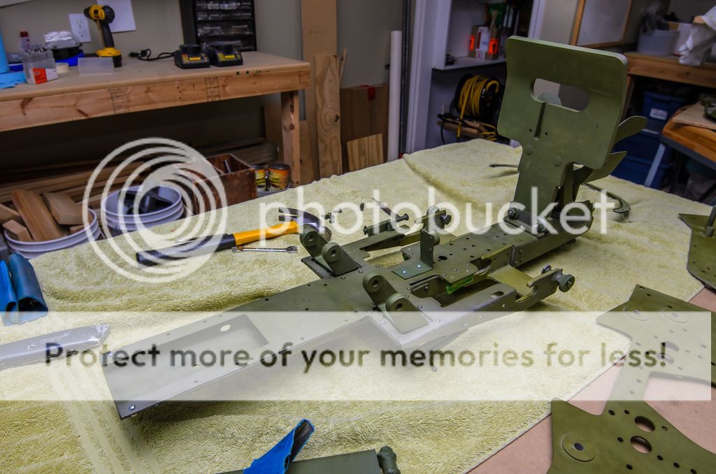

    in reply to: And Today's Mystery Object Is… #770297
    turretboy
    Nice find! I’m looking for a seat for this type of turret if you know of any spares.
    Here’s a pic of the Bolingbroke twin .303 gun cradle mount.
    http://i1025.photobucket.com/albums/y317/turret_mike/16Jan2017_9.jpg~original

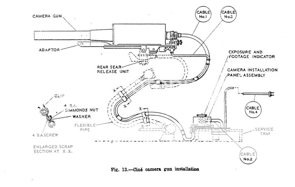

    in reply to: Lancaster tail-turret ammo load? #837692
    turretboy
    I wonder how often they carried the gun camera? All I know is that I wouldn’t want to be stuck with it.
    http://i1025.photobucket.com/albums/y317/turret_mike/guncamera.jpg~original
