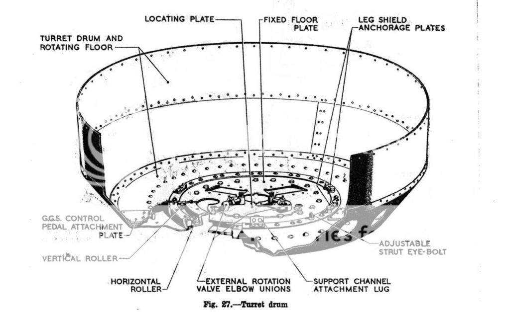

    Hi James,
    From the FN121 AP:
    http://i1025.photobucket.com/albums/y317/turret_mike/drum.jpg~original
    There are two notches in the circular centre opening that align with stationary base of the rotating service joint. I imagine the ammunition ducts & the hydraulic lines from the external rotation valve did their part to keep the floor from rotating with the turret.

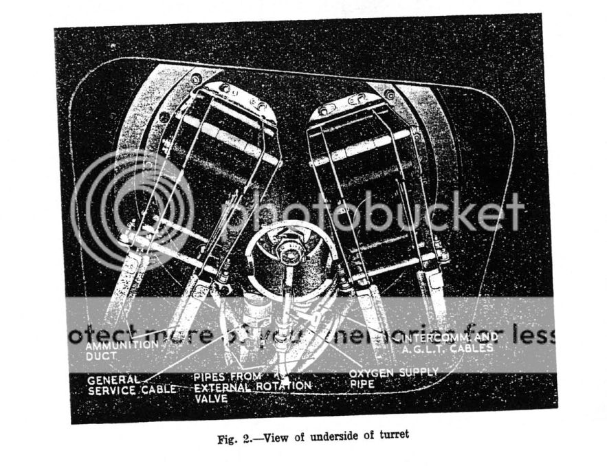

    turretboy
    The servo feed unit is a system within the turret. I’m quite sure that it was not a feature of the FN4.
    In the FN20/120 it was powered by hydraulic motor & electric motor in the FN121.
    From the FN121 AP:
    http://i1025.photobucket.com/albums/y317/turret_mike/m-127.jpg~original
    The hydraulic & oxygen services enter through the rotating service joint.

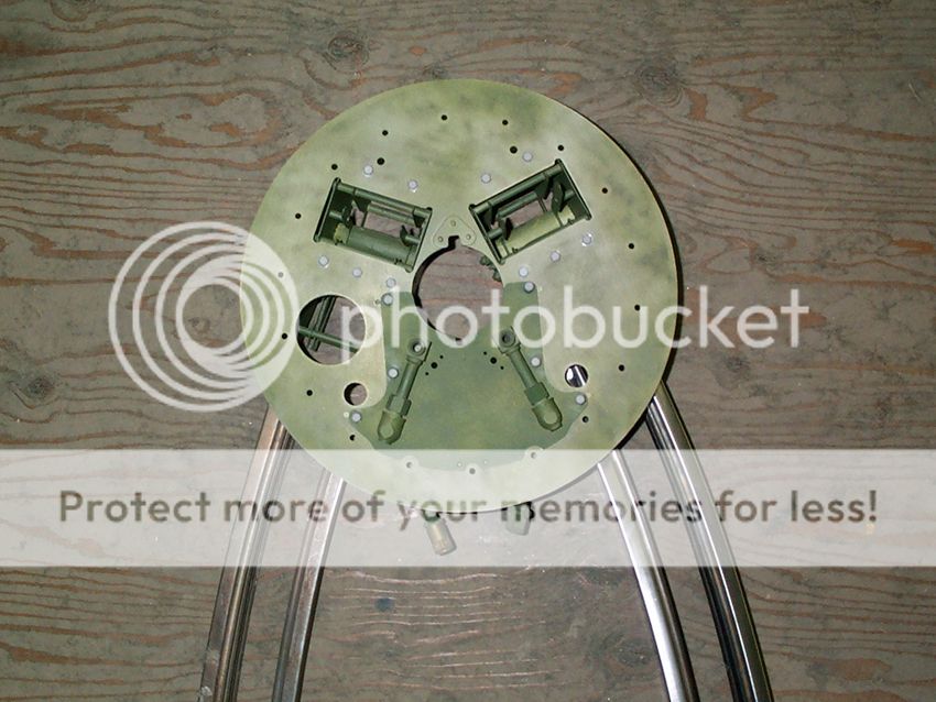

    Floor Panel – FN121
    http://i1025.photobucket.com/albums/y317/turret_mike/DCP_0696.jpg~original
    The floor remains stationary while the turret rotates about it. The ammunition belt twists unsupported in the turret before it reaches the servo unit.
    I hope this helps.

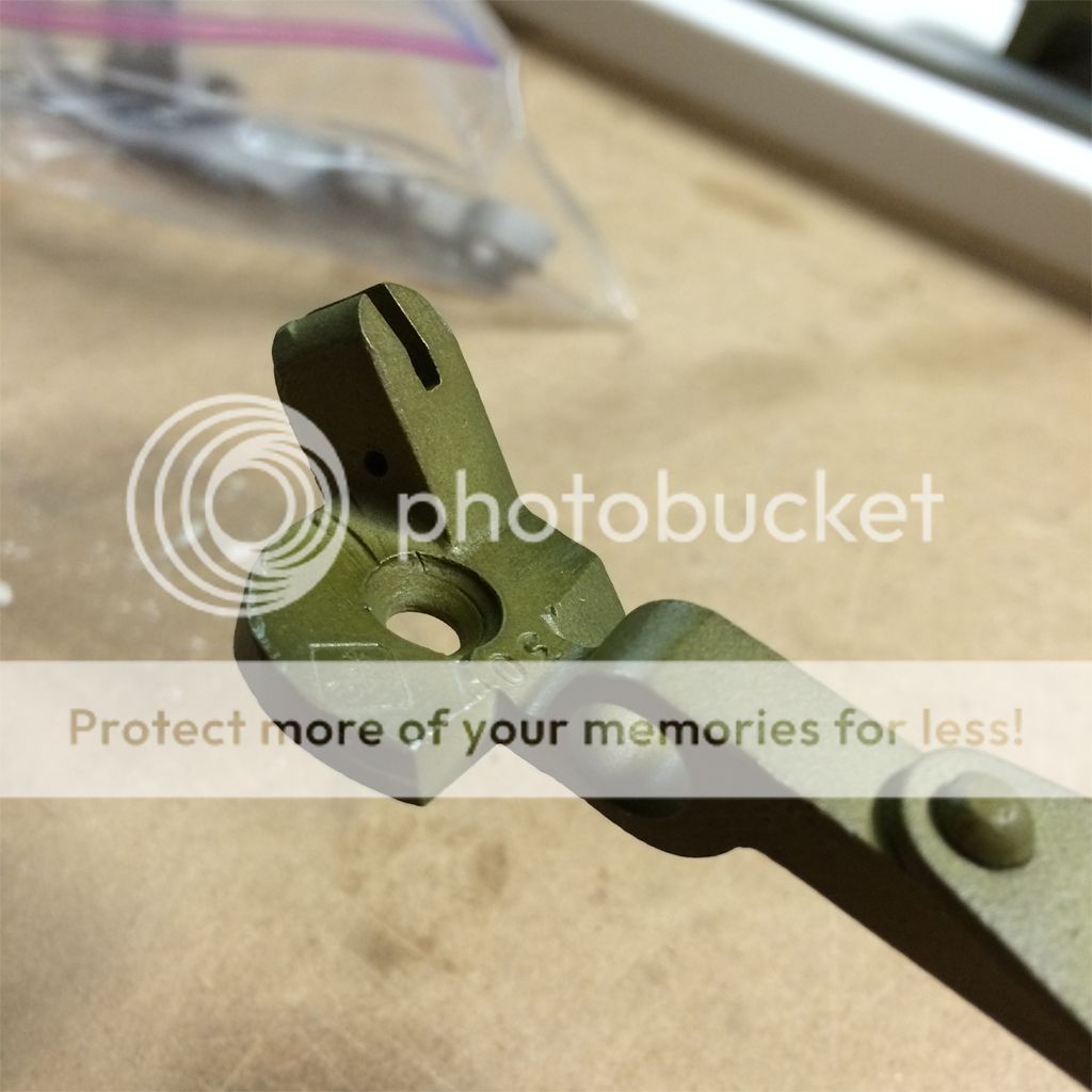

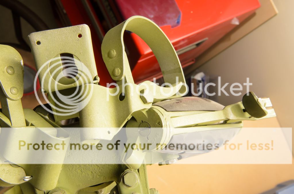

    Hi Ballturret,
    Sorry for the delay. Below are some views of the control triggers.
    If you require more, please let me know.
    Mike
    http://i1025.photobucket.com/albums/y317/turret_mike/15Oct2014_24.jpg~original
    http://i1025.photobucket.com/albums/y317/turret_mike/IMG_3088.jpg~original
    http://i1025.photobucket.com/albums/y317/turret_mike/240.jpg~original

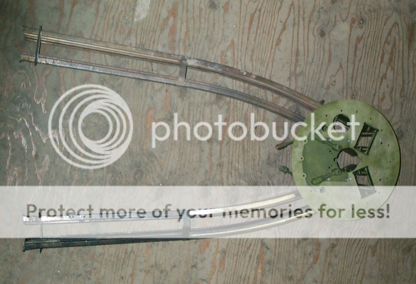

    Thank you, what an amazing piece of engineering to feed the four guns over such a distance and through a rotating turret
    What I am really after is in effect a picture of the floor of the turret itself where the ammunition feed enters from underneath. I have nearly given up as I have written to every museum that has a Lancaster in the UK and Canada had no real appreciable response and search as I can there is nothing on the net. I think ultimately I will have to just ‘guess’ how it would have looked
    Thanks again, Ken
    Your work is incredible Ken! 🙂
    Hopefully these pics we be of some help. These are for the rotating floor of a FN121 turret.
    I do apologize for the quality.
    http://i1025.photobucket.com/albums/y317/turret_mike/DCP_0695.jpg~original
    http://i1025.photobucket.com/albums/y317/turret_mike/DCP_06901.jpg~original
