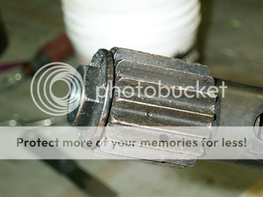

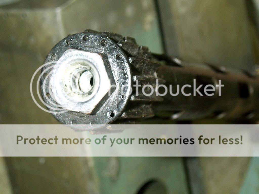

Another nice find! It’s from a FN120 tail turret with the servo (ammunition) feed control valve on the front. The FN121 used an electric servo feed motor.
I’ll try to get those dims for you.

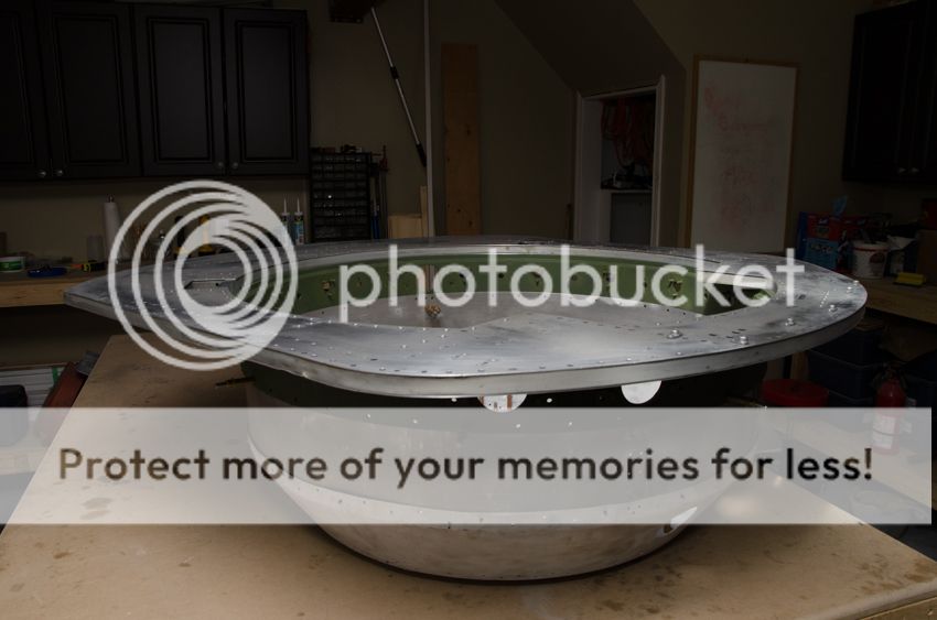

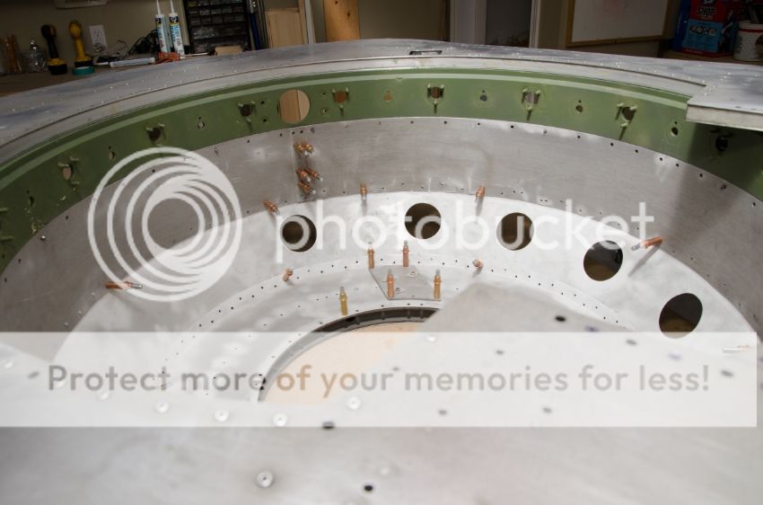

Still poking along….
Trail fitting the FN121 accommodation plate, rotating ring and floor drum.
