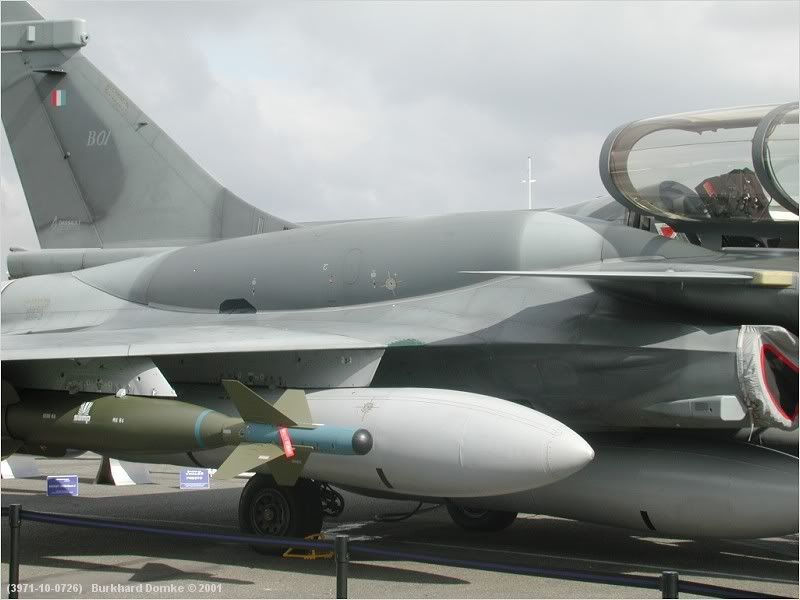

    http://i146.photobucket.com/albums/r279/sampaix/3971-1.jpg
    LIMITS: M 0.90, M 1.6 with EMPTY EFTs.

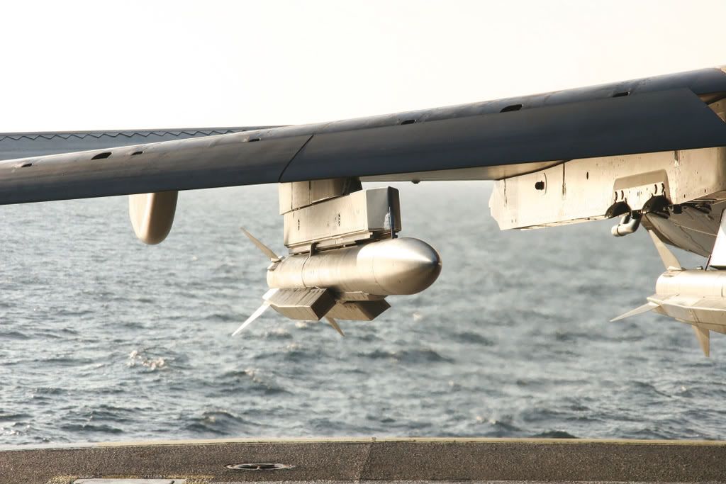

    http://i146.photobucket.com/albums/r279/sampaix/06meteor03.jpg
    M 2.0 DASH without EFT.

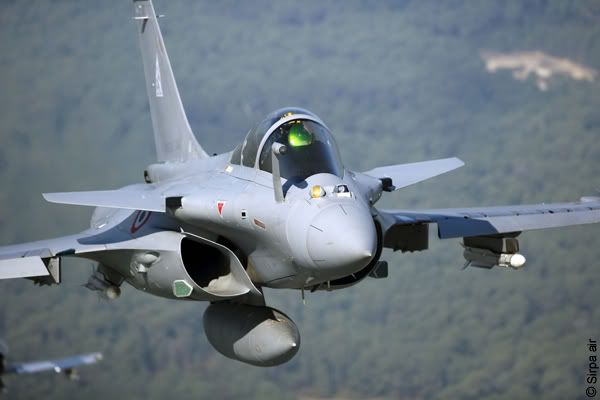

    http://i146.photobucket.com/albums/r279/sampaix/20_05_08_rafale-1.jpg
    Typical MN M 1.2 supercruise configuration, EFT are cleared for M 1.6 and 9 g.
    http://i146.photobucket.com/albums/r279/sampaix/06mica03.jpg
    Once the (NEWLY acquiered by MN for the purpose of Budy-Budy refueling) 2.000 l are jetissoned (and the AM39 fired of course); M 1,3 supersruise, look at the MICA mounting…

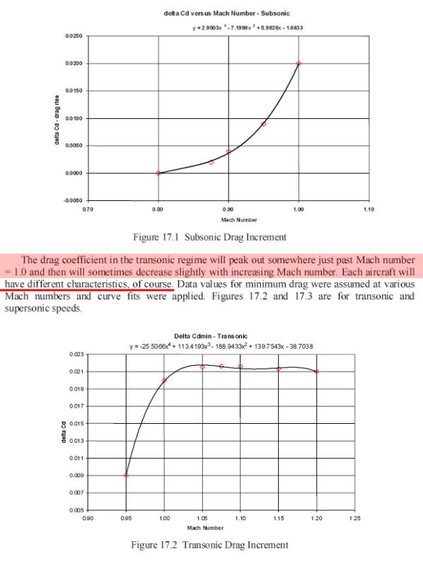

    http://i146.photobucket.com/albums/r279/sampaix/transonicdragedwardsml1.jpg
    A typical Drag Polar From Nellis AFB Flight Test Centre and from another source for F-16 below (where it shows the definition of the word “Clean” in the case of aircrafts with wingtip mounted AAMs)
    http://i146.photobucket.com/albums/r279/sampaix/F-16Cd.jpg

    From the Critical Mach point to Max Drag polar point to end of supersonic zone point, this is what happens over a wing surface.
    Note that the Mach values given are ONLY fully variables; valid for a given Thickness ratio, sweep angle and wing profile…

    LordAssap
    What equipment it is below the abdomen of this Rafale M ?
    http://img209.imageshack.us/img209/7897/2002091219mf1.jpg
    Pod RECO-NG?
