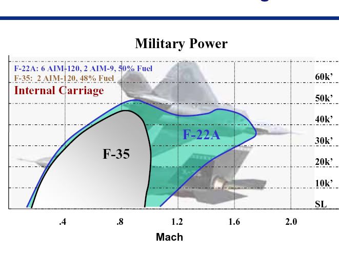

    in reply to: Is the F35 a waste of time? #2497215
    LordAssap
    http://i146.photobucket.com/albums/r279/sampaix/Flightenvelops.jpg
    Here, this one couldn’t be clearer…
    When they actualy give the Maxi in military power, there IS still an aerodynamic margin up to the DESIGNED Maximum Mach.
    NOT in FULL A-B where both engines and airfranes reaches their Maxi.
    This explains a lot of dicrepencies occuring with all aircrafts a mid-supersonic like supercruise in the red zone of engine use for example…
    This shows clearly one other thing though, F-35 isn’t going to supercruise.
    So basically the picture there requires your spin for it to be accurate for the F-22 but in the case of the F-35 it’s accurate “as-is”? You’ll also note there that it gives the F135’s power as “48,000lbs” so is that correct too?
    Officials say the F135 engine, rated at more than 40,000 pounds of thrust, is the most powerful fighter engine ever built.
    This is what they would have writen had they been given the proper datas…
    It is quiet obvious that you’re in a great need of learning a few more things boy, if Edward AFB Flight-Test Centre handbook is your definition of “spin” then i am not surprised you still can believe in Santa-Clauss.
    This picture is mostly accurate in BOTH cases and in FULL A-B the maxi are Maxis, no more power to get from the engine is there?
    BTW you didn’t comment on my quote showing possible doubts on the source accuracy:
    though some “Top Bass” from the same source was clamly saying that F-35 would out-turn a clean F-16 while in FULL A2G configuration which is according to aerodynamc laws, way off this planet’s technology level..
    OPTIMISED FOR AIR-TO-GROUND LETHALITY; Who’s spinning what here?
    in reply to: Is the F35 a waste of time? #2497232
    LordAssap
    ust an FYI that’s the X-35’s inlet not the F-35’s.
    It would make little difference and just would show they actualy used CG simulation earlier in the design stage but i believe you might be wrong there, let’s check on this shall we???
    If you’ll notice, that graph also says “Mach 1.5” for the supercruise speed of the F-22. A general who’s flown it is on record as saying he flew at Mach 1.72 without afterburner. So is the general lying or is the picture you have there wrong?
    Mate, you got to relativate a little and have a good look at the USAF definition of the word CRUISE to comprehend what SUPERCRUISE realy means, other than trying to imply they ALSO give minimum KPP THRESHOLDS for a fighter which performances are already known…….
    If they compare these datas it is precisely because they are KNOWN values including the Operational ceiling.
    You’d realised this if you had read the whole document…
    Cruising involves a <> 89% power setting to prevent engine wear, put the gaz manet to the dials and you got the difference, this is IF he didn’t use the A-B to get to this speed at all, in short it doesn’t happens everyday (Red line)…
    The USAF ALSO give the same 1.5, the 1.72 are the engine/inlet extreme limits and NO, F-22 usualy doesn’t supercruise at this speed or else your engines are going to suffer some…
    Maximas are indicated as DASH in the case of Mach, in afterburner it’s a different matter the power output is already MAXI.

    in reply to: Is the F35 a waste of time? #2497349
    LordAssap
    Just posted by Rogerout (Thanks a lot) in another topic…
    http://www.afa.org/ProfessionalDevel…Comparison.pdf
    http://i146.photobucket.com/albums/r279/sampaix/AFAORG-DATS.jpg
    MEANING: Buy half of the necessary capabilties to obtain Air FULL Supremacy….
    The european and other F-35 clients have forgoten the HI from HI-LO couple methink, though some “Top Bass” from the same source was clamly saying that F-35 would out-turn a clean F-16 while in FULL A2G configuration which is according to aerodynamc laws, way off this planet’s technology level…
    Consider: Winload+Lift Coefficient only for instantaneous turn rate, add thrust for sustained and you get the picture.
    in reply to: Supercruising #2497351
    LordAssap
    You probably means this one: http://www.afa.org/ProfessionalDevelopment/IssueBriefs/F-22_v_F-35_Comparison.pdf
    If you believe that the author is better informed on thrust number for F-35 you also have to trust his numbers for things like speed, altitude and turn rates. If they are correct F-35 has to be a real dissapointment if it can’t achieve better with so much thrust. Actually you’d better hope he is totally misinformed or at least made a typo.
    Thanks for posting this one…
    But quiet frankly, in regard to specification and aerodynamics, i am NOT desapointed nor surprised, they manage 1.6 Mach on a problematic design which considering the aerodynamiuc features (Optimised for high-subsonic) is no small feat…
    For the rest i’m very close to regard it as a catastrophic design managent…
    In the engine dpt, the maximum thrust is Opitimised for SEA level (STVOL Operation) and inlets are ALSO oprimised for maximum output at sea-level so the whole aircraft is de-facto optimised for low-altitude/high-transonic flight regimes.
