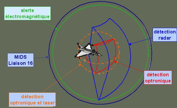

    Really? What systems except symple missile detectors do offer Europeans for spherical coverage?
    http://i146.photobucket.com/albums/r279/sampaix/DETECTION.jpg
    THIS.
    Since the event of SAMIR on the Mirage 2000 all AdA/MN aircraft HAVE a 360X360* IR detection system, SPECTRA adds EM and LASER to it.
    http://www.sagem-ds.com/pdf/en/D649.pdf
    Because DAS is more than a MLD, you know. What are those systems in the pipeline, more capable than DAS?
    I know DASS perhaps better than you do, i also know of its VMC limitations and this is what you are fooled by.
    Adding a visualisation to an IR system of this generation doesn’t make it more advanced in terms of detection capabilties in adverse weather.
