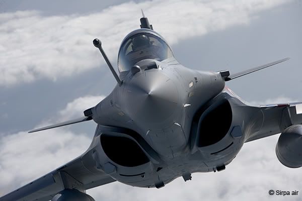

    http://i146.photobucket.com/albums/r279/sampaix/sipraRafale.jpg
    I like the detail of the speed probe laigned with the canards axis. Good photo…

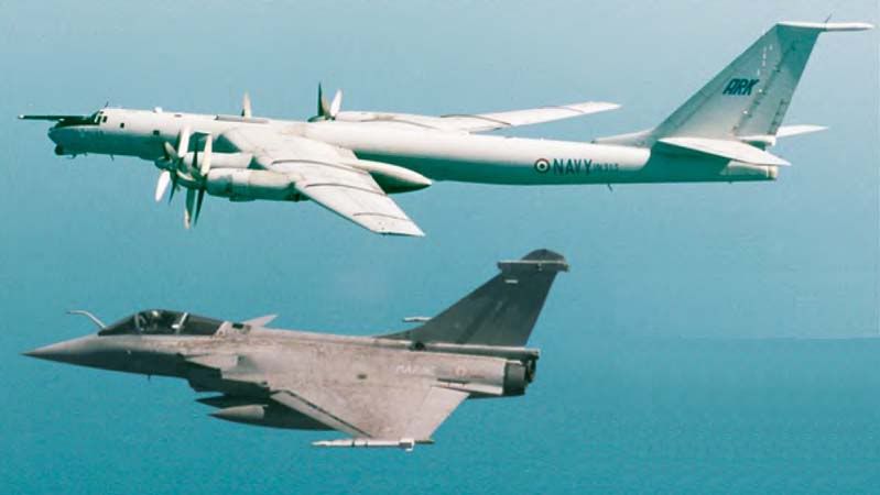

    http://i146.photobucket.com/albums/r279/sampaix/furtifrafalesmall9eh1.jpg
    http://i146.photobucket.com/albums/r279/sampaix/cdg-078.jpg
    I know it’s not the most recent picture but…

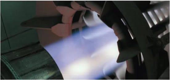

    Among the things that makes Rafale Discret
    http://i146.photobucket.com/albums/r279/sampaix/spliirjetengine110dc4.jpg
    http://i146.photobucket.com/albums/r279/sampaix/M88-2_2007_Pac_CGP-1.jpg
    http://i146.photobucket.com/albums/r279/sampaix/M88-Exhaust.jpg
    Some time ago i could go through some interesting people at Dassault-Aviation, before GIE and the security thing…
    http://i146.photobucket.com/albums/r279/sampaix/Rafale-IR.jpg
    About this picture, the programe manager for Rafale, told me that it had been taken before all hot points had been treated the same way, the avionic bay vent behind the canopy doesn’t leak such a IR signature since it was taken care of.

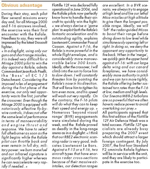

    About the topic, how is the performance of the Rafale compared with the M2000?, not always “new” means better in all aspects, the Rafale is using very advanced aerodynamics (perhaps the most advanced topology design), based mainly on the lift side, while the M2000 is based on the low drag side, any good diagram to compare the performance of both planes?
    http://i146.photobucket.com/albums/r279/sampaix/Combat_Performance.jpg
    Questions? Answers! Ask the pilots of BOTH Mirages and Rafales…
    BTW Over g, you got the point SPOT-ON about the aerodynamics of the aircrafts, only with Rafale, LIFT isn’t incompatible with low drag anymore…

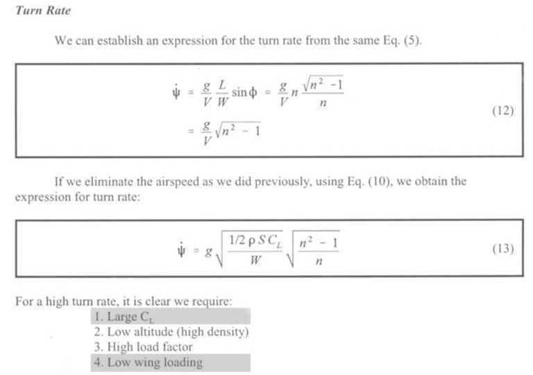

    -Where’s the cursor in reality? What are the real strong point of this plane? we just don’t know. Too many spins commited previously, too many lies!-
    Well actualy I DO. I keep saying it and i quantify my claims too.

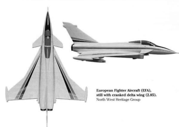

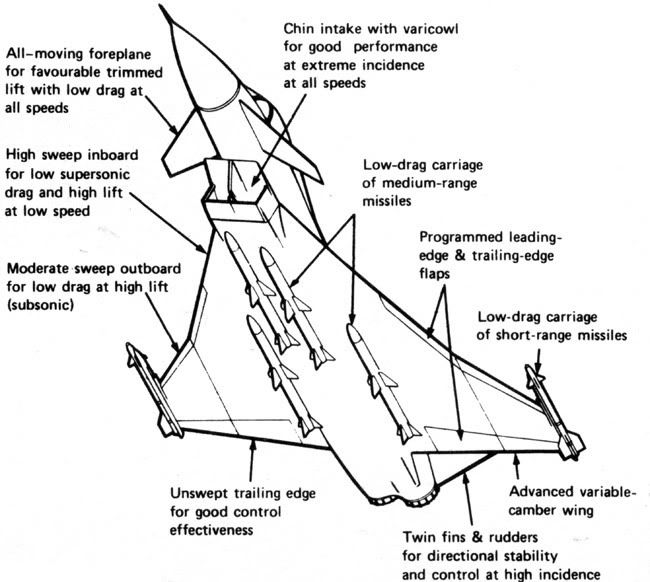

    Typhoon is designed like the Mirage 2000 for the upper right corner of its flight envelop this MEANS M 1.8/ M2.0, only 0.2 M below the Mirage upper limits with its 58* swept wing.
    This feature is designed to compress the transonic region and lower the maximum drag coefficient around M 1.0 too, which in turn means a slightly lower drag polar in supersonic.
    Drag polar being based on the overal wing surface (including fuselage area) AND sweep angle, there is MORE to it in real life…
    It is there where Typhoon is truly at ease but it doesn’t mean it makes of it a better A2A platform, it only means that it is optimised for these performances at these altitudes.
    Remembering its primary role as a high-speed/High-maneuvrability fighter, it was obvious for those who have the basis that design was always been dictated by requierments.
    Maximum Gs sustainable at M 1.8/ M2.0.
    This in turn implies; 53* sweep angle, High TWR, use of canard tip downwash for LOW high-supersonic drag (even early close-coupled canard ACA/EFA designs used this feature).
    http://i146.photobucket.com/albums/r279/sampaix/ACA-2.jpg
    http://i146.photobucket.com/albums/r279/sampaix/198520EFAa-1.jpg
    All of these design characteristics makes an aircraft optimised for high g turns above M 1.65 with a high energy recovery capability at all Mach values and LOW supersonic drag.
    Below that a Rafale will always be equal-to superior because it have design features which makes for the better transcient maneuvrability at these speeds:
    READ: It makes little difference to a Rafale pilot if its aircraft canot sustain the same turn value by 25* over a 180* turn if it can roll 90* more in one sec and point its nose at 90* in 4 sec less at the same entry speed.
    That’s 5 sec gained in the transcient zone of the maneuvrability matrix, only then we talk about energy recovery and BTW this is the same equation which won YF-16 the contest vs YF-17 which had some unique flight characteristics the Falcon could only dream of; only transcient matters at the end of the day because it is what makes the time-to-advantage-position ratio…
    This means roll rate, Pitch rate, control harmony and precision in all axis, Instantaneous turn rate, lower induced drag (Lift/Drag Coefficient), lower supersonic trim drag, High AoA characteristics, stall characteristics, AND (ZE enjoyable JAB to the-one-that-may-not-be-named) MMI.
    Yes; a Rafale pilots will be able to fly with less efforts and more precilsey at higher g.
    G-Onsets and Sustained turn rates are just 2 values among others and taken out of the matrix, individualy, have little value on their own, (expecialy when totaly missunderstood).
    Even so it might not be able to sustain Typhon’s turn rate above M 1.6 by a few*/sec in some conditions, (then again it remains to be quantified and WE have no evidences of this AT ALL) Rafale will always be able to point its nose toward a Typhoon because it posseses a higher instantaneous turn rate and is also is designed for low supersonic drag coefficient:
    THESE WERE MEANT TO COMPENSATE FOR THE CHOICE OF THE MODERATE 48* SEEP ANGLE…
    = LEX-induced shockwaves controled to offer the minimum effect to the 48* wing from M 1.0 to a value picking from M <>1.65, Mid-fuselage mounted wings with high degree of wing-fuselage blending reducing wave drag, overal LOWER LIFT/DRAG coefficient EVEN in supersonic (Hysterisis effect remains in supersonic) lower Cl shift ratio above M 1.0, NO negative transonic pitch-up moment (Transonic induced drag due to the need to correct the moment), Dynamic instability and Damping levels being high at all Mach etc.
    Obviously, these basic are “BOYSCOUT AERODYNAMICS” and doesn’t apply to Typhon (So we’ve been consistantly lead to believe) because Fonck, Gegene, Thunder have all pointed these out previously, being then duely targeted and kicked out with the help and insistance of the Typhon mafia from a few forums, (guilty of offense or not that is), you understand, credibility isn’t a question of sources or knowledge base anymore or is it?

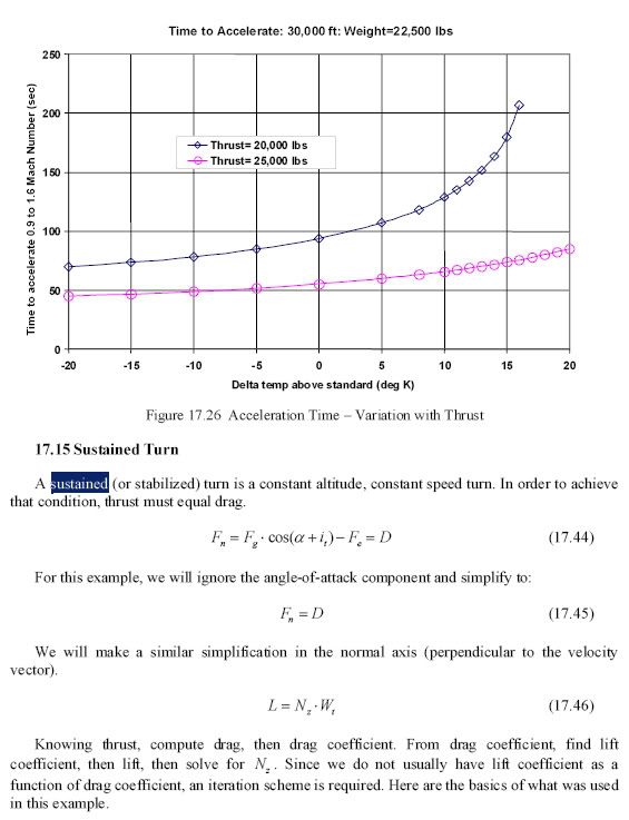

    No problem: OPIT would be a ble to tell you a lot more about engines but i’ll try my best..
    Thrust vs Drag.
    It’s all a question of balance of forces, at some point, the overal drag forces are higher than the thrust and engines, then inlets hits their own limits.
    Yes 2 X 1.250 l supersonic makes only 0.1 M difference on Rafale and the aircraft is “Stocked” at M 1.3 anyway due to its overal drag and engines pressure limits (Spillage drag).
    If you want higher military power limits you need higher engine airflow rates, these generation of engines curent limit <>M 1.3 military power and M 2.0 Full A-B is the maxi.
    We’re talking about engines fited to a shock inlet of the type “Pitot” (No mobile shock ramp or “Souris”) with a diverter as are equiped F16, Typhoon and Rafale.
    Engine compressors doesn’t have the capability to recycle supersonic airflow, thus this airflow have to be slowed-down to subsonic speeds before reaching the compressor blades.
    To achive this designers uses shockwaves, the diverters creates a mild-shock which in turn created another one at the inlet leading edge.
    These are called normal shock inlets, the limits are:
    1) Inlet pressure recovery.
    2) Engine pressure limit. (airflow rate*).
    * = 65kg/sec for M88, 75/77kg/sec for EJ200.

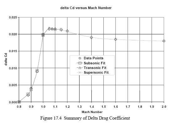

    Here is some extract of Edward’s work on the subject, the aircraft chosen are the F16 which is typical of Rafale/Typhoon inlet geometry and F15 for comparison on inlet’s pressure recovery characteristics.
    http://i146.photobucket.com/albums/r279/sampaix/65-1.jpg
    As you can see the performances of the engine falls dramaticaly with higher Mach values.
    The recovey factor polar and the Drag Coefficient polar converges and at the point where they are crossing you will find the absolute Mach limit, the airfrat will NOT go any faster.
    To reach a higher Mach, you will need either a lower inlet pressure for x Mach value, obtainable by creating more shock.
    This is achieved with multi-socks ramps or “Souris”.
    In the case of Rafale/Typhoon the only solution is to increasee the airflow rate so that more air can be recycled.

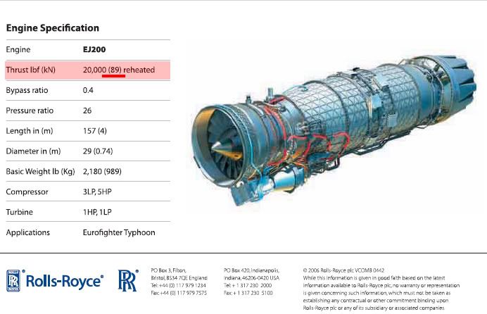

    So much claims with such limited knowledge of the basics.
    The thrust of an engine is of small intrest at supersonic and at height, because the mayor part did come from the inlet- and outlet-system at first.
    Such thrust can not be linked to the static data at ground level.
    For that reasons informed people do speak about mathematical thrust at best.
    Informed people like those working at the DRYDEN centre or Eglin AFB fkight-Test Centre perhaps?
    I think they know WAY more than you mate this is why i actualy dont bother with your informarions and get theirs instead, if you had bothered you would know that they often start with static figures then compute vs test conditions.

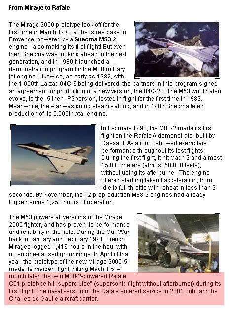

    About S-C from SNECMA with LOVE…
    http://i146.photobucket.com/albums/r279/sampaix/frommiragetorafale5lv-2.jpg

    There is MORE to turning performances than TWR, LIFT is what makes an aircraft turn first thing and with delta wings, even more so delta-canards there is a lot MORE to be said about it.
    Superior Cl makes for a SUPERIOR INSTANTANEOUS turn rates as proven by the Mirage 2000 vs F16 experiences, regardless of TWR.
    To SUSTAIN a turn one needs not only THRUST but also LIFT and lower Drag Cf, Rafale aerodynamics offers this to its pilots.
    http://i146.photobucket.com/albums/r279/sampaix/WithLoveFromEdward.jpg
    Source: USAF Flight Test Center Edward AFB Handbook.
    There is NO point trying to argue otherwise; this is truely and well documented, to compute a SUSTAINED turn rate you NEED a LIFT Coeficient value but also a DRAG coeficient.
    A Close-coupled canard have SUPERIOR lift/drag ratio than a long moment harm during the whole of the turning phase and this at any speed/Mach/AoA.
    NOT denying Typhon forte’s i am just remembering those who forgot or doesn’t know what the aerodynamic and physics laws are about and Typhoon like every other aircraft answers to these laws.
    Typhoon aerodynimcs are optimised for high-g turns at M 1.8/ M2.0, Rafale for M 1.6/ M 1.8 (48* vs 53* sweep angle delta).
    It owes its performances to a very high TWR and engine optimisation for this sort of speed/altitude, but it doesn’t make its aerodynamics better suited to turning performances quiet the opposite.
    This is ALSO well documented:
    NO hysterisis effect = NO DYNAMIC instability = NO movement forward of the Neutral point = 4* Up elevons at M 1.8 and a lift/drag coeficient down the gutter.
    From 0 kts to M 1.5 i would rather be flying a Rafale than a Typhoon based on aerodynamics optimisation only because BTW there have never beed an A2A engagement taking place at M 2.0.
    It all happens between M 0.9 and M 1.6 (Vaste majority), if you need to point your nose AWAY from the threat FAST you’re better of a lower Mach than 1.8/2.0 where your turning radius is the size of Scotland (or almost) even at 9 g.

    http://i146.photobucket.com/albums/r279/sampaix/Turn_Rate.jpg
    Large Cl (LIFT)*
    Air Density.
    High Load Factor *(Structural)
    LOW Wingload.*
    * = Rafale is better.

    NOW, MORE FACTS.
    MAY 2000.
    -Industry sources say the MoD is studying various options for adapting thrust to generate potential savings by reducing spares and maintenance needs. “They are examining this as a means of saving money in the short term,” says a source close to the MoD.-
    -Any change to the thrust rating could be achieved through software changes and would be easily deactivated if required, for example during conflict. A decision to derate the 20,000lb-thrust (89kN) EJ200 would probably raise concerns, however, over the quality of Eurofighter training available to RAF pilots.-
    DATE:16/05/00
    SOURCE:Flight International
    UK seeks Eurofighter savings
    Andrew Doyle/MUNICH
    RESULT:
    http://i146.photobucket.com/albums/r279/sampaix/R-R-EJ200.jpg
    -one sided or outdated sources.- (?).
    Your sources Mr S are dated from 1997 to 2000.
    http://www.eurofighter-typhoon.co.uk
    -In May 2000, MoD was “studying various options for adapting thrust to generate potential savings by reducing spares and maintenance needs”.-
    In 2008 R-R gives EJ-200 for 89 kN.
    As EJ200 higher thrust with a reasonable life-span and TBO…

    From EAP-to-Typhoon design changes and requierements:
    -The original cranked delta planform, seen on the EAP, was replaced by a simpler plain delta when supersonic agility requirements were relaxed. Foreplane size, determined by the degree of pitch instability needed to provide the agility required, was reduced.-
    DATE:16/06/99
    http://www.flightglobal.com/articles/1999/06/16/52567/coming-together.html

    On Close-coupled canards effects on turn rate:
    -The canard configured Mirage III presents a great improvement in low-speed maneuvring and INSTANTANEOUS turn rate.-
    DATE:14/12/85
    Canard Mirage on test (Archive)
    By Test Pilot Walter Spychiger
    No link (Archive PDF, type title on F-I search engine).

    [QUOTE]Mach 1.4-1.5 has been “verbaly” stated and reported for some time now and the eurofighter website just recently stats mach 1.5 as possible supercruise speed. What has been consistently said is that this is a max figure, not necessarily sustained for longer periods and definitely not in an operational configuration! QUOTE]
    POINT IS: Upper LIMIT for airframe IS (Whatever engine you could fit to it right now) M 1.5.
    EJ Pressure recovery LIMIT Dry = M 1.3
    Max Mach in BOTH Military power and FULL A-B are deternimed by airframe aerodynamics and engine/inlets pressure recovery characteristics, NOT by verbal whatever simulated records.
    And BTW Rafale with 4 AAM supercruises at M 1.3, M 1.2 with 4 AAMs and 1 X 1.250 l tank. source Dassault-Aviation programme menager at the last Paris Air show.

    Rafale A could fly at Mach 2.0 with the AB only on the GE (stated on the Dassault site, i don’t have the link). This means that the M88-2 is ok with those speeds in supercruise.
    I’m afraid NOT TMor, it only mean Rafale A didn’t need 2 X 75 kN to reach M 2.0.
    The M 88 was certainly NOT providing more than 50 kN MINUS the percentasge of pressure loss associated to the excess Mach and altitude.
    I wouldn’t dare saying M 88 pressure recovery is much higher than that of EJ200, rather the opposite since it is designed with lower limits and have alower frontal thrust.

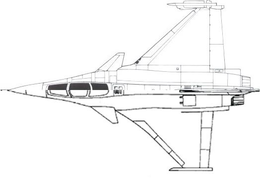

    -Did the Rafale A have higher TWR and performance e.g sustained turn due to the extra thrust and more cleaner profile?-
    Rafale A aerodynamics were totaly different even so it looks like the SAME aircraft, it was from the previous generation of design phylosophy like the EFA/ACA/ACF.
    First of all, i was a larger aircraft even so it weight was 9500kg like that of the actual C/D, M.
    Its wing were positioned at the upper limit of the inlets, and its surface was a crancked delta.
    Improvements in design from this one to the serie aircraft are numerous but to quote only a few:
    Wing repositioned lower so that a LEX could replace the crancked wing plan.
    http://i146.photobucket.com/albums/r279/sampaix/c01hybridkn3-1.jpg
    The advantages are obvious:
    LEX increases LIFT at high AoA but also, those of the serie Rafale, they are designed to reduce supersonic wave drag at around M 1.65, where the 48* delta would needs it compared to the previous wingplan.
    It works very much the same way as diverters on a pitot intake creating a mild-shock at the LEX-wing junction.
    This changes the way shockwave pressures are distributed over the wing from M 1.674 and helps reduce wave drag.

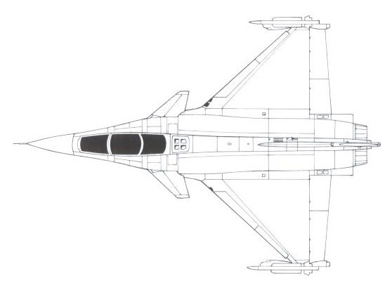

    Then the small matter of the canards:
    Their surface was increased by 30*, since their axis are rooted BEHIND the inlets they do not suffer from zone pressure drag as was the case for EFA.
    More to the point, their root and tip vortices realy works well with the whole main wing vortex as they are situated both sides of it.
    http://i146.photobucket.com/albums/r279/sampaix/rafalesaserieprofilesuppp0.jpg
    This drawing is obviously NOT scaled…
    With the crancked planforn there was no such a large gain due to the distance between the canard root vortex and the crancked vortex.
    On the serie aircraft, the canard vortex energises BOTH that of the LEX and both root and tip vortex energises that of the main wing.
    http://i146.photobucket.com/albums/r279/sampaix/Vortex-1.jpg
    Here you can SEE for yourself the wing MAIN cornet vortex, the other, weaker vortices are NOT visible (LEX Root, Canard Root and tip) but from the canard surface root and tip, they hit the upper wing well passed the leading edge and energises BOTH the LEX and main wing vortices.
    A cracked delta got a problem at supersonic speed, the two part of the wing have a Cl shift of different amplitude, which creates lateral instabilities.
    With a straight delta the problem is solved.
    Serie Rafale make full use of Compressive and Expensive shockwaves, particularly in the canard/intake area.
    This is meant to keep the hysterisis effect due to canard-wing surfaces to the highest level possible, thus retain the resulting DYNAMIC instability.
    This means that as opposed to Typhoon a Rafale still retains a neutral trim drag in supersonic, no need for elevons compensation due to pitch-down moment.
    In short, the characteristics of the A were improved on:
    High Max AoA was quasy doubled from 45*to passed 100*.
    HIGH INSTANTANEOUS TURN RATE was increased.
    HIGH SUSTAINED TURN RATE was increased.
    Acceleration at all speed was inproved.
    Trim drag, wave drag, induced drag were reduced.
    All of which with a wing surface reduced from 47m2 to 45.70m2 and the same empty 9500 kg weight for the C.

    -Ok I understand that the AdlA quoted that the M88-2 is adequate.-
    So does MN but you obviously ommited to read the 12F pilots comments.

    So EADS techs saying to F-I that Typhoon close-coupled canards DIDN’T work with Chin-mounted intakes, that Typhoon requiers 4* elevation in elevon pitch-up in supersonic, that its percentage of instability is 8%; these ARE MY dodgy claims are they?
    Surely NASA/DRYDEN, SAAB, Dassault, EADS, BAe, Thales are all BIASED anti-Eurofighter and conspired together to prove the long-moment harm canard formula inferior did they?
    Ho also, the long-moment harm was chosen for its superior aerodynamic characteristics (accoding to YOU and TPs) no?
    A BUMP of 6* AoA and 4g pith-up moment between M 0.95 and M 0.975 is a sign of high level of DAMPING is it?
    Risks of DEPARTURE below 50 kts EAS is a sign of good low speed flight characteristics is it?
    Let US guess, this is of course only due to inacurate air data sensors isn’t it?
    “Still some minor transonic pitch-up”…
    = FCS doesn’t solve everything.
    = A better design would.
    http://i146.photobucket.com/albums/r279/sampaix/IMG_0210-2.jpg
    NEXT; they reposition the canards where the strakes are and name the new design Raphon.
    HO NO, i forgot the intakes are in the WAY…
    Pitty history proves YOU wrong AGAIN (And again) (And again) (And again) (And again) (And again) (And again).

    SO, let’s get REAL just to SEE what you are realy made of shall we?
    You’re more than welcome to bring your “superior” knowledge to the debate at the level where i actualy managed to lift it, and prove your points by due technical demonstrations.
    http://i146.photobucket.com/albums/r279/sampaix/flat.gifOOOOOOOOOOOOOOOOOOOOOOOOOOOOOOOOOOOOOOOOOOOOOOOOCH!
    Don’t worry, we dont expect you to even try.
    You simply aren’t this sort of “professional” writer, you’re WAY too WEAK on the subject of aeronautics, being self-intoxicated by your own propagandist and desinformative vision of a “reality” populated by an army of ghost TPs.

    3. A USN pilot’s (Lt Mike Tremel, pilot of VFA-31 “Tomcatters”) comments for Rafale M:
    “A highly maneuverable fighter with an incredible capacity to point its nose in every direction in the sky.”
    An indication of the acuracy of my posts on the subject of Rafale aerodynamics isn’t it?
    The Super-Hornet IS the aircraft of reference for high AoA simply because it have a relaxed FCS which allows for the highest levels of nose pointing and AoA sustaining of all fighters in service today.
    The very fact that a S-H pilot can describe Rafale’s nose-poining capabilties as “incredible” speaks for itself, and we’re talking about the M with 696 kg weight handicap to the Cwhich SHOULD be the reference comparison for any other non-naval aircraft…
    “The French pilots seem to be happy to its flight performance and its modern cockpit design”.
    Well they have every good reason for this.
    W
    hen asked if he would like to swap his Super hornet to a Rafale –> “No, I love my Super Bug way too much….”
    Of course they would, every pilot in the world got something for their own aircraft even the Mig21 pilots does love theirs.
    4. A French pilot’s (pilot of 12F) comments for F/A-18E:
    “A great bombing aircraft, but not a fighter for dogfighting.”
    LOL. End of comments.
    “Its acceleration capability in the high angle of incidence is not good.”
    Same here speaks for itself.
    “Rafale is definitely the more nimble one.”
    Definitly.
    “However, F/A-18E has already equipped the JHMCS + AIM-9X, a combination of decisive edge in close-range encounters ~ Although the tactics to counter it have existed now.”
    Of course we’re now talking systems and weapons; this is another subject…

    -For times when a quick sprint is required the Typhoon can employ reheat with an upper (design) limit of Mach 2.0.-
    -upper (design) limit of Mach 2.0-
    NOW PLEASE, LEARN A LITTLE MORE ABOUT THESE AIRCRAFT, ENGINES, AERODYNAMICS, SYSTEMS. ENGINES etc…
    Fanboy dreamland:
    T2 Upgraded computers.
    NOPE, only the processors were upgraded.
    FULL INTERNAL FUEL, 2 x 1000 l DROP TANKS + 4 x ASRAAM + 4 x AMRAAM reaching 40k ft in 90 sec.
    Called ZOOM-CLIMB, this performances requiers the aircraft to be near-supersonic before pulling up a RAfale CAN do exactly the same in similar configuration (Endurence/weapon load) and circumstances.
    Rafale’s performances are inferior…
    Rafale Ms pilots give the known performance “from the deck” = from 0-140 kt; the two aircrafts climb rates are similar from 0 kt/0 ft, Rafale C perfs shouldbe slightly higher due to a lower empty weight (696 kg).
    “Concurent aircraft” CAN Supercruise at M 1.5.
    NOPE: This is an simulated AERODYNAMIC UPPER LIMIT for the airfame itself, as for the engine its upper pressure recovery limit IS M 1.3 today.
    Once at altitude Rafale M can stay up for TWO hours supercruising at M 1.2 with 4 AAMs and 1 X 1.250 l.
    “Concurent aircraft” datas are often given in OPTIMUM configuration, at minimum operational weight, in NORMAL Operational comfiguration, the performances are lower.
    -Time to 35,000ft / mach 1.5 from runway alert 2 minutes 30 seconds-
    16t A2A configuration (15.929 kg):
    Performance Specifications
    Max Level Speed Mach 2.0 @ 11,000m
    Time to 35,000ft / mach 1.5 from runway alert 2 minutes 30 seconds.
    Obviously these pilots which names ARE disclosed are lying, and the usual “I’ve been told” stories are NOT.
    SAME here for supercruising performanes disclosed by BOTH pilots, SNECMA and representatives of Dassault at the Paris Air Show.
    We ALL know that Rafale is fully capable of supercruising but, he, the guy who knows all about it tells us that “from informed sources” It couldn’t do it in Singapore.
    I think they are hurting themself laughing at both Dassault-Aviation and MN/AdA squadrons…
