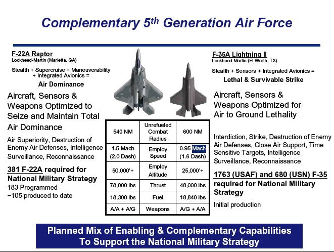

    And BTW. Mach 0.95 is NOT far from being as BAD as 1.1 in the case of F-35 33* swept wing either (F-16 is 40* sweep angle) since you can add a 0.05 M+ per 10* sweep as a thumb rule…
    The only real advantage would be the optimised supercritical wing profile draging less at this Mach than a laminary with the same sweep angle, NOT the case…
    http://i146.photobucket.com/albums/r279/sampaix/F-35-Misson-Profile.jpg
    Here F-35 typical ceilings and Machs as you can see it’s predicted at M 0.90 and 30.000 ft with optimum ceiling/cruise about 35.000 ft…

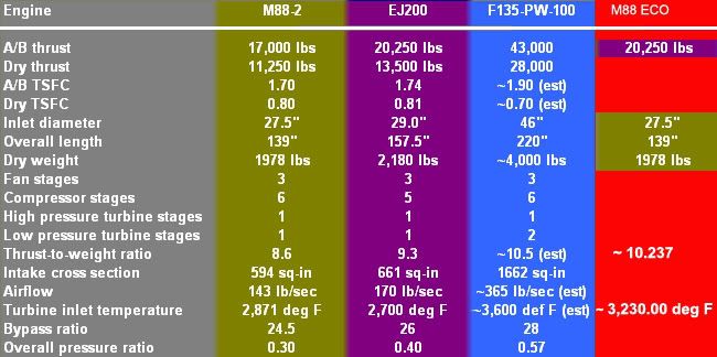

    =Spitfire9;1350486]Table does not show M88-ECO dry thrust. Has this been increased to get the engine closer to EJ200’s dry thrust-to-weight ratio? The M88-2 is inferior in that respect.
    We dont know this value today, as simple as that.
    The point i was trying to make was TET (Temperature Entry Turbine) and it is in the same ballpark as the latest US engines.
    IIRC Eurojet was asked to design an engine with potential for a 10% increase in thrust. If that has not been requested why would they be doing it?
    To keep up with the necessary technologies?
    But then again you are wrong they weren’t ASKED they were asked longer TBO and lower operating cost, at design stage they only were requiered to make it possible.

    Spitfire9
    I don’t understand your comment where you say “in Typhoon’s case”. Are you saying that RR involvement in the F-136 engine or F-35 lift fan diverted development funds from EJ200 development?
    Eurojet are WAY OFF SNECMA’s developement and production stage for M 88 upgrades, this also mean that funding have been limited.
    http://i146.photobucket.com/albums/r279/sampaix/Engines-corrected.jpg
    Just a clue, corrected with the latest demonstrated technology advances

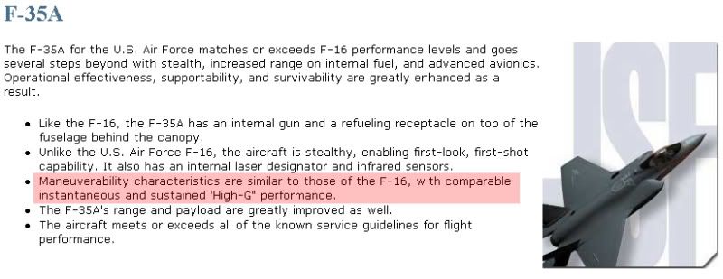

    As you can see, there is a discrepancy between USAF dreams and what they actually get
    Another Key Requirement from USAF was that F-35 will require less maintenance then F-16.
    Needless to say, L.M didn’t deliver on that one either….
    LOL! They didn’t deliver on Standard Max Structural Load, Max Gs,Turning Capabilties and so on but of course these guys knows what DESIGNED LIMITS means and these are NOT limits you see…:D
    Originally Posted by pfcem
    Quite simply, if the F-35 did/does not MEET OR EXCEED an OPERATIONAL top speed of Mach 1.6 it would not have been selected or be accepted.
    Well as FAR as everyone KNOWS it is NOT the case.
    NONE of these performances have been DEMONSTRATED to date, so please take the Mickey with a newbie will y’a?

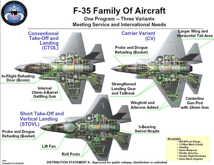

    Well in this case you WONT insist into making L-M own designed Mach LIMIT of 1.6 F-35 “KPP THRESHOLD”.
    http://i146.photobucket.com/albums/r279/sampaix/2006familyws5.jpg
    End of debate.:diablo:
    No. The JSF was the accumulation of a USAF F-16 replacement program, a USN F/A-18 replacement program AND a USMC/UK Harrier replacement program. ALL three programs had begun prior to accumulating into the JSF.
    http://i146.photobucket.com/albums/r279/sampaix/CRSReportforCongress-Requierements.jpg
    Old DoD documentation… = REALITY of the F-35 programme.
    http://i146.photobucket.com/albums/r279/sampaix/F-35-NASA-simlab.jpg
    JSF was FIRST “architectured” by USMC specialists and USAF only came SECOND to ADD internal weapons and supersonic DASH speed to EXISTING requierements including Harrier II+ Operational ceiling.
    Not JUST the strike role, ALL ROLES ALL AIRCRAFT IT WILL REPLACE PERFORM!

    No, a simple way of describing what the JSF is EXPECTED to be.
    I know what it WAS EXPECTED to be before the technico-commercial B-S you feed yourself with took over reality; YOU make up a different set of requierements and specs.
    WITH AIR-TO-AIR LETHALITY SUPERIOR TO THE F-16 & F/A-18!

    Requiered Specs and design features which are expressed in KPP THRESHOLDS & similar such MINIMUM goals/requiremnets, not MAXIMUMS.
    Requiered specs NEVER were for M 1.6, BOY.
    Mach LIMIT isn’t a KPP but a designed LIMIT EVEN in English.
    Back to basic training and studies for YOU and the other revisionists.
