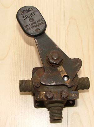

    in reply to: JB117 Lancaster Wreckage, Any help? #886643
    Lucky_Larry
    Larry,
    That first item is part of the supercharger casing just beneath the supercharger impellor on the rear of the engine.
    The third item is the Auto controls Bombsight MK1 c**k from the bombaimers position on the port side.
    http://spitfirespares.co.uk/Website%20products%2029/lanc%20bomb%20cock.jpg
    Oh Excellent! That’s fantastic Peter, thanks! That’s certainly the piece, no mistaking it!
