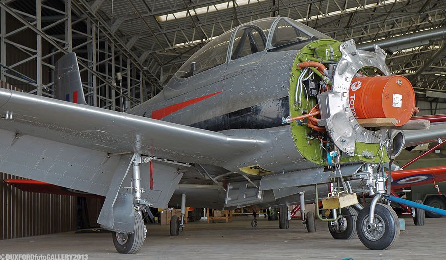

    Single cylinder Total ‘Go Faster’ Oil Barrel. 😀
    http://i5.photobucket.com/albums/y200/penpusher/09%20Duxford%202013/05%20Bimble/42.jpg
    Brian
    It’s being converted to battery powered to appease the greenies…. 😀
    It’s now nice and low on emissions and noise.
